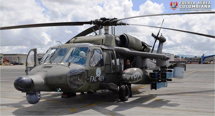

By the way. AH-60 is not a US Military designation. The US Military calls them MH-60s for multi-mission aircraft used by Special Ops.
The only aircraft called AH-60s I know of are used by Columbia and they are 4-hardpoint gunships called Arpias by the Columbian military.
