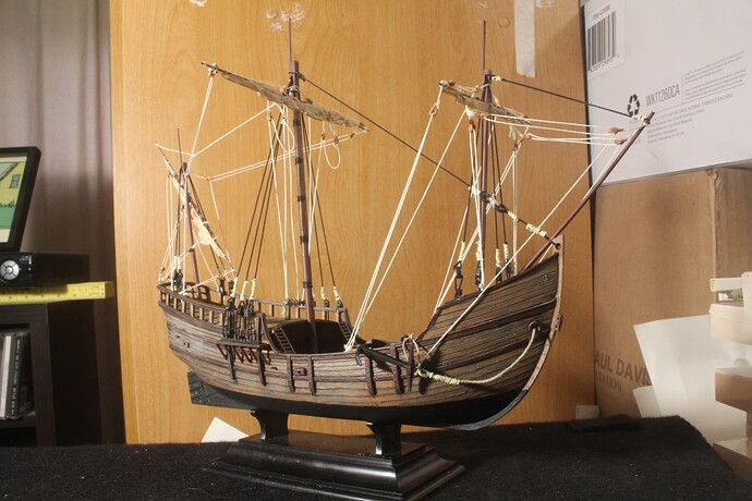

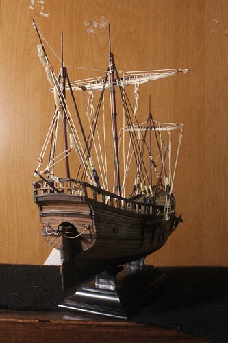

Been working on this one for the past month. Heller claims the model is 1/75, which is ridiculous when you put a 1/72 scale figure on the deck - the railings come up to his knees, he would have to crawl to get between the decks, and he would barely fit in the lifeboat. A 1/87 scale (HO) figure is barely more credible, which leads me to believe the model is much closer to 1/100. The plastic kit only took a few days to finish, but the rigging took almost a month. Pics:
I have to admit it’s a little rough in places :disappointed:
Likes, dislikes, opinions?

Biggles, she looks splendid! You must sail because your rigging looks years ahead of what I did with mine. Did you use the thread that came with the kit?

Thanks. I didn’t use any thread from the kit, but I did use some scale rope from Ropes of Scale and some sewing thread. I found that keeping all the thread as close as possible to 100% cotton, you can tighten up any slackness by saturating the thread with water, after installing the rigging, as the thread will shrink. I also replaced the kit yards with brass rod so they wouldn’t flex under tension. I didn’t follow the rigging scheme from the instructions, but found a couple of diagrams on the internet.

Impresssive looking build Biggles, the rigging looks excellent, as does the finishing.
Great job.

Biggles, you did a great job on this "vintage"kit. Your woodwork on the hull,deck, & other features look very realistic and weathered. I’m currently working on Revell’s Pinta kit and it looks very similar to your Heller kit. Revell says that their kit is in 1/92 scale. Do you have plans to build the other two of Columbus’s ships.

I believe Revell’s ships are the same molds as Heller’s, although Hellers may be of better quality. I’ve been looking into the availability of the other two ships, now that I’ve built the Pinta. They’re available, but at some totally insane shipping charges. Heller claims 1/75, and Revell claims 1/92. They’ve also been marketed under the Aurora label, Humbrol, and probably others, at various similar scales. I think they’re closer to 1/100.

Magnificent.

Hi Leo, I like your Pinta a lot! I built the tiny Pyro version some time ago, but the Heller kit is larger and considerably nicer - and you have made the most of it!
That looks fantastic. Very well done.
