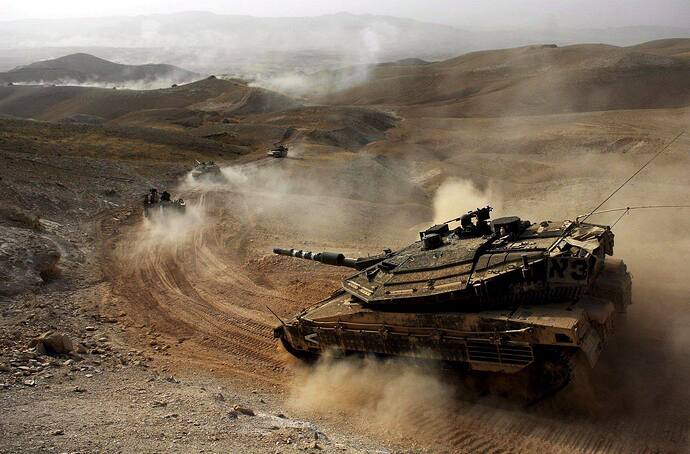

great images, Nikos. ![]()
It’s plywood tied on with wire.
The vinyl ones are either buckled on with straps or held on with zip ties depends on their condition since they do get ripped off every now and then.
Good to know, thank you. No standard size then.
From the photos, I see that there is a tube-like device on the rear-left part of the turret roof, longitudinal, that is completely missing in the kit. What is this thing? Is it likely that was missing when early Merkava Mk 4 entered in service?
It is missing in the kit because Academy has used the Lantrun museum display vehicle as a base for their kit. There are photos showing it missing sometimes but mostly it is there.

Photo of a 4M, still the same thing
it is missing in this photo, you can see the mounting points though
