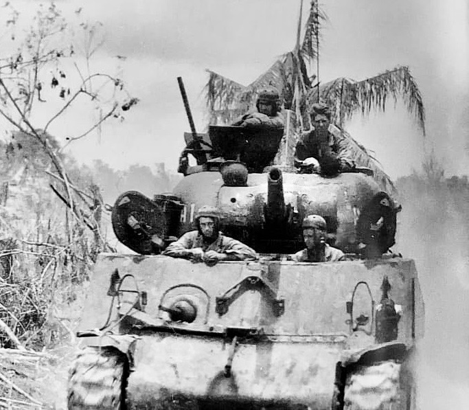

Now do you have any picture of late A2 in the Pacific? Is this an A2
I am pretty sure those are a3s judging by those vertical metal bits on the deck.
Thanks for the good will though
Yes A3 note the engine door rests

Yes, but that is a earlier tank with direct vision ports. I was looking for late variants.
Do you see in my original picture the engine door rest? I see only some shadows.

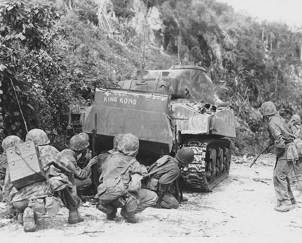

What about this one ?
If you mean Doris, No. 53, that’s an M4A3 as well. You can just make out the engine door rest, plus the waterproofing over the grilles is the full width of the engine deck, which is only necessary for the M4A3.

I agree A3, David Harper’s Iwo book has a few photos of her. She is part of D Co, 4th Tank Batt. She had wire mesh across rear deck.
For Iwo Jima campaign 4th and 5th Tank Battalion had M4A3s, only 3rd Tank Batt had M4A2s. As I recall this allowed only after the Commandant approved it. The supply chain had changed and after the Marines were not allowed to have A2’s even if that is what they preferred. More details in Ed Oscars books Tank Battles in the Pacific.
