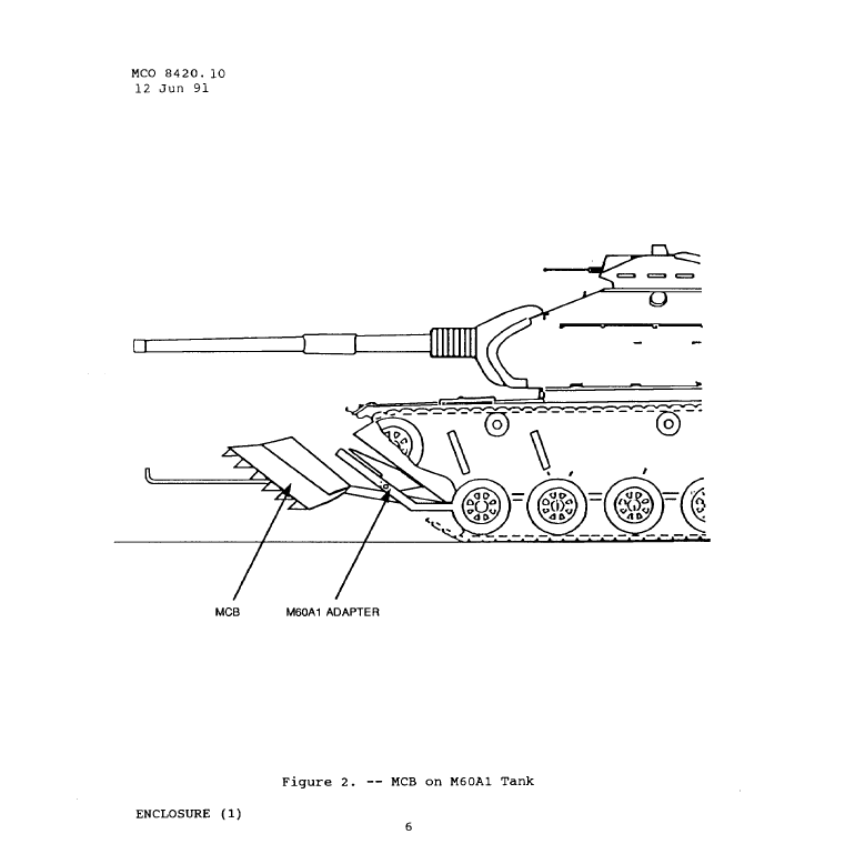

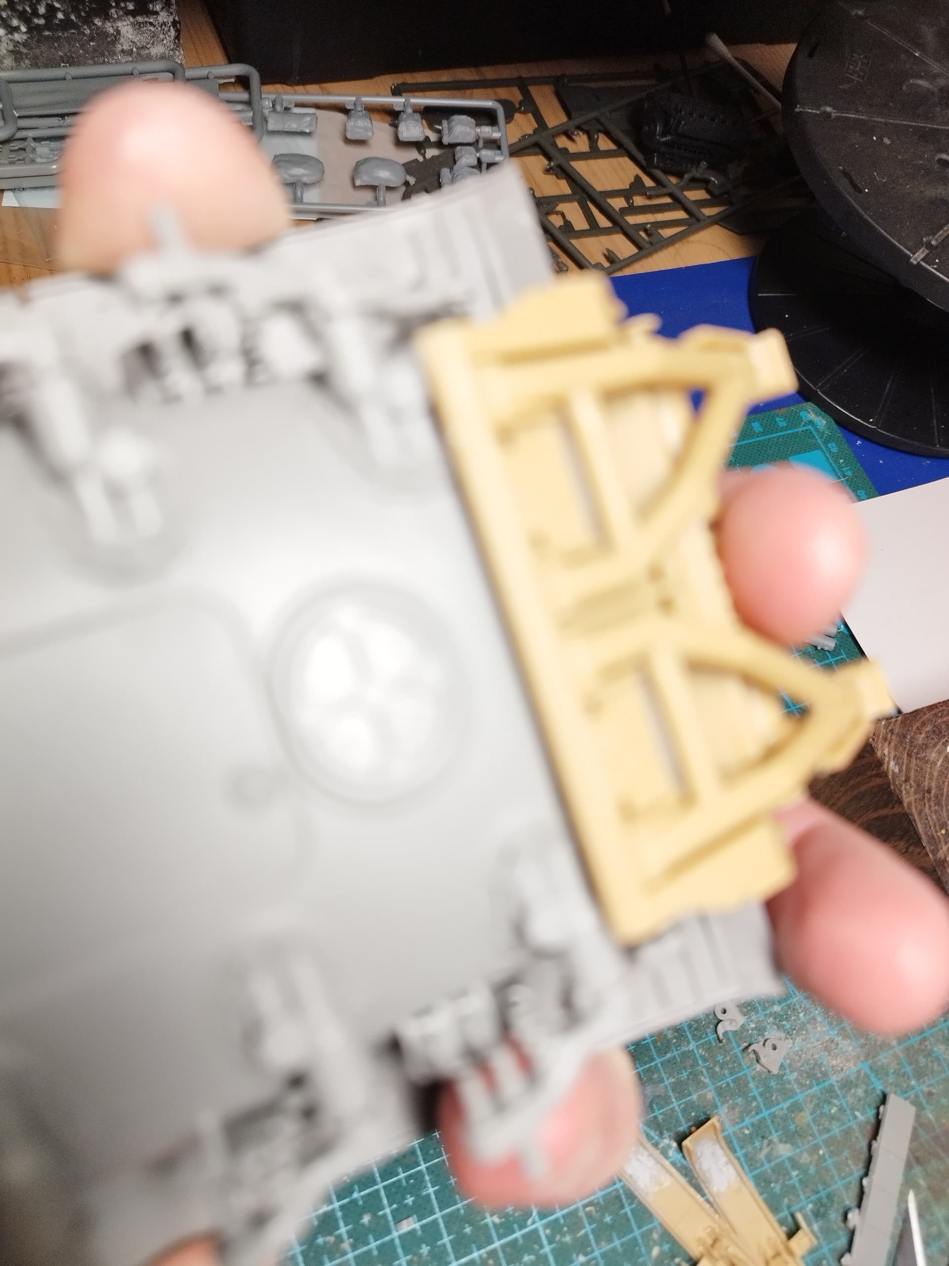

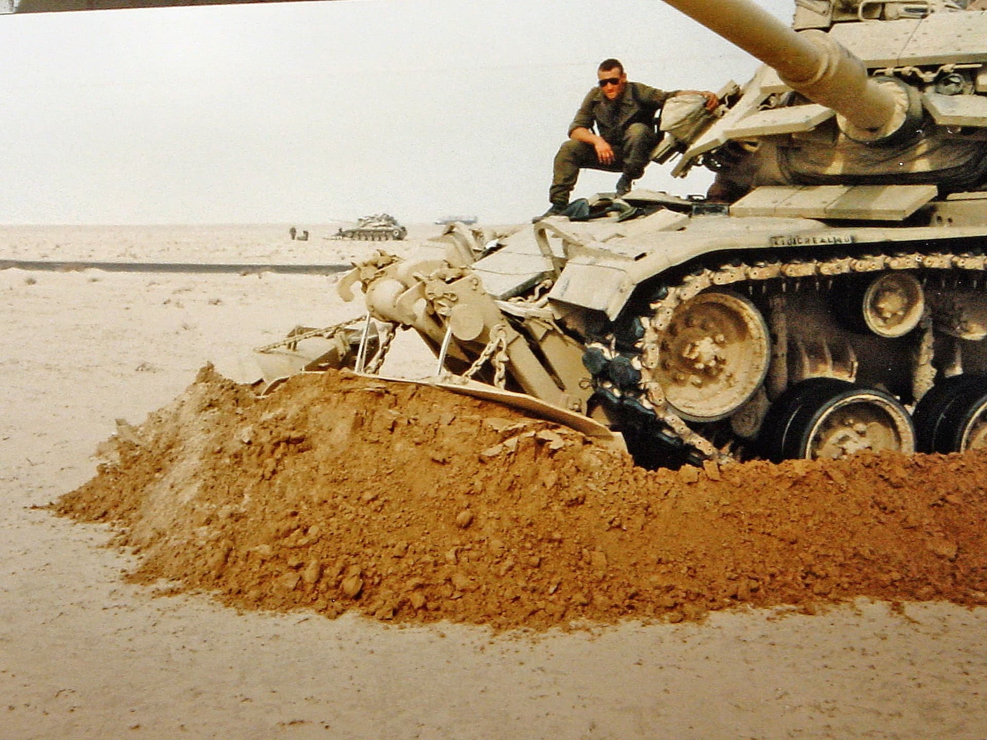

Yup; hope your handy with a saw. I just glued mine in place and hoped for the best. :smiley:
Well, this is really helpful, and it do show, how it was mounted to the hull.
Thank you very much :blush::+1:
I actually think, that the one I have, is the Trumpeter one :thinking:
The plastic in your photo looks like a Trumpeter

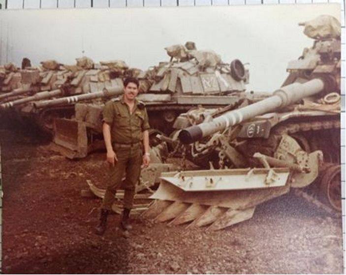

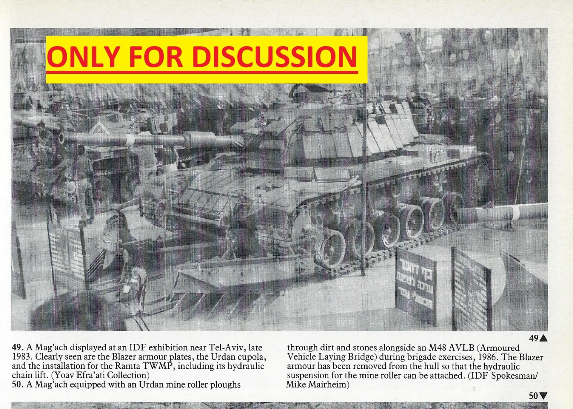

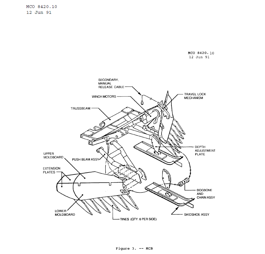

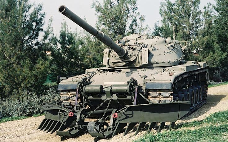

I am curious to see how the main Truss is fitted on the M60 hull.

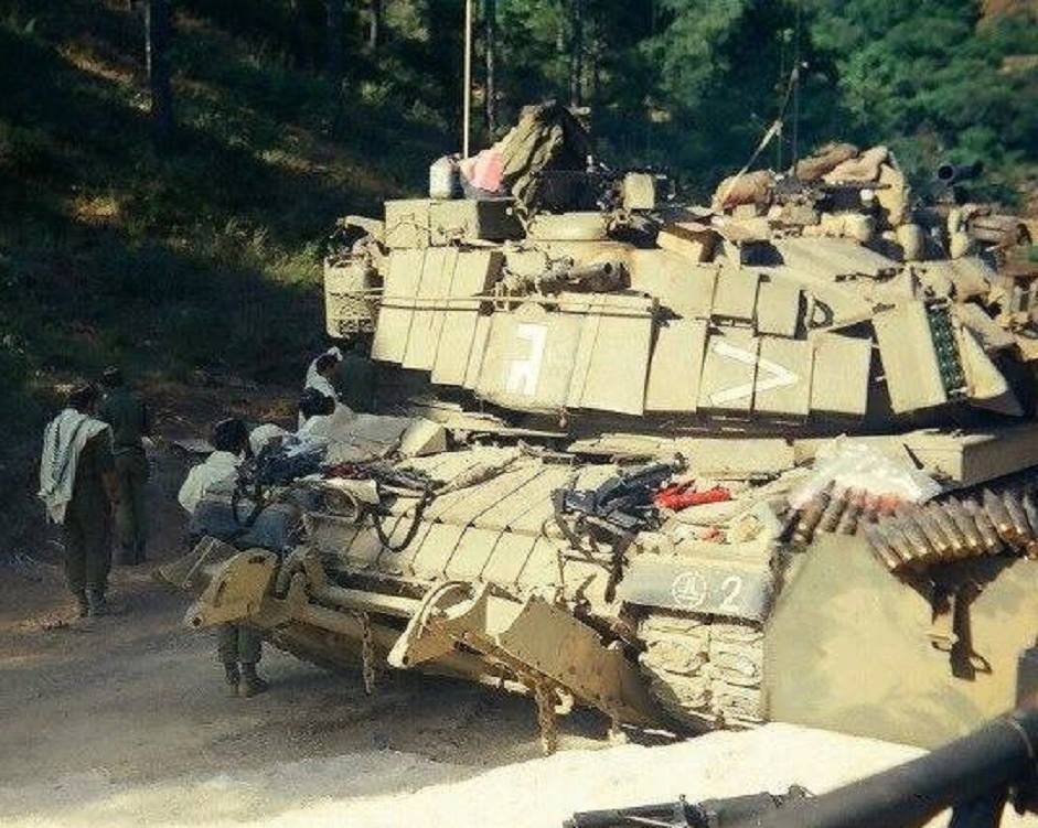

The IDF used a different mount to the US one.
Yeah; well, i mean the frame where the plow mounts into. I know that Elta Systems (israel) makes the TWMP typically used on the M60 and M1, along with other tanks. Thge new-Gen mine plow you see on the M1150 and on the Trojan is made by Pearson Engineering (UK).

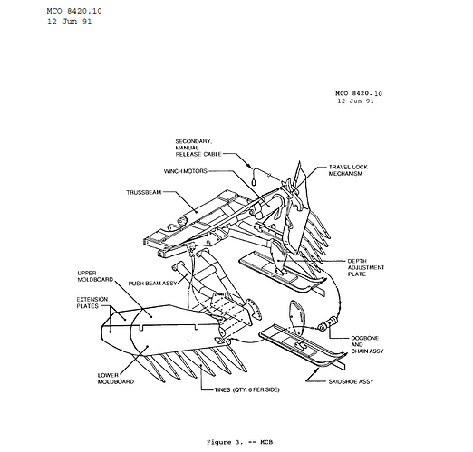

No, there is a frame

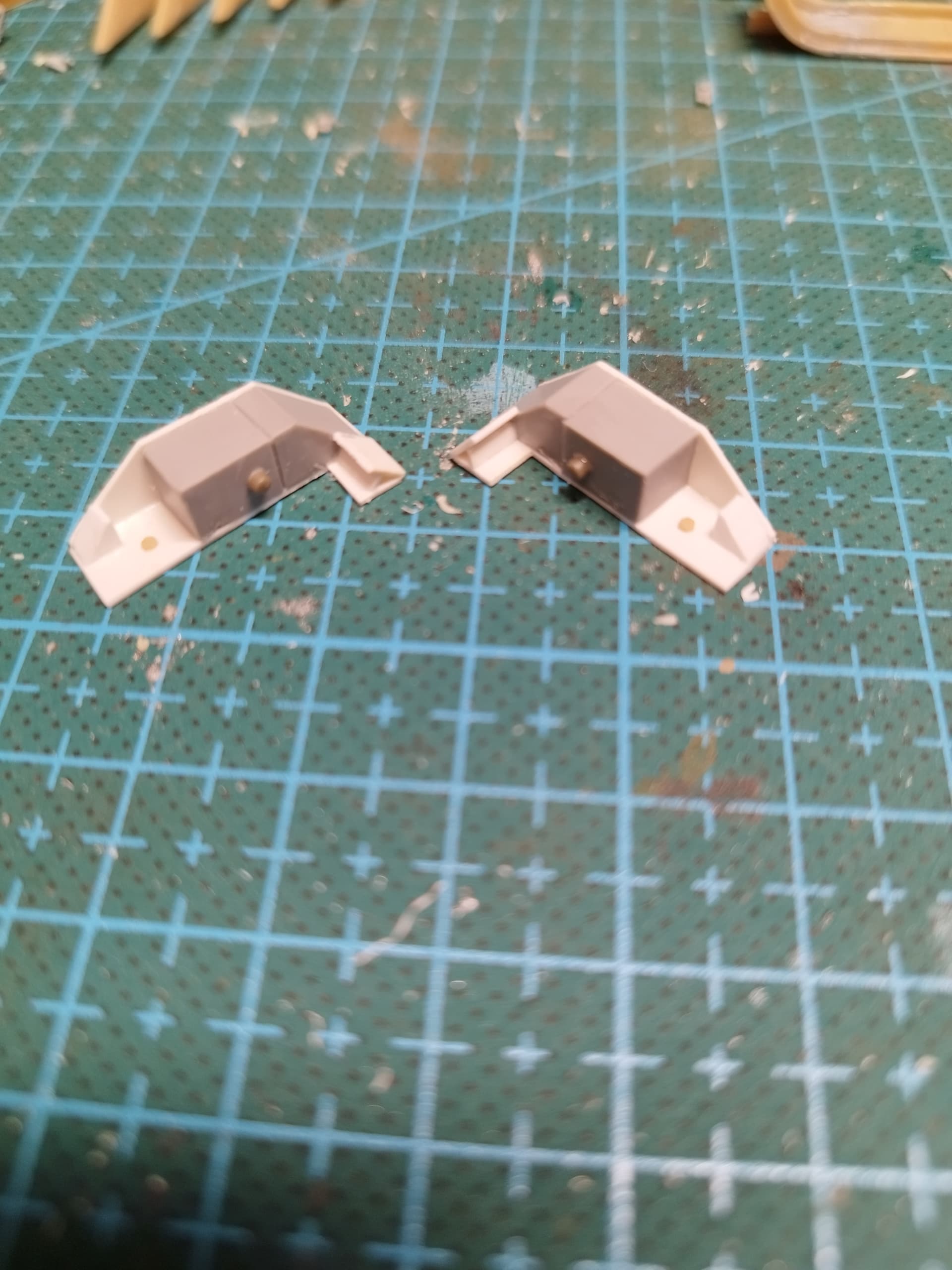

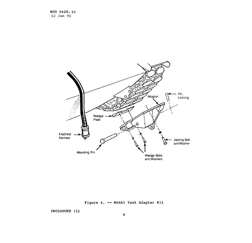

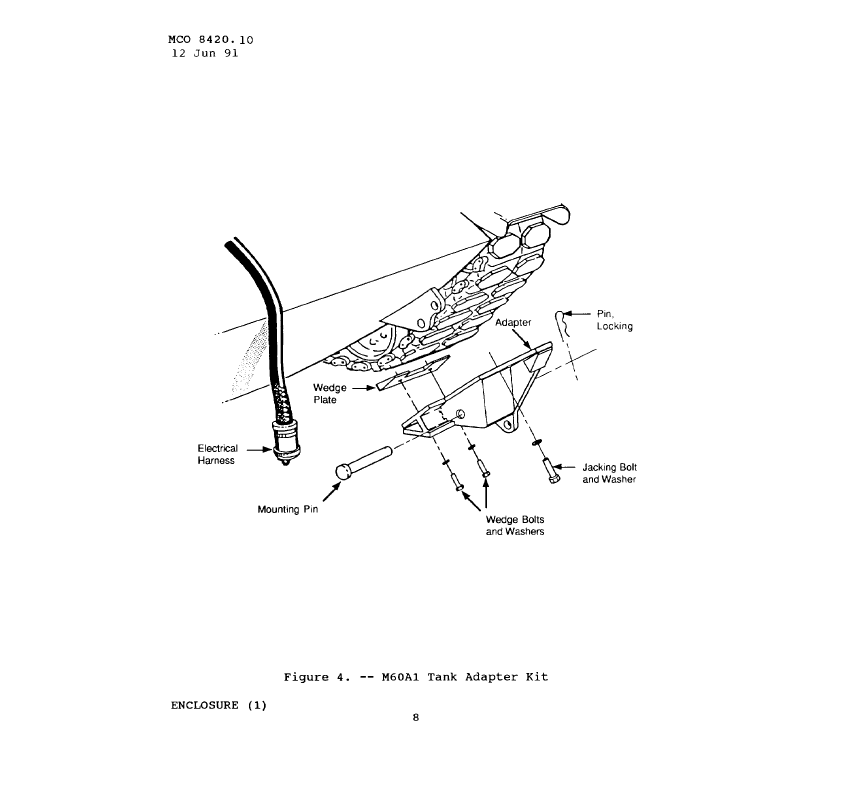

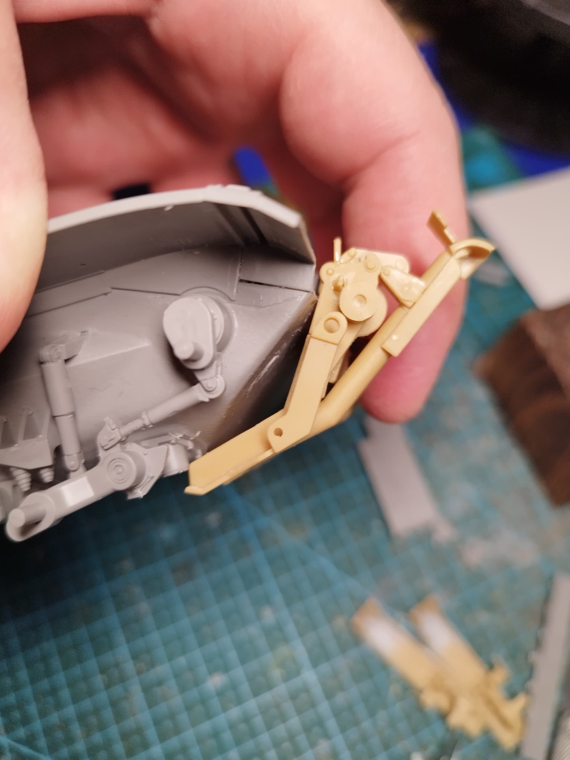

AHA! I think the fitting problem lays in the M60 adaptors between the hull and the mounting plate of the plough, which are shown in the last drawing. I’ll be looking into this tomorrow.
TA-DAA!
Hopefully these will do the trick.
Not a 100% look alike, but close enough, since they’re gonna be tucked away behind the mounting plate.
