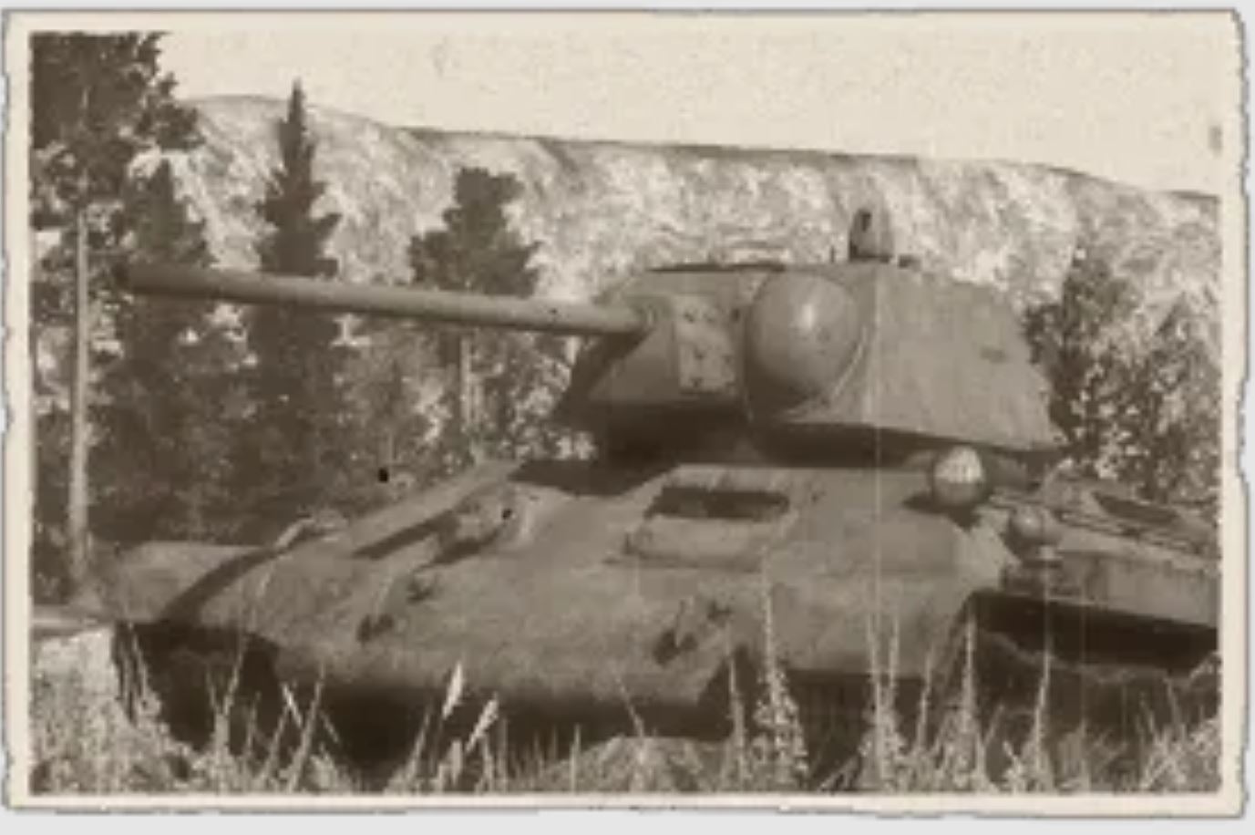

Since there are no surviving examples of these tanks, a walkaround was obviously unavailable on primeportal. I instead turned to War Thunder, a game I’ve been playing for quite some time. Handily, the Russian tech tree has both the 1942 AND the 1943 variants of the T-34-57. Between reference photos and the War Thunder model, it appears to have the early 1943 angular fuel tanks, the early 1943 “Mickey Mouse” turret, but the late 1943 2 rubber, 3 cast road wheel tyre arrangement. Now, the Tamiya kit provides parts to completely recreate the photos/WT model, but for some reason I’ve been dead set on building this model with a cupola. Any recommendations? Also, these are the cannon barrels I’ve been looking at, I’m not sure which one would be best.

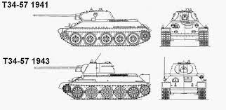

One does exist, not sure which year this one is as am not very knowledgeable on T-34’s.
Very rare but they were around only in 1941.
A good build-
https://www.recomonkey.com/Land-Platforms/Tanks/T-34/T-34-57
EDIT : the one above is a replica… :smirk:
…Contrary to this one (1941 model)
1943 model
I think the last image is an old War Thunder stat card…

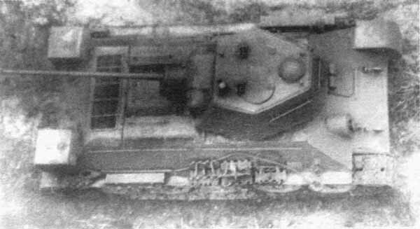

The main problem with searching for you is that you are not searching in Cyrillic.
Here are some links to materials on this tank with text and photos,
https://dzen.ru/a/W5qdlyhb1ACpgFUW?ysclid=m7ys8xvk2f668697721
https://pikabu.ru/story/pole_boya_t3457__redkiy_tank_kotoryiy_spas_stalina_i_mog_borotsya_s_tigrami__4666680?ysclid=m7ys91gvga148800219
Here is a selection of search photos in the Russian segment of the Internet.
