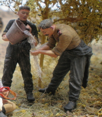

What Karl said. Here’s a not perfect but fair example – mid-grey base, blackish wash to settle in folds, dry-brush the fold/crease peaks with a grey lighter than the base…

Turned out great on a 70mm SAS figure.
