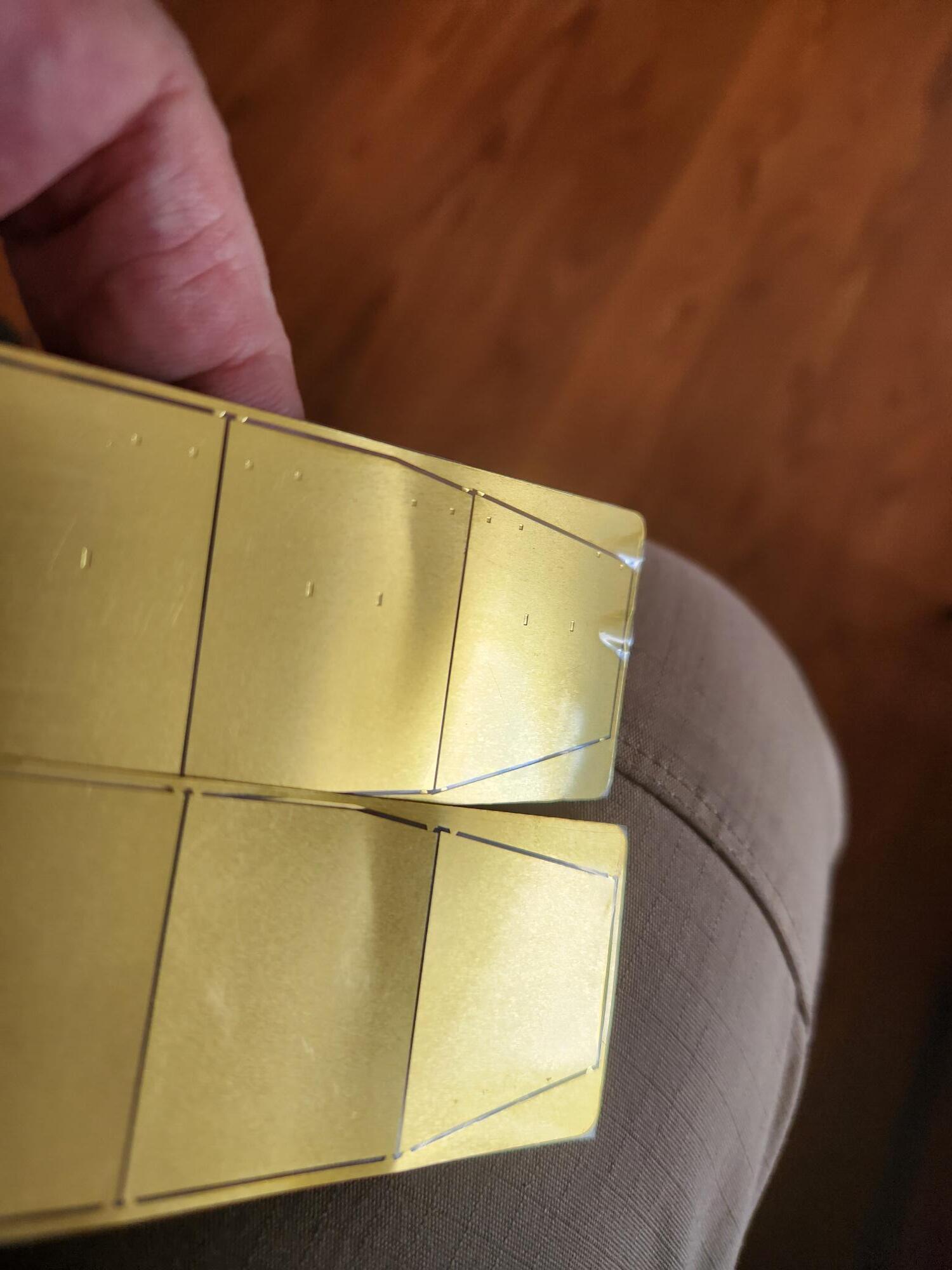

Help with dented PE
I received a set of Border side shields for a Pzkfw IV. They were stacked together and were dented in shipping.
How to take the dent out? There is no sharp crease or fold.
Will putting it in the oven and aneling it, let the brass relax?
Annealing will indeed soften the brass but it will not take out the dents.
I would anneal, place the brass on a hard surface, visible side in photo facing
the hard surface, and then push the dent down with a finger nail.

What were the real skirts made of? I know they were thin, but any sort of hardened armour won’t bend like that. It might do so around the edges of a high-energy impact, but not from the tank running into an obstacle. If however they were just soft steel then denting is OK if the bend doesn’t come out! Go with Robin’s suggestion and try to press it out again.

As suggested above, I’d start by annealing the parts and then press and burnish the dents / wrinkles out. I’d probably use a piece of glass (that I also use a cutting surface) to get the parts flat again. This might take alternate burnishing on both sides and perhaps also using a piece of printer paper on the glass to provide just a very slight amount of “crush” to the surface. However, hard and flat is needed to restore or create flat. As a burnishing tool, I’d probably try a flat piece of wood (like a crafting stick or tongue depressor) or a thick piece of styrene sheet.
