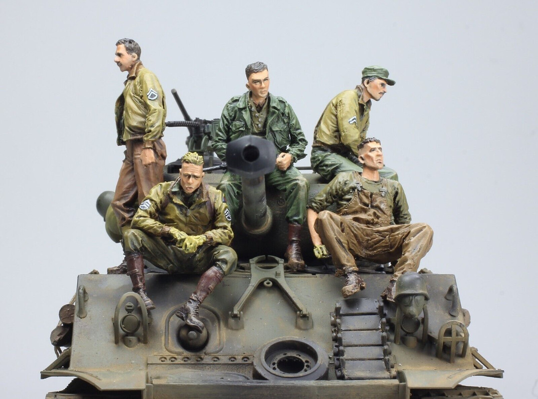

I’m having a real hard time trying to match the various colors from both shots,everyones wearing something different,colors look different any help on paint matches,thanks
Start with your basic olive green, olive drab, and khaki, then go from there. You can alter the base colors for each uniform item to make them appear slightly different.

Most of the uniforms are OD3 khaki in different shades; their tanker jackets are a bit brighter, so Tamiya Dark Yellow could work if you moderate it. “Machine” is wearing an M43 HBT uniform, which will be in OD7 Olive drab with a brown high neck sweater. “Gordo” is also wearing a reversible, HBT herringbone fabric, frogsking pattern camouflage uniform jacket, which was a bit of a rarity in the ETO, but some units did wear them in-theater.

A good brown, green, or sepia wash will blend, mute, and darken everything. Vallejo makes excellent acrylic washes. Just be sure not to be too heavy with the wash.
Then you can lightly drybrush to bring out the clothing wrinkle tops.
