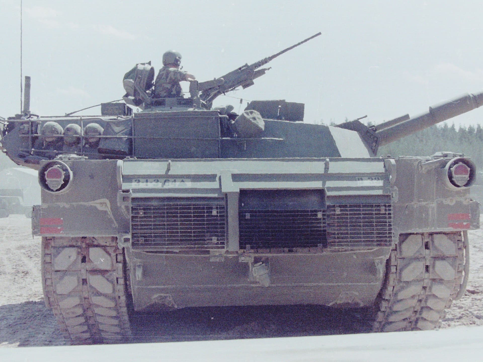

Better shot on other side you’ll see a water can.

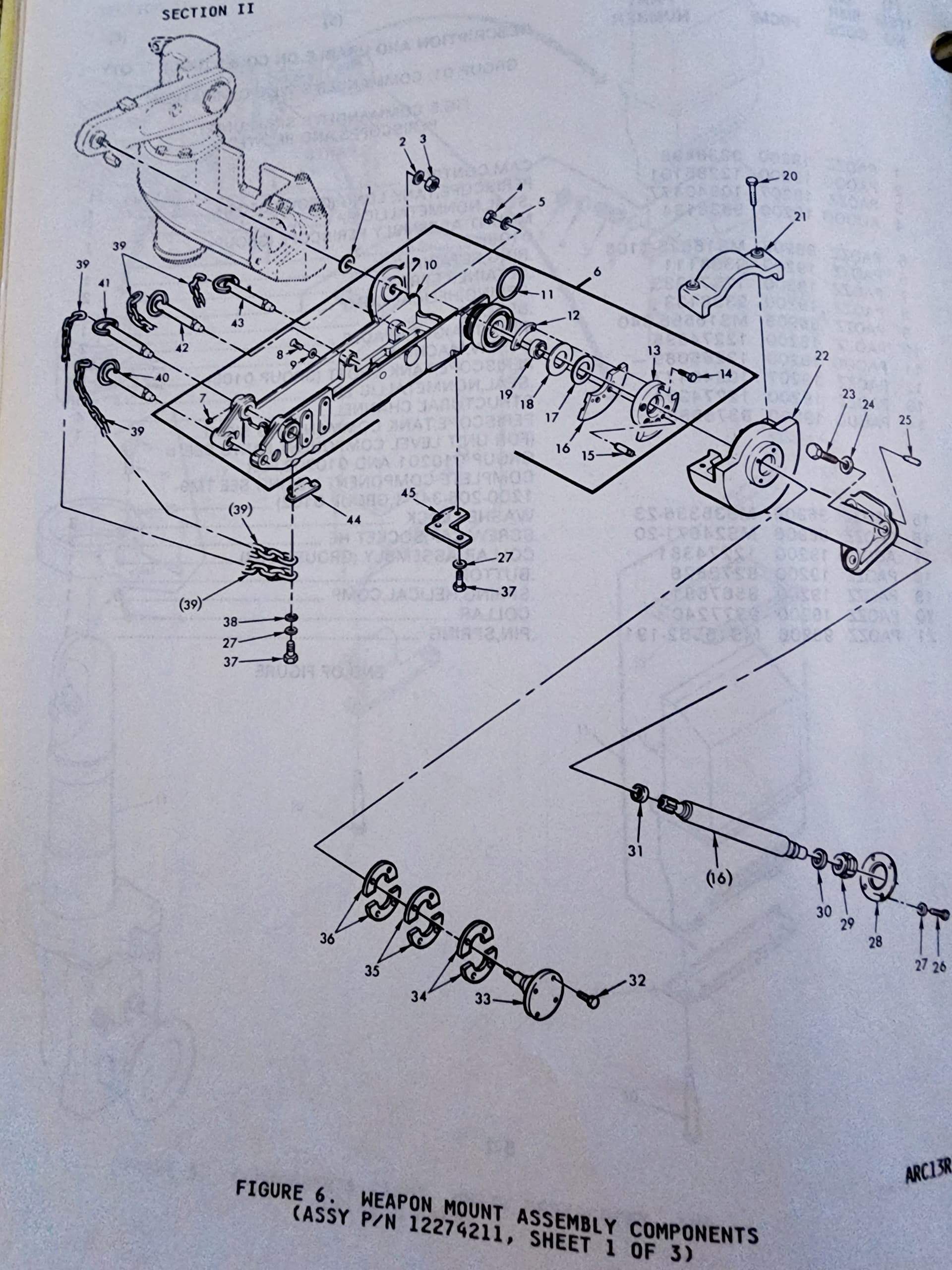

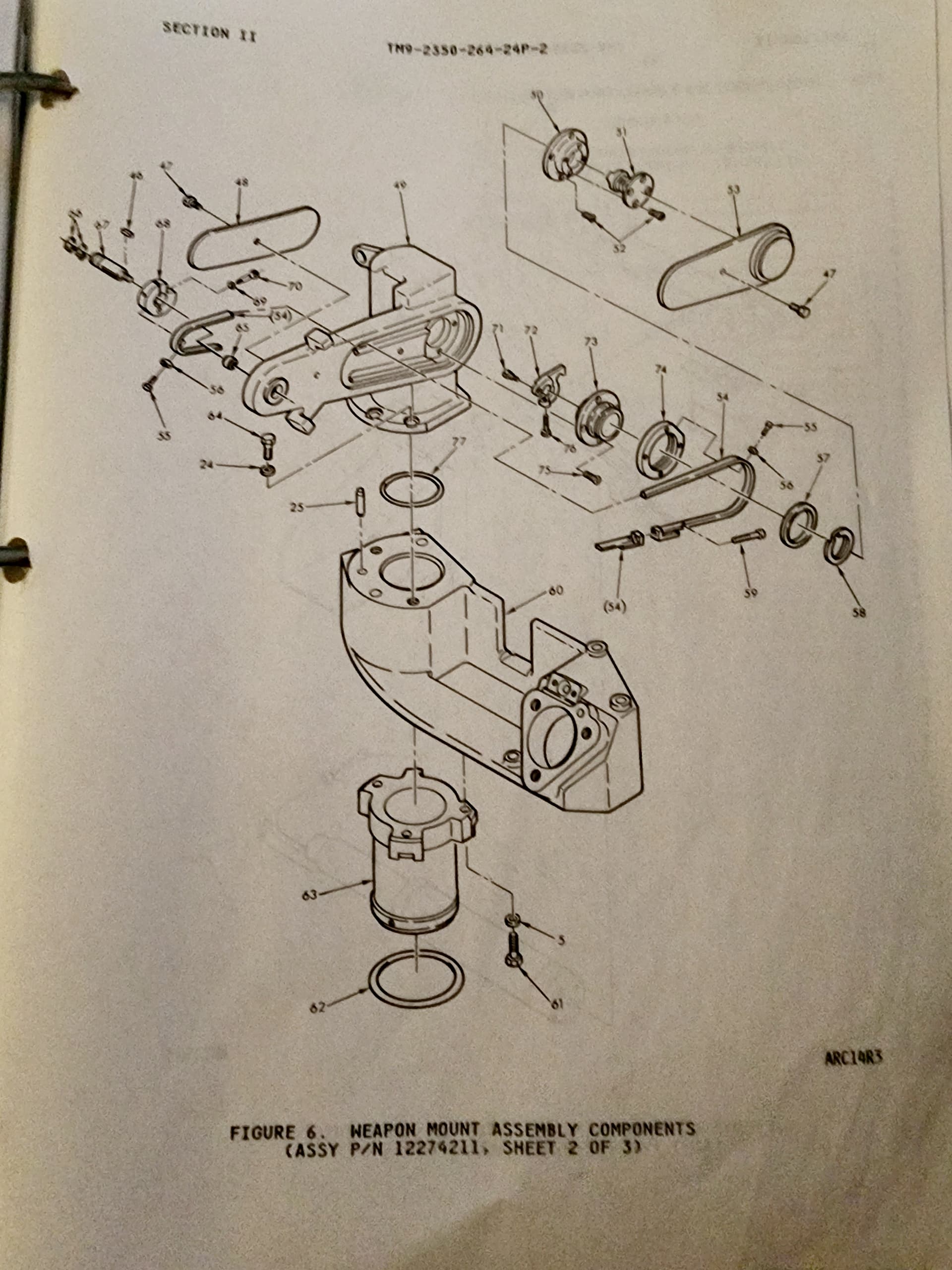

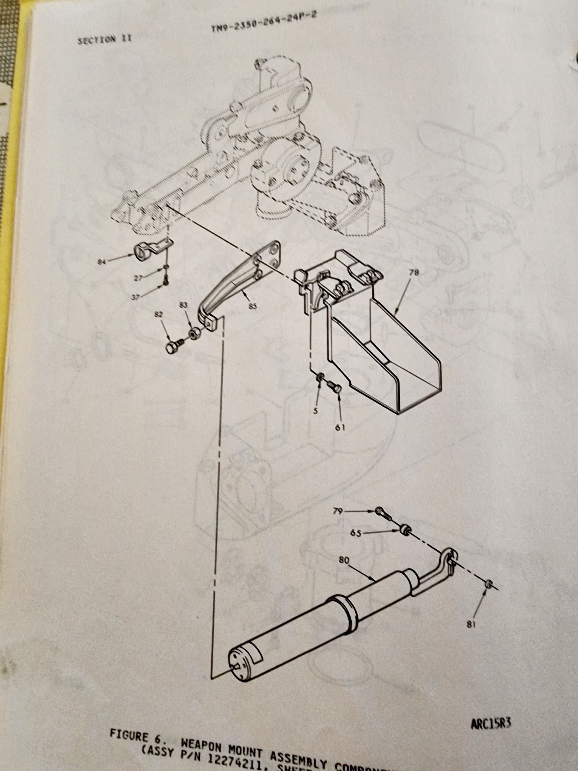

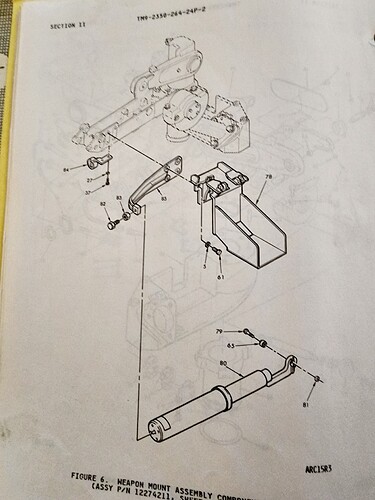

More detail of .50 Cal mount if needed.
Great pics of .50 cal.Always hard to see where the cables/Wires attach to.

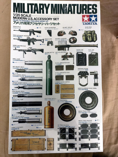

Since there is no bracket on that side on the real vehicle you can just source a watercan fron the early Tamiya accessories set.
This set will also give extra kevlar helmets, ruck sacks, other goodies.

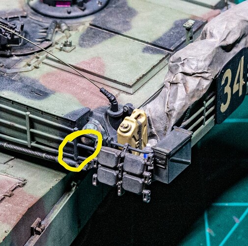

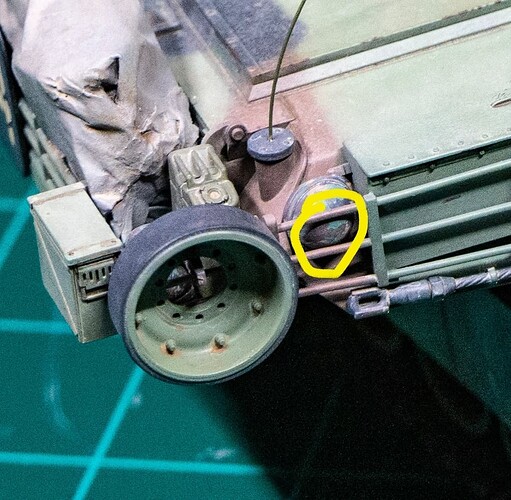

Just like our M1A1s we mounted spare track and a road wheel on the left and right side of the turret bustle. Since the straight M1s didn’t have a rear bustle rack they will have to be mounted where I marked with yellow.

About the oil/water cans: if you look at the photos posted above, on the left (loaders) side of the turret is a can with a mount, on the right (TC) side there is no mount, however, a can is often stowed there, as in the photo.
