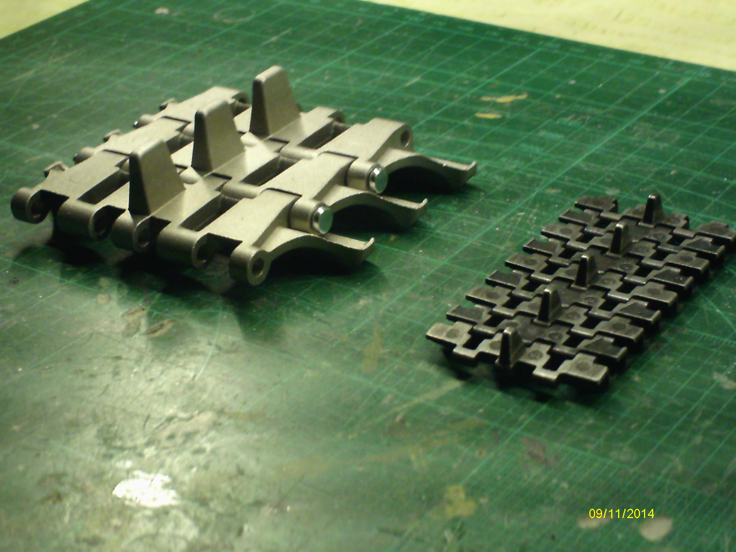

With regard to Amortek, I only have 3 Centurion track links, which are for a research project, in comparison to 1/16th Ferdinand tracks for my Ludwig Centurion -
Mal
