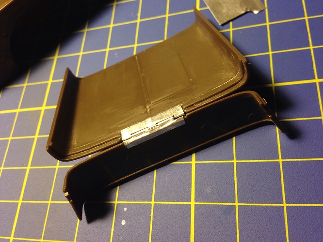

S.E. Charles,
Here is something that may help…have a look:
excellent step x step ; thank you
oh; that photo is very helpful - thanks.
