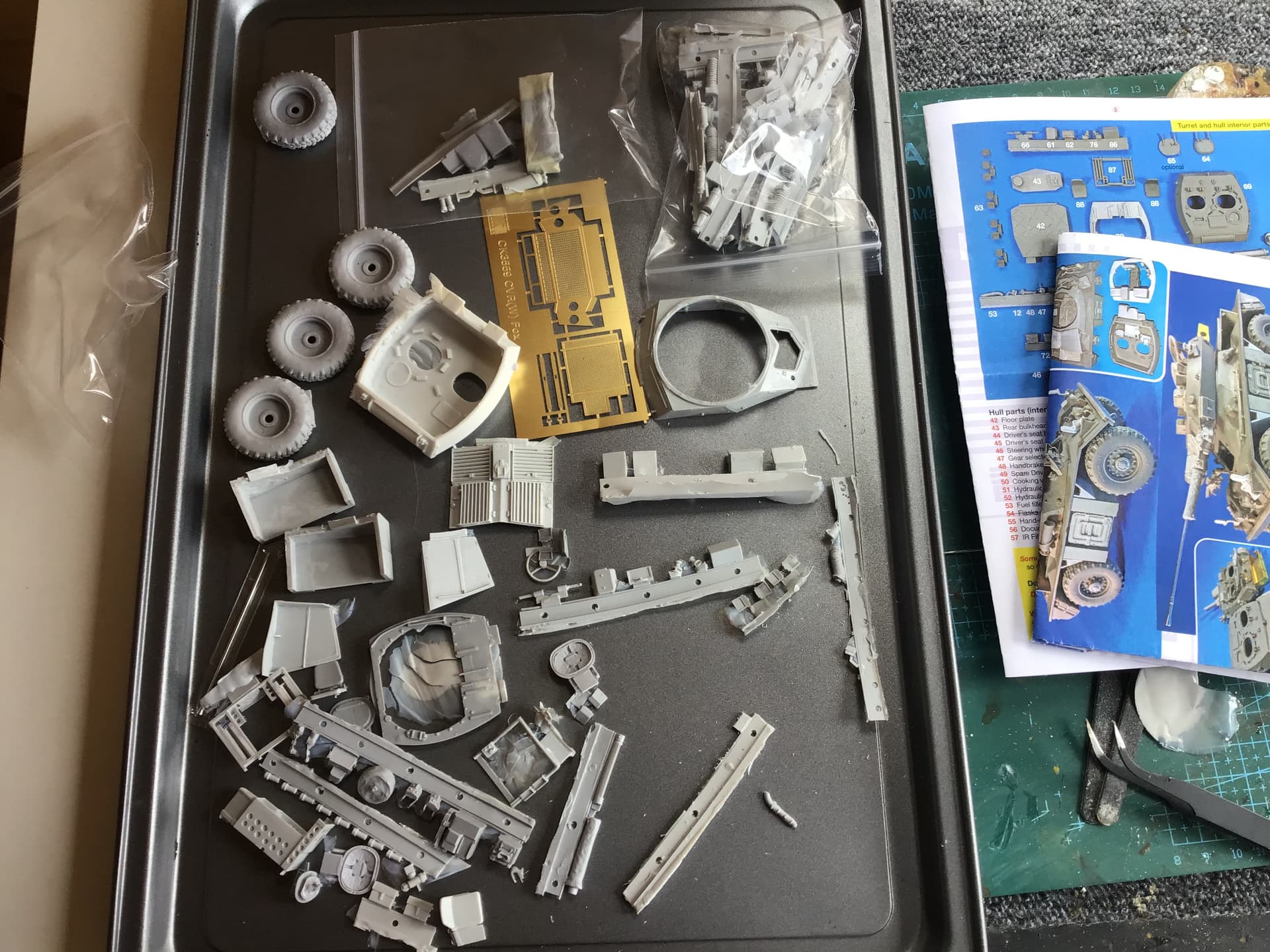

After the very nice post lady delivered this I thought it would be rude not to start it😀
The parts are cast in a very nice soft resin so they not too brittle,

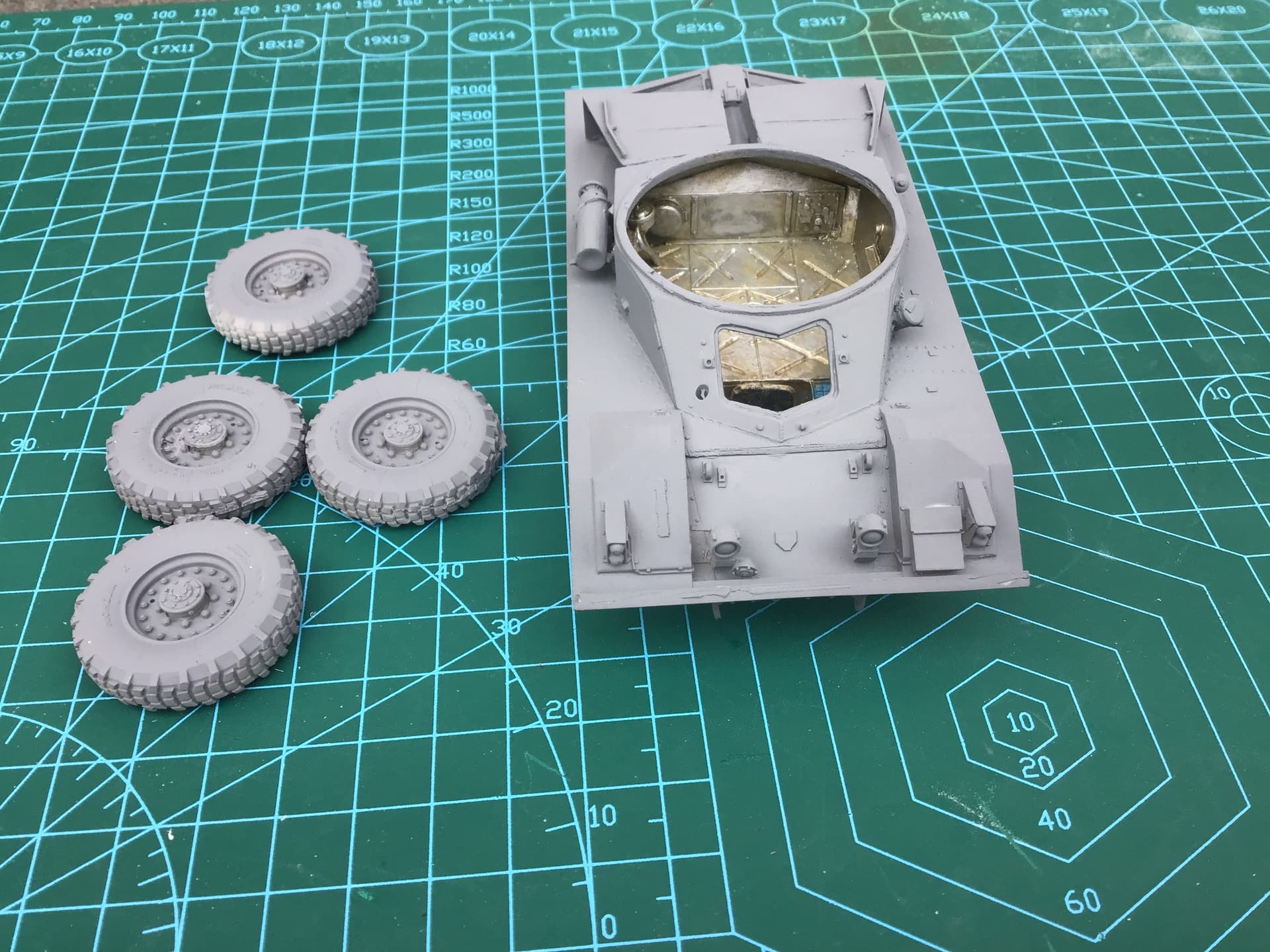

Just an hour in and the lower interior is ready for some primer,I’ve used bostic gel for this and it gives just enough time to position the parts before it goes off.
Off to the shed to give it a coat👍

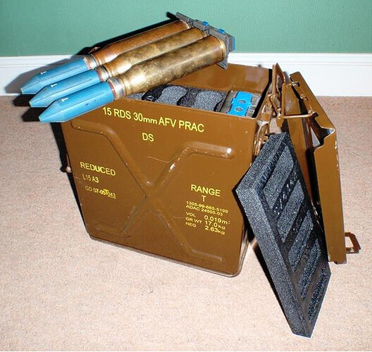

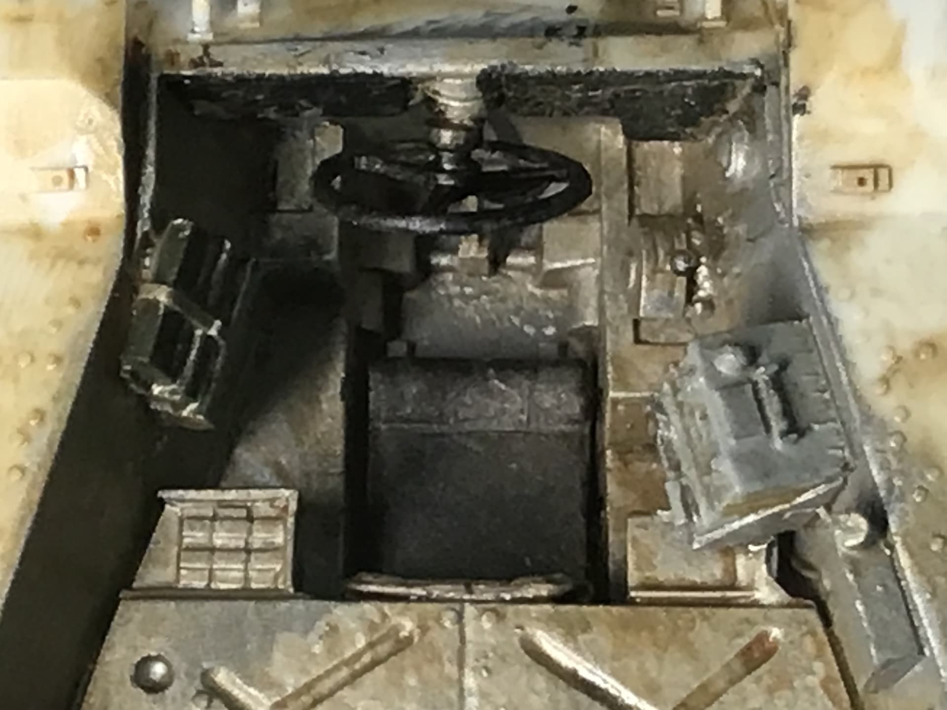

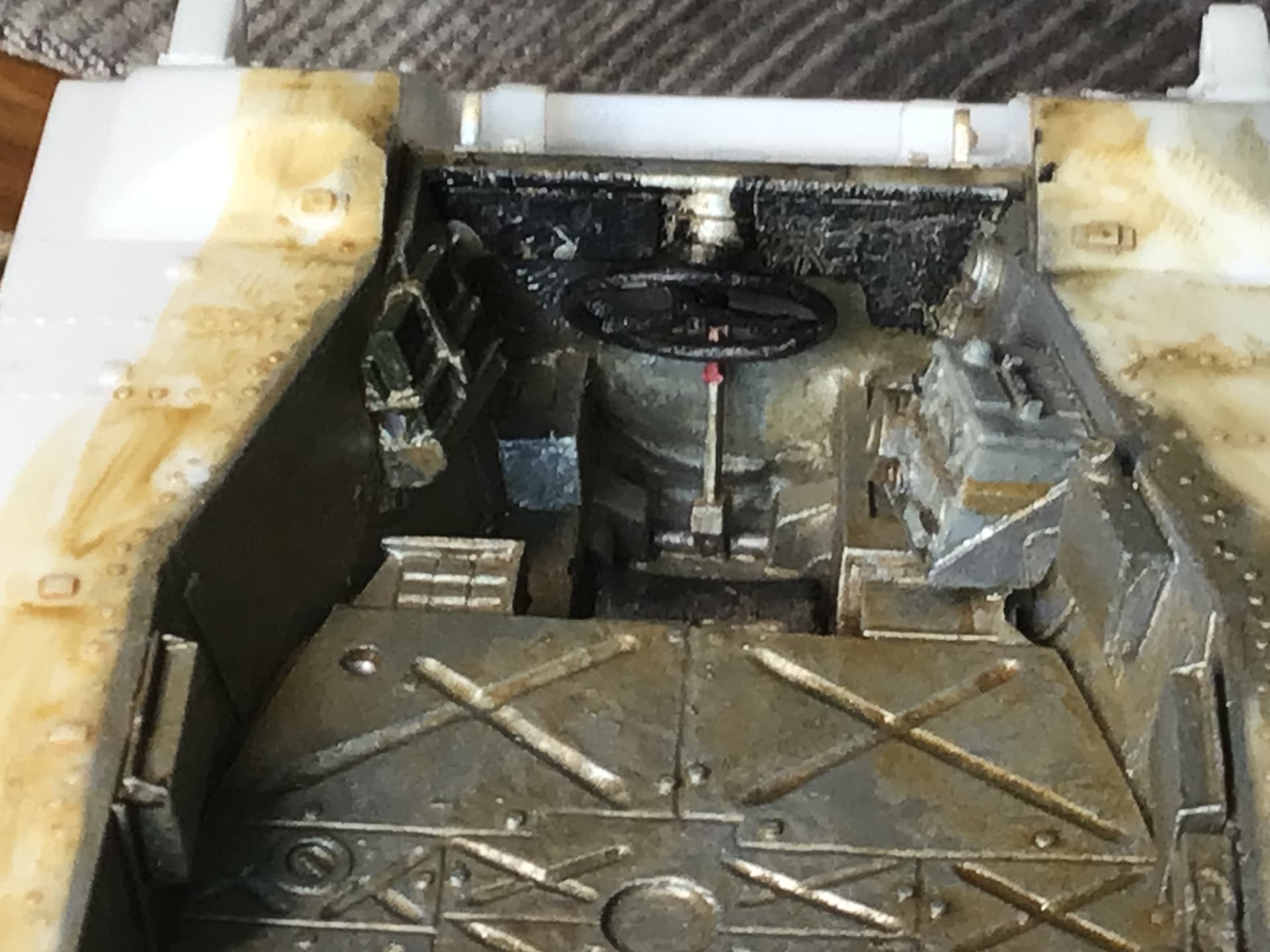

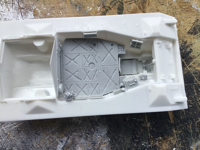

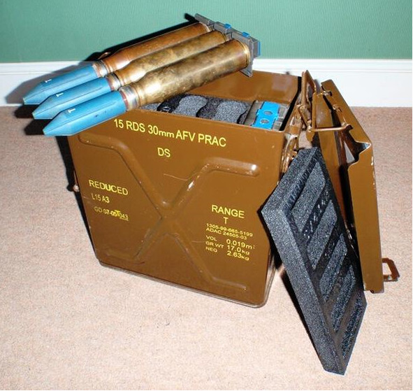

A bit of an update,drivers pit done and dirtied up a bit. There is a bin with Rarden 3 round clips anybody tell me what colour the bottom of the clips is?
That’s it for now it’s going together very well and no problems so far😀

Brass rounds with a black clip/ load handle, covering 3 rounds,
As Frank said above, but I think there was a blue plate on the bottom of the garb handle on the clip … Max @Maximus8425 might remember better as I didnt spend much time on 30mm.
The ammunition nature will decide what colour the base clip plastic is. APDS (Armour Piercing Discarding Sabot) will be black as it’s armour defeating, HE will be yellow due to it having a high explosive content and DS Prac (Discarding Sabot Practice) is blue due to it being a training round. They all match the colour of the projectile.
This pic shows DS Prac and you can just see the base clip plastic in the box. The plastic also has holes in it so you can recognise the ammunition nature by feel in the dark. Off the top of my head APDS has no holes or possibly one, HE has two and DS Prac three, but I’ll check that and update if needs be. If i was building it they would be yellow just as a contrast, but that’s me.

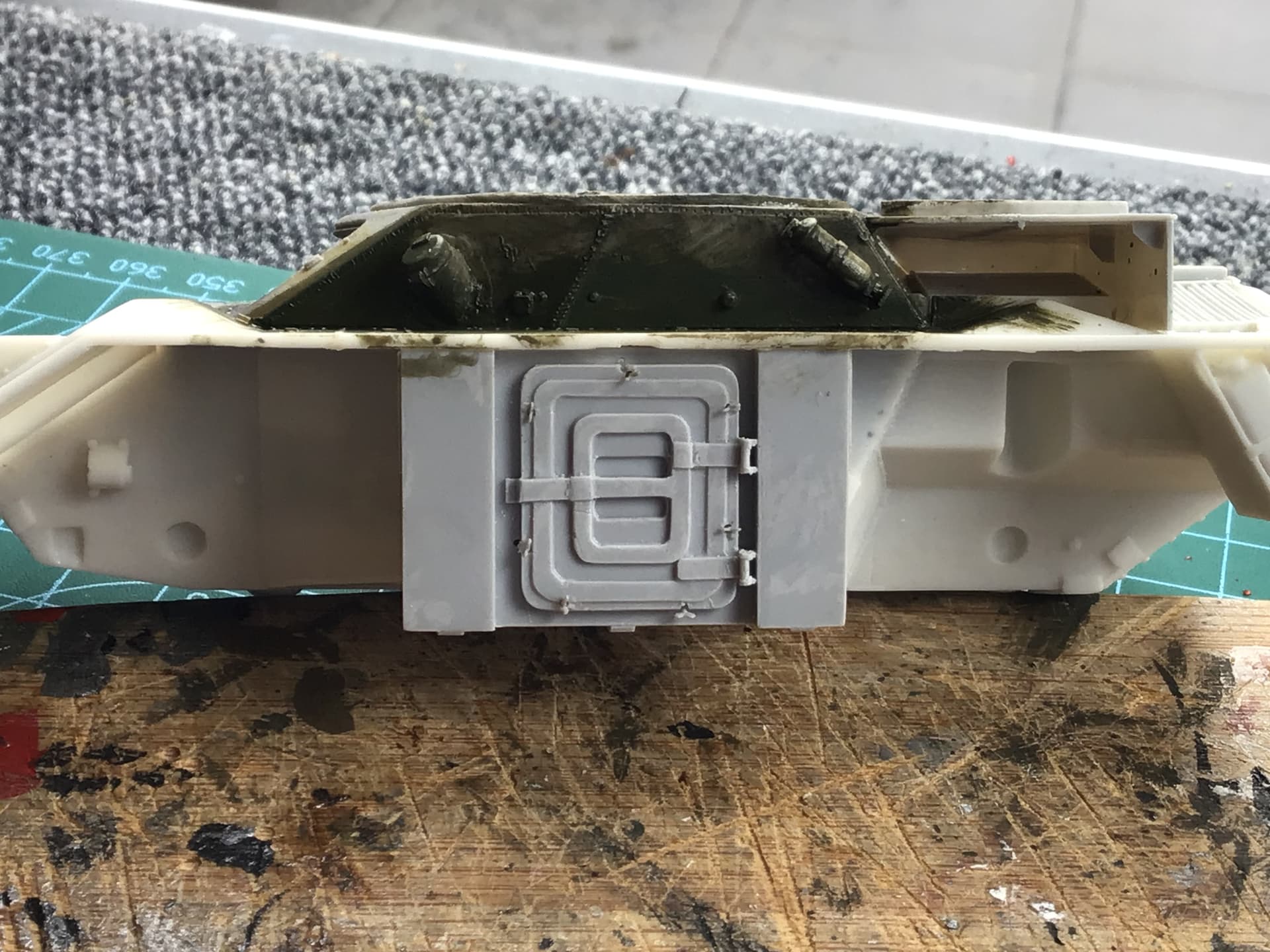

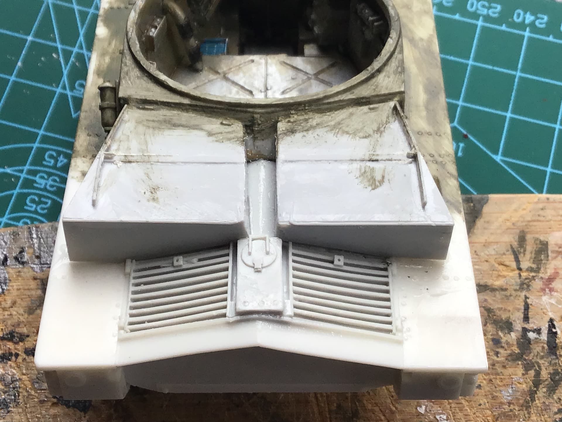

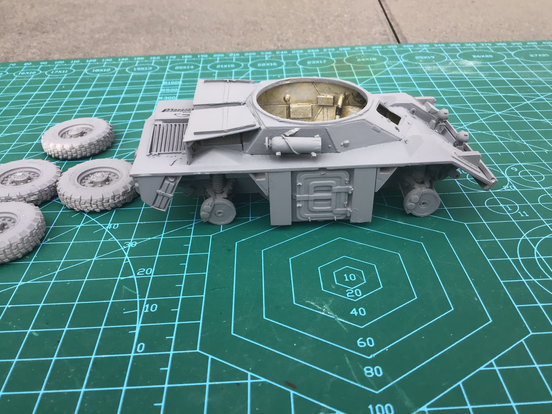

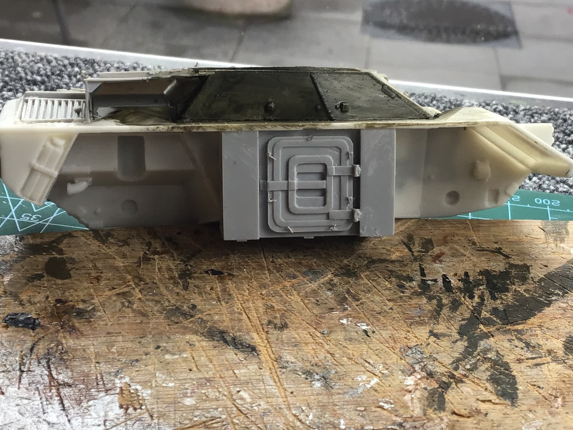

Ok a bit more,a problem of my own making today🙄do NOT join the hull parts together until you have put the engine deck in😳got it in but it was a fight!

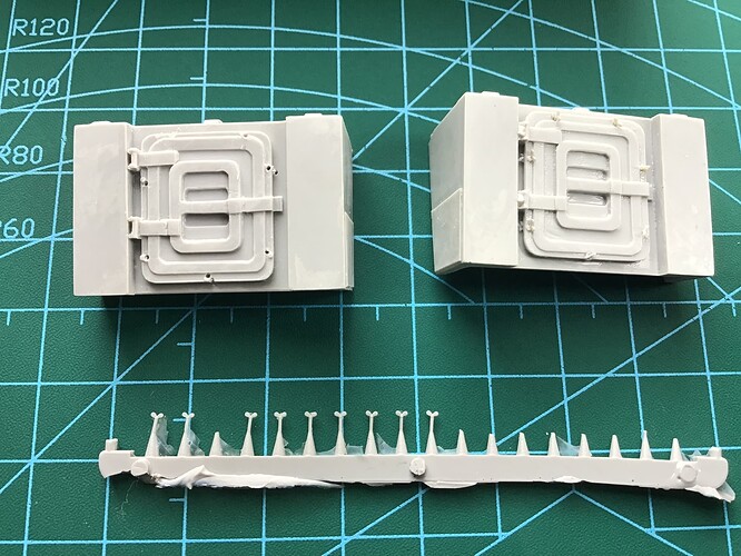

Individual wing nuts on the side bins quite easy if you drill holes first
The bins on
Excuse the mess that obviously will disappear under the primer

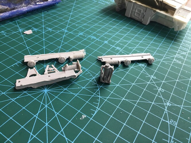

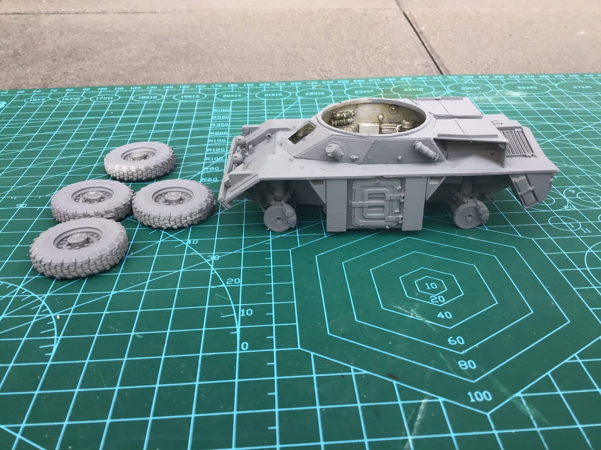

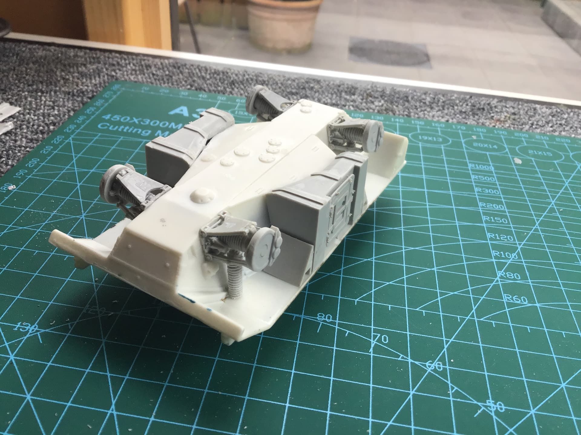

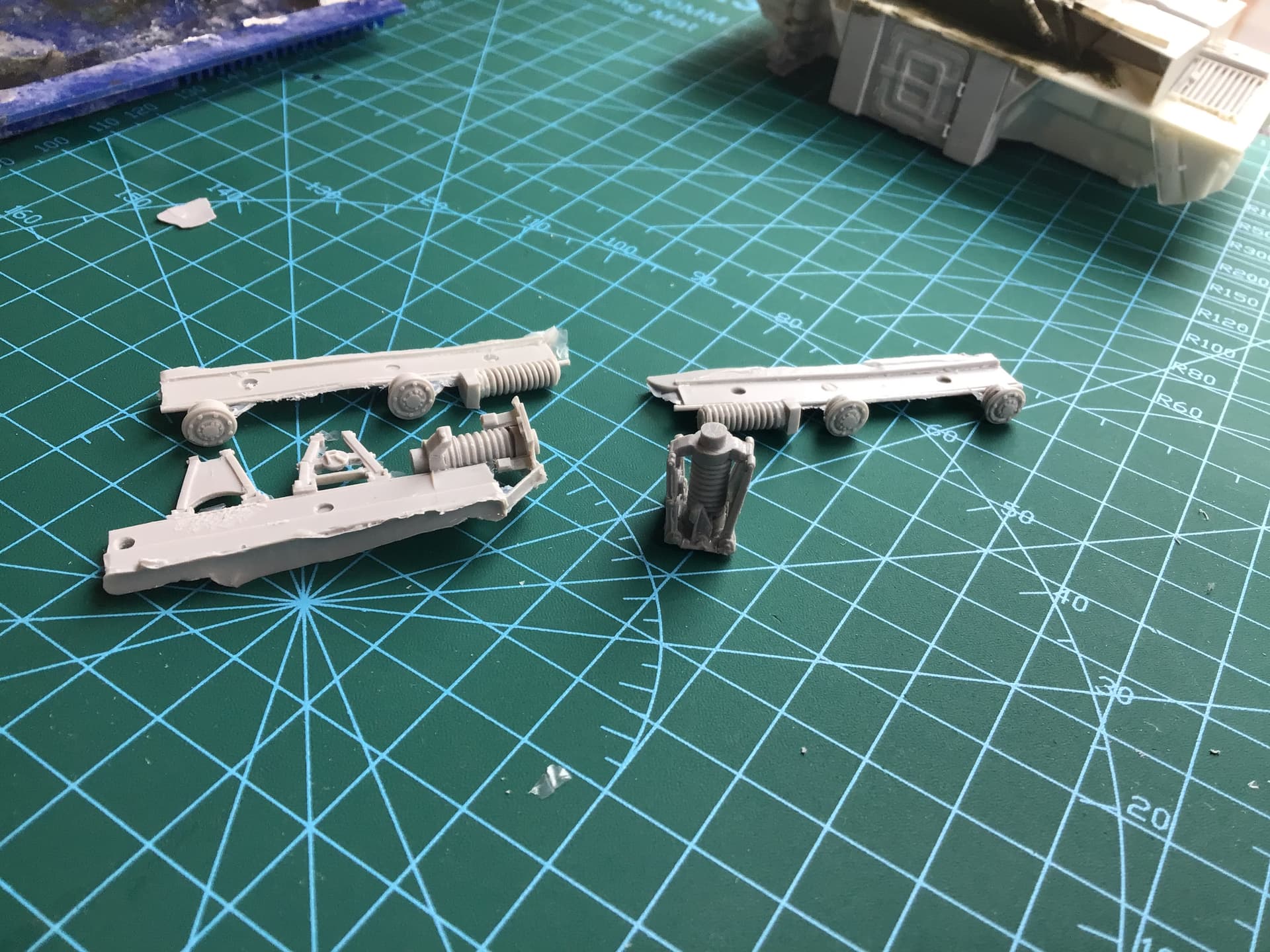

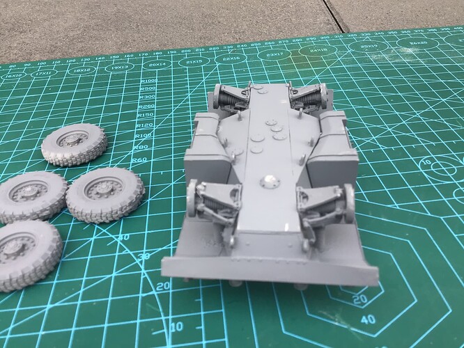

Good afternoon,some progress with the wheel stations,
again nice and simple and good detail,the only extra when fixing in place were some brake pipes added.
Work in progress,
Mounted.
Jacko

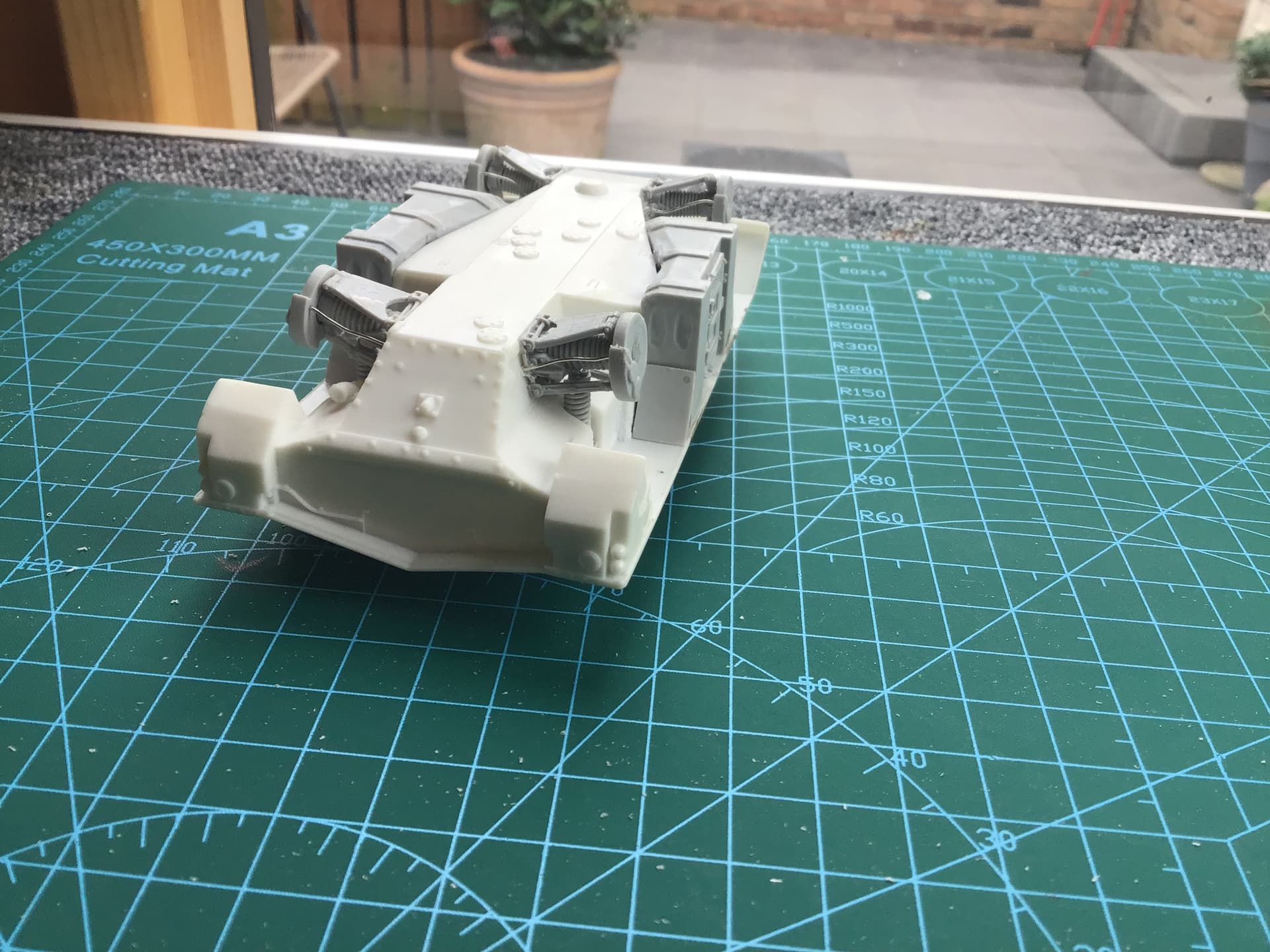

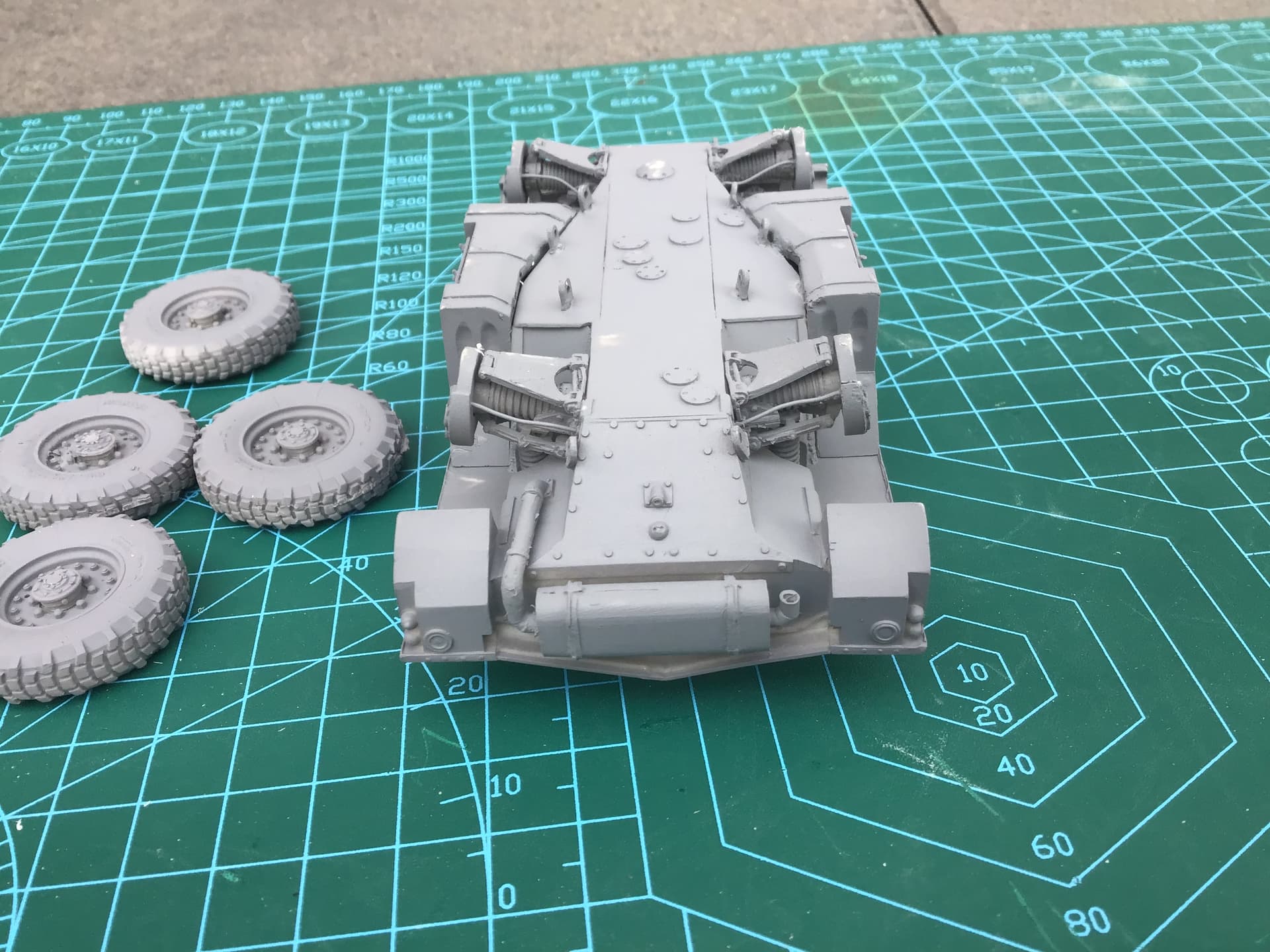

Lower hull 99% done and primer on,
Pretty straightforward,steering links and tie downs added I can only assume there are a lot under the hull for securing it on the platform when they chucked them out of the back of a herky bird😀
