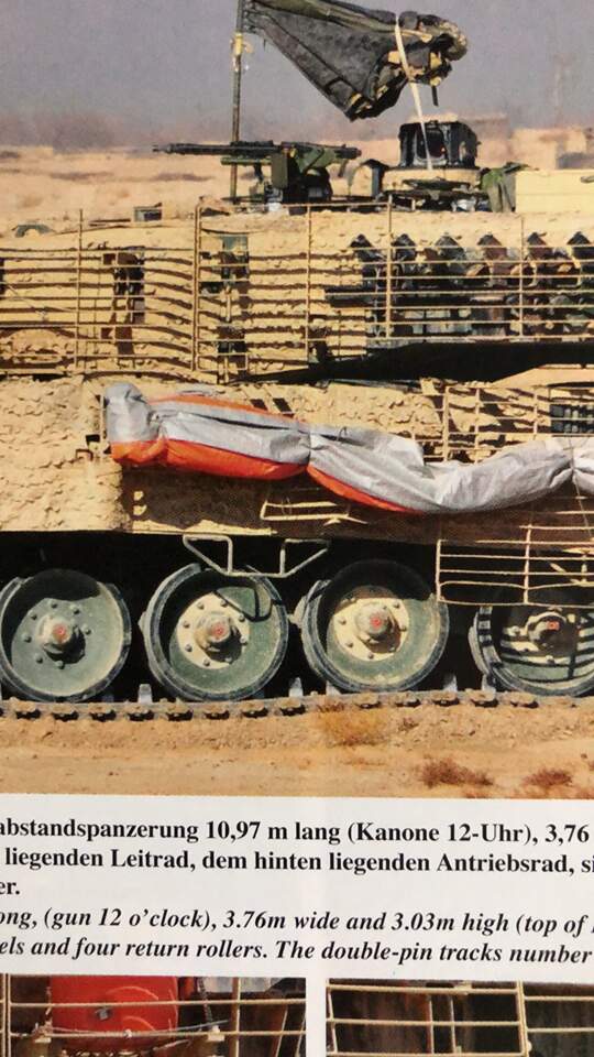

I also did some work on the road wheels, and they are ready for weathering now. I took some artistic inspiration from the Tankograd book, in which I saw a Leo with a few green wheels and tan hubs. I suppose this is from replacing the road wheels with new ones which were based in green. Wheels came out good I reckon.

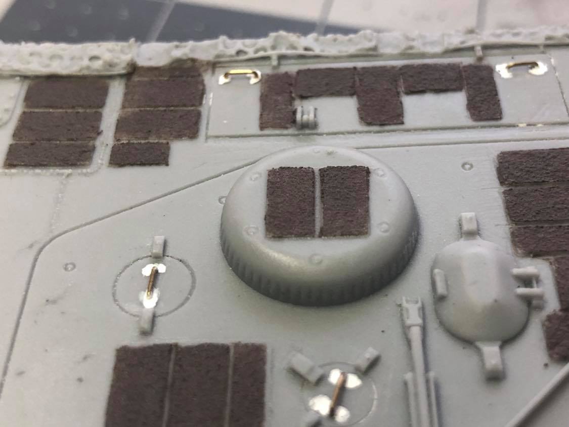

Today I decided to do some work on the upper hull. I found some old 1/48 PE for German tools and figured the buckles could be used to add some more detail, and it seems they work rather well.
I then added the anti-slip texture to the hull deck using Migs anti-slip paste for 1/35 scale. I will need to wait for it to fully harden and sand the burs away from masking. But overall, the texture came out pretty nice.
Your road wheels look good but keep in mind none of the Leopards were repainted for Afghanistan. The caked on dust and dirt made the suspension look like it was painted tan. The road wheels that were green were simply clean replacements fitted on to the dust encrusted hubs.
In either case, the wheels represent one of the reference photos I am working off of. I’m not sure if that is dust, or paint but it looks accurate. Enjoy your feedback too, info like that is really helpful in creating a more accurate kit.
