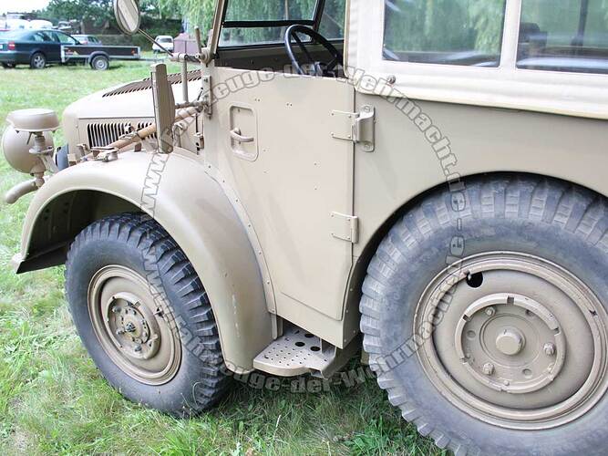

Unfortunately all the kits on the market currently, (ICM, Revell re-box, and Tamiya) get the front fender/wheel arrangement really wrong, and the Tamiya has those strange rear doors that they seem to have confused with rear-hung removable side doors. I wish there was a good after-market fix for the dodgy front end. ![]()

Thanks for the comment, can you please elaborate on the fender and wheel issue ?
Hi Jacob
All the 1/35 versions of the Horch s.Pkw have the front projection of the mudguard too open and angled.
This means all the geometry around this area is thrown out.
If you look at original vehicles the forward end of the front mudguard is more rounded and less open.
best regards
John
Yes, very much influenced by perspective and shadow on pics like this one.
This photo was in the original horch instructions from Tamiya. I don’t know if it still is.
Many ‘Blue print’ line drawings also show the wrong shape.
The side door storage arrangement you mentioned.
I see. From period pictures it seems the majority were more rounded off, but there are quite a few with more prolonged front end (maybe bend out of shape? ). Thanks for the additional information.
