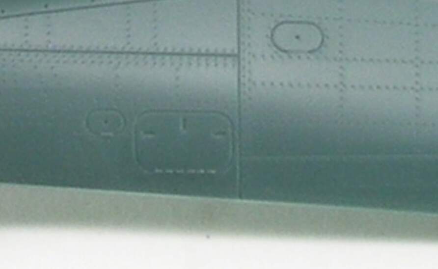

Just noticed working on the 1/72 Eduard FW 190 F-8 that there is no access panel on the starboard side of the fuselage,with no type of stencil to draw around how’s one supposed to fix this?
As you can see the 1/48 kit has the access panel.
To fix this you need to use a scribing template that has a rounded rectangle shape. These are available from a number of manufacturers, Eduard being one.
You will have to fill in the oval door at that location, and rescribe it in the location shown in the 1/48 scale part.

Hasegawa and others have templates for scribing, regardless of scale:
https://www.super-hobby.es/products/Cutting-Template-D.html
UMM-USA has everything you need
Looks like the Eduard 00028 is the one to go for as there slightly rounded.
I’ve looked at the fuselage on earlier 190’s and this panel "first aid hatch"never showed up until the A-8 F-8.
I think Eduard has put in the early fuselage and not a A-8 one.
