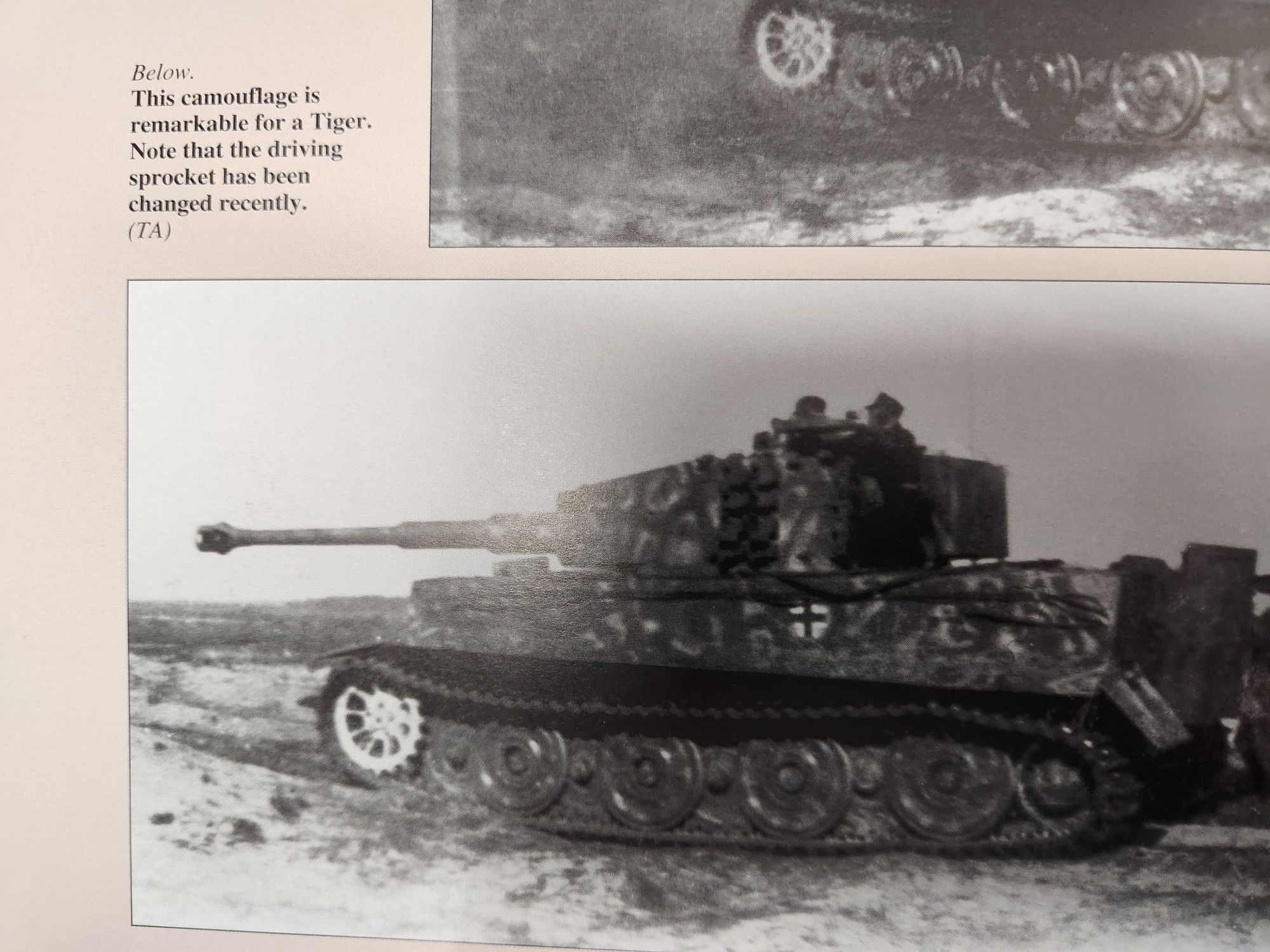

Jack I’m not 100% sure but I don’t think the Tiger 1s were painted in that scheme. Tiger IIs were but I think Thigef 1s weren’t in production when that scheme came into use.
Is there any camo that is close to ambush that tiger 1s had?

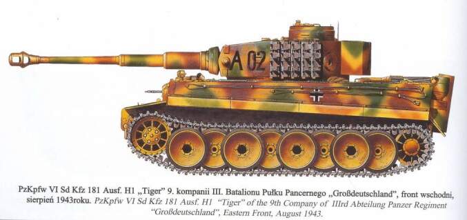

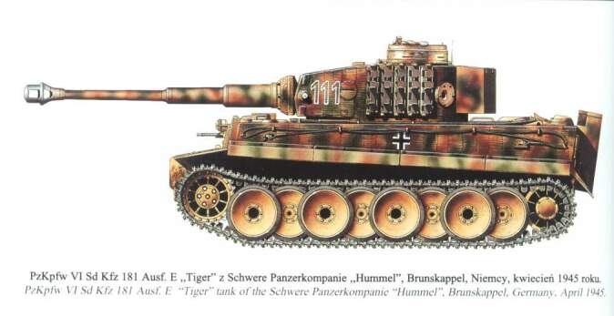

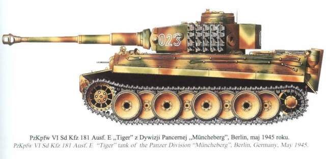

To be accurate for a Tiger 1 and the time period it operated, it will depend somewhat on the version you have (steel wheel vs rubber, etc). The closest you have to the hard edge Ambush Scheme, will be a soft edge tri-colour without the individual contrasting dots, something like this:
and to a lesser degree:

Right. And as Metalhead85 mentioned, Tiger I production ended just as the ambush scheme was authorized.
Tricolor is as close as you’ll get to ambush.

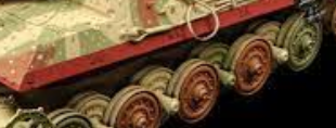

Ok, thank you, guys! This will help me a lot it currently is a winter camo I did about 2 years ago when I first started airbrushing, I have been wanting to redo it. Peter the middle one you found I think will look best for mine. Should I do some red oxide on the wheels and maybe replace one of the colors with the red oxide?

I have pics of Tigers that show new wheels but they are usually in the Dunkelgelb base rather than left in primer. That’s not to say a spare wheel still in primer never made it onto a vehicle but I would imagine the repair depots closer to the front would be getting stuff from the factories pre-painted and ready to install.

I would not myself. At the time the Tiger 1 was really operational, the vehicles were all painted in RAL colours as per regulations. It was not until later in the war that paint supplies became an issue and vehicles were left with red oxide primer showing as part of the factory applied colour.
As brekinapez has stated, suppliers delivered their product pre painted, either Dunkelgrau initially or Dunkelgelb later (and mostly afterward). A common misconception is that every piece of a tank was manufactured in the same complex. In fact, most components were manufactured in different, and multiple, factories and shipped to where assembly was to take place. It was after assembly that the camo was applied to the base colour.
A good photo to demonstrate the above, is the well known one of the ‘Last Elephant’ tank. Whilst the hull is red oxide primer following assembly, the road wheels and drive sprocket are dunkel gelb:

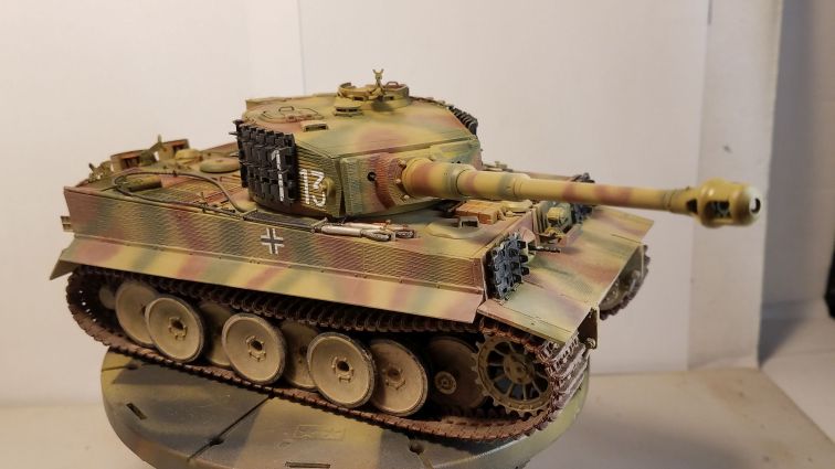

I will post pictures of the finished project on this or I can make a constructive feedback topic. what should I do?
