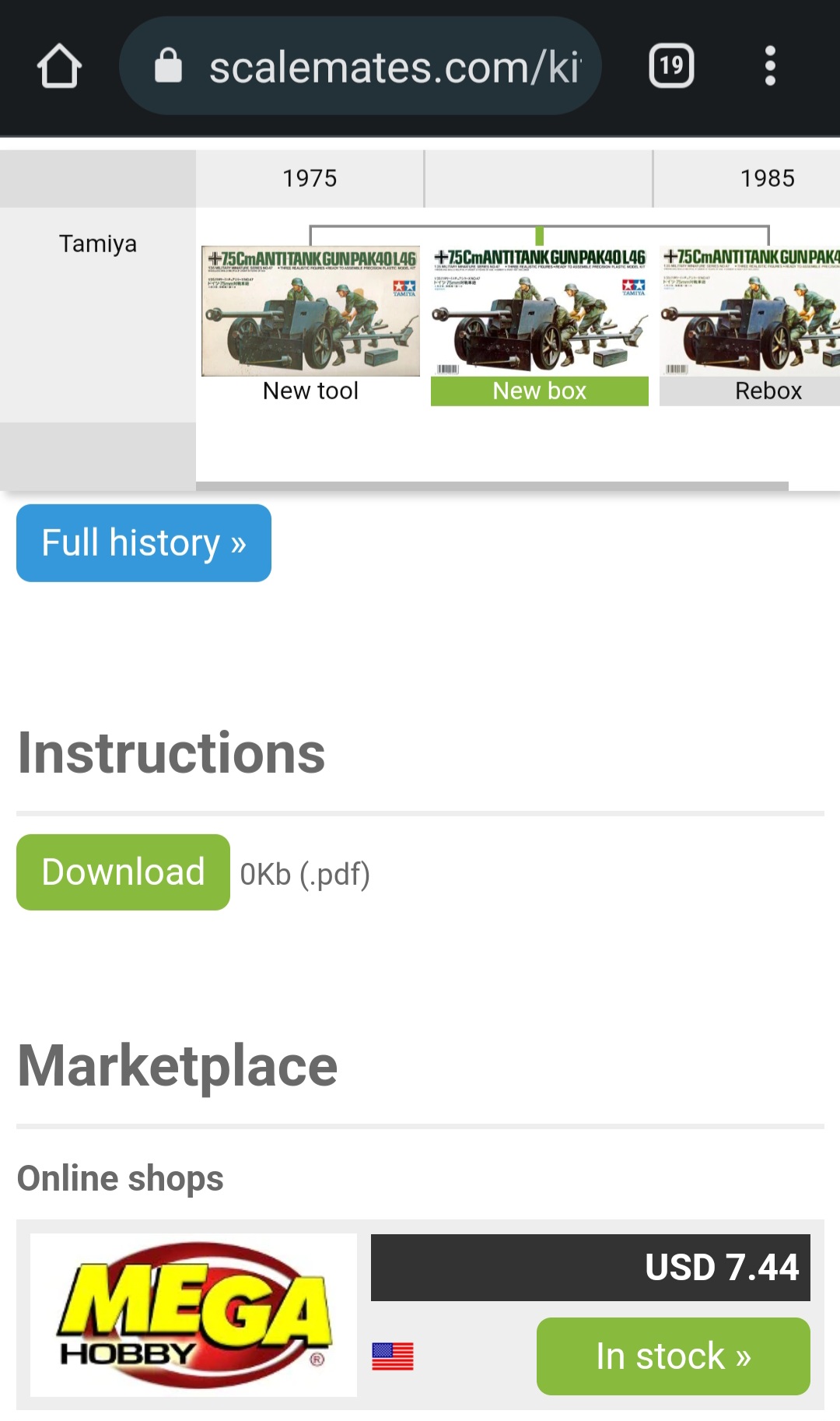

Start by googling the kit plus scalemates and looking at the instruction sheet carefully to see what your getting into building. Also find and read/watch video of the kit review build before purchasing a given kit. Scalemates: Tamiya 7.5cm-anti-tank-gun-pak-40
Schroll down and to the instructions and download the pdf. You can see what’s involved to build most kits. Example.
Instructions…

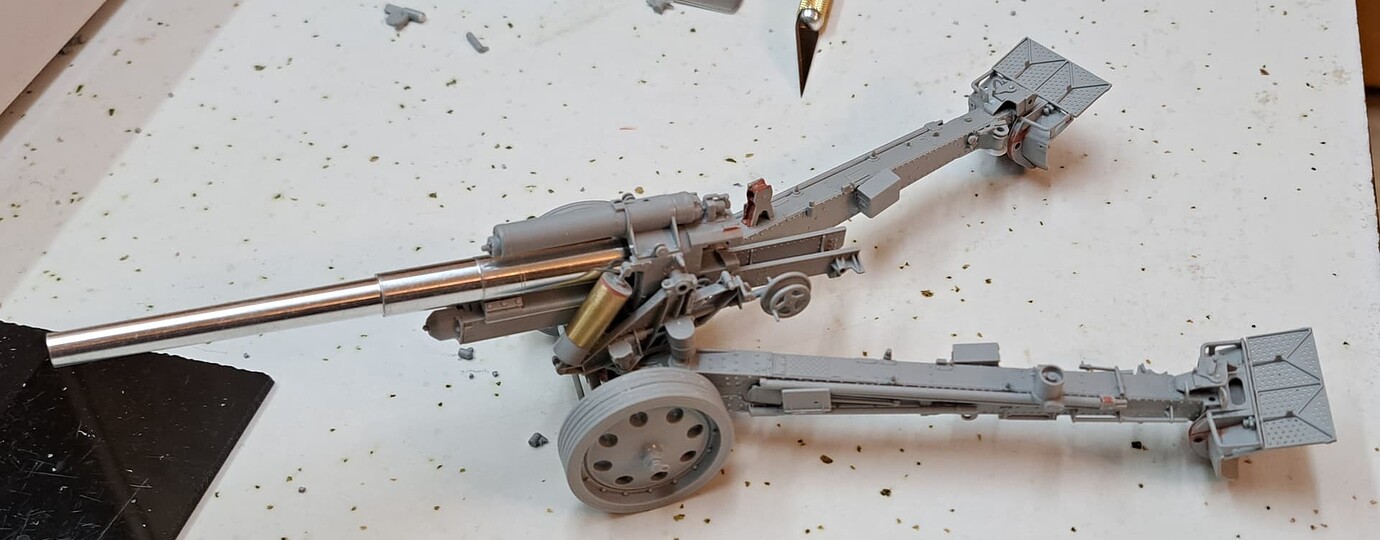

I built Trumpeter’s German s.F.H 18 15cm Field Howitzer and the only complaint that I would have is that you could elevate/depress the gun, but not adjust the azimuth.
