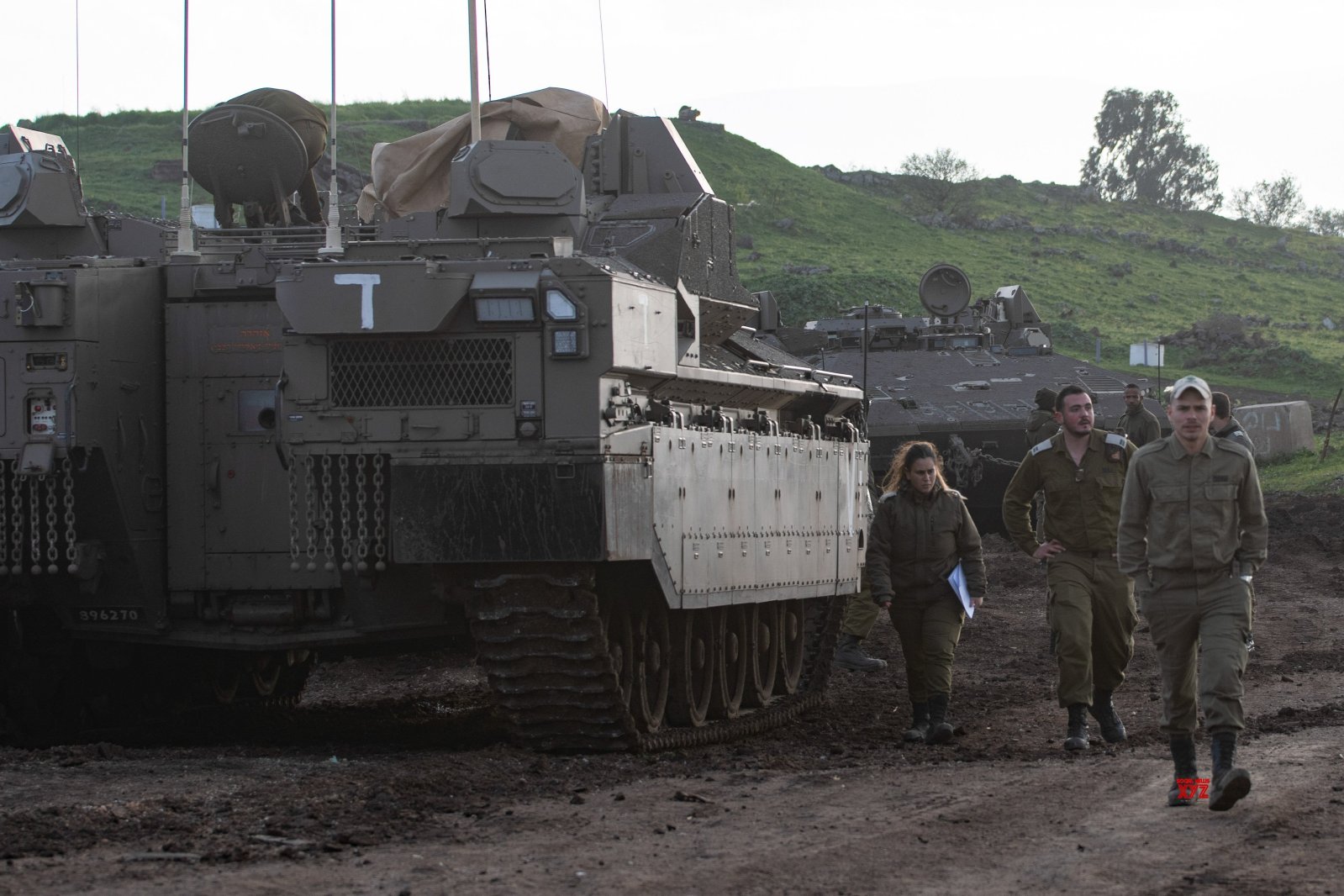

Here is a setup for a Namer
The basic antenna setup is one white antenna on the rear, atop the left corner of the rear exit door, like the one in the photo
and one shorter black antenna on the right side
The white one should be 6-7 cm in scale and the black one 3.5 -4 cm in scale.

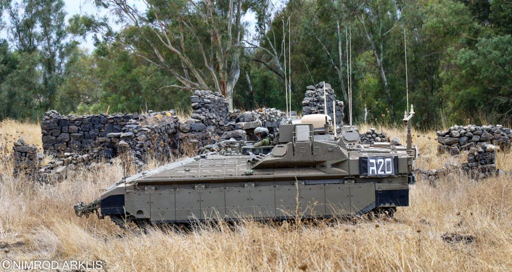

There are also vehicles with different configuration, like the one in the photo, you can do something similar.
For the B version you need a different setup with more antennas

The higher the vehicle in the command chain, the more antennas it has.
It does: the thin dark ones are actually dark green and they’re for the receiver; the tall and thick white ones are for the receiver/transmitter.
I will probably put 1 white one and 1 black one. I don’t think I would put more than 4. But could I put all white antennas?
A company CO/XO vehicle has usually three:
a brigade CO/XO five:
I’d say four is plausible for a battalion CO/XO vehicle.
