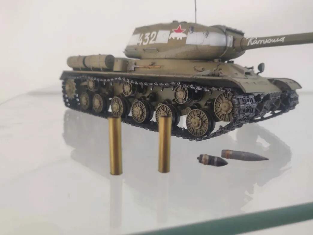

How should I "secure" my tank shells on a shelf?
Hey guys, I once again come to you with a conundrum and will be grateful for your help
So I decided to display each of my tanks with their respective available shells
But there’s one problem
At 1/35, they’re so damn small and light, they just roll and blow away at the slightest gust of wind
Now sure, I can glue them to something, but, I’d like them to be pick up-able, and inspected from all angles by people and myself. But I don’t know how to do that. How do I both secure them, but also make it so they can be removed and inspected?
No idea, even after brainstorming for days.

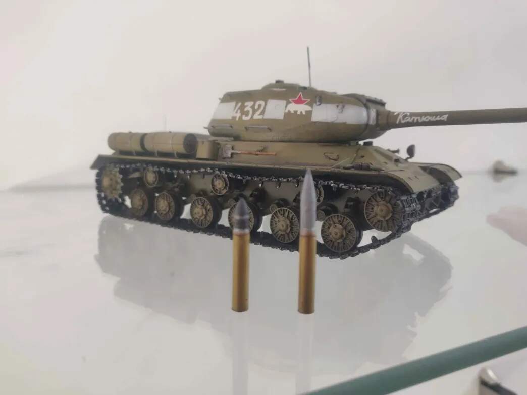

Also, with this specific ammunition (or any two piece ammunition), I would like to display the shells and casings separately
But I’d like them to stay upright, and I can’t do that, because the armor piercing shells have a tracer stub that won’t let them stay upright…
So, I know I’m asking for a lot, but does anyone have any ideas on how I can secure my shells so they don’t roll off or blow away, while also making so they can be picked up individually?
Would appreciate any help! Thanks!

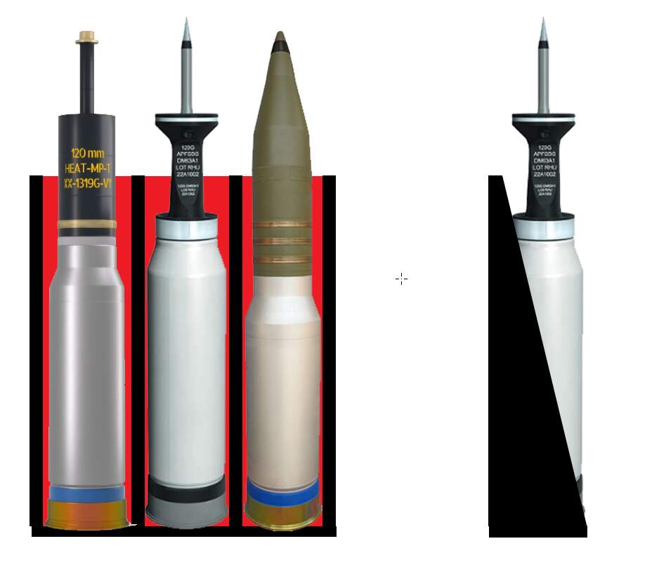

I would go for some type of display stand, either a flat “plate” with holes
or a reclining stand
General idea:
A flat “plate” with grooves filed in or profiles glued to it.

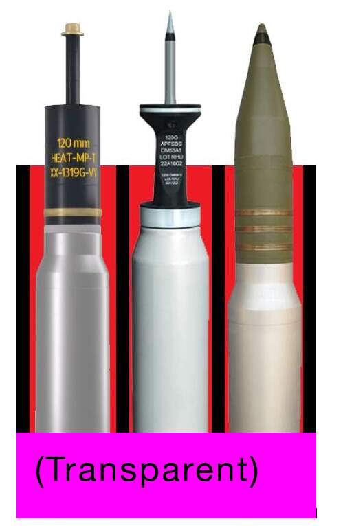

Oh yes, all of these are good suggestions that I’ll apply! I’ll put the backing holder at an angle, and of course I will make the base sturdy and heavy, it doesn’t need to be dainty like the rest that’s no problem. Maybe I’ll even just add a small square at the bottom to hold the shell, because if it’s transparent, it’s no problem, like this:
