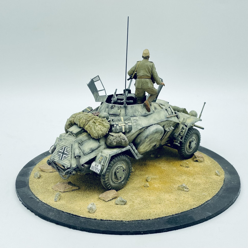

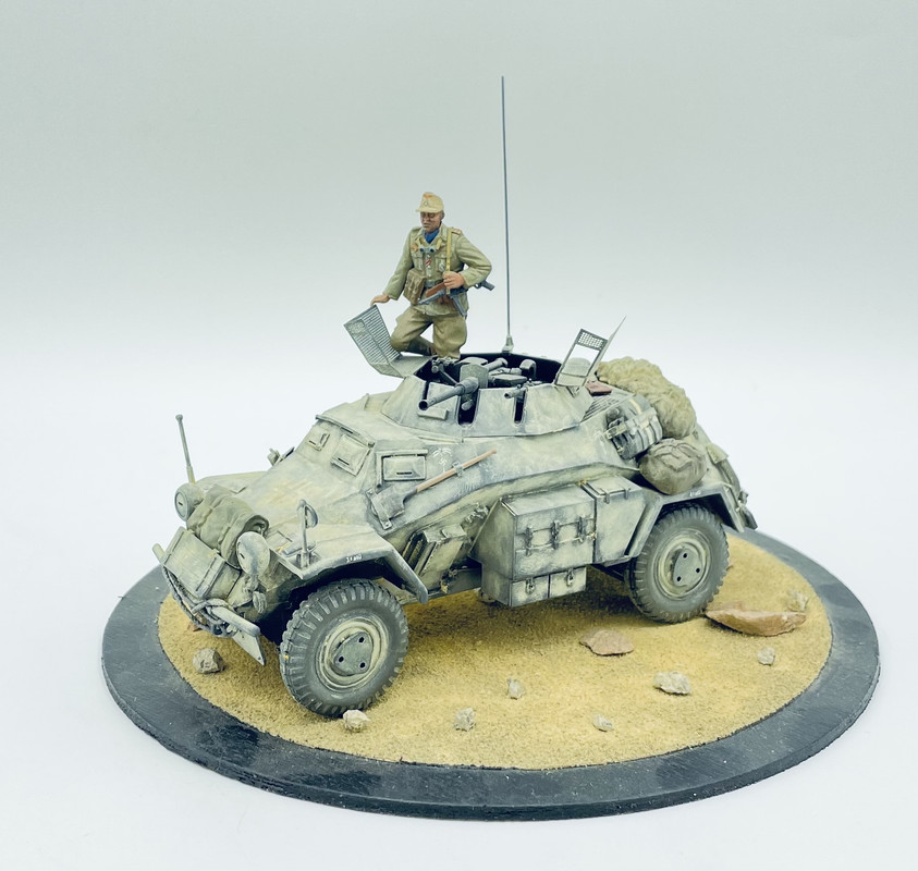

On this Tamiya Sdkfz.222 for the field applied mud camo I used a heavy application of Tamiya Weathering Master.
The stuff in the little flip top casing on the bottom here.

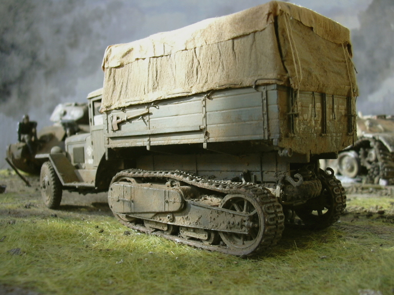

I have seen it in a great modeler video (Night Shift Modeler making a French tank, I think) and based on what saw, used this on my Austin armored car bottom sections. I believe you can also use it all around the vehicle but never tried.

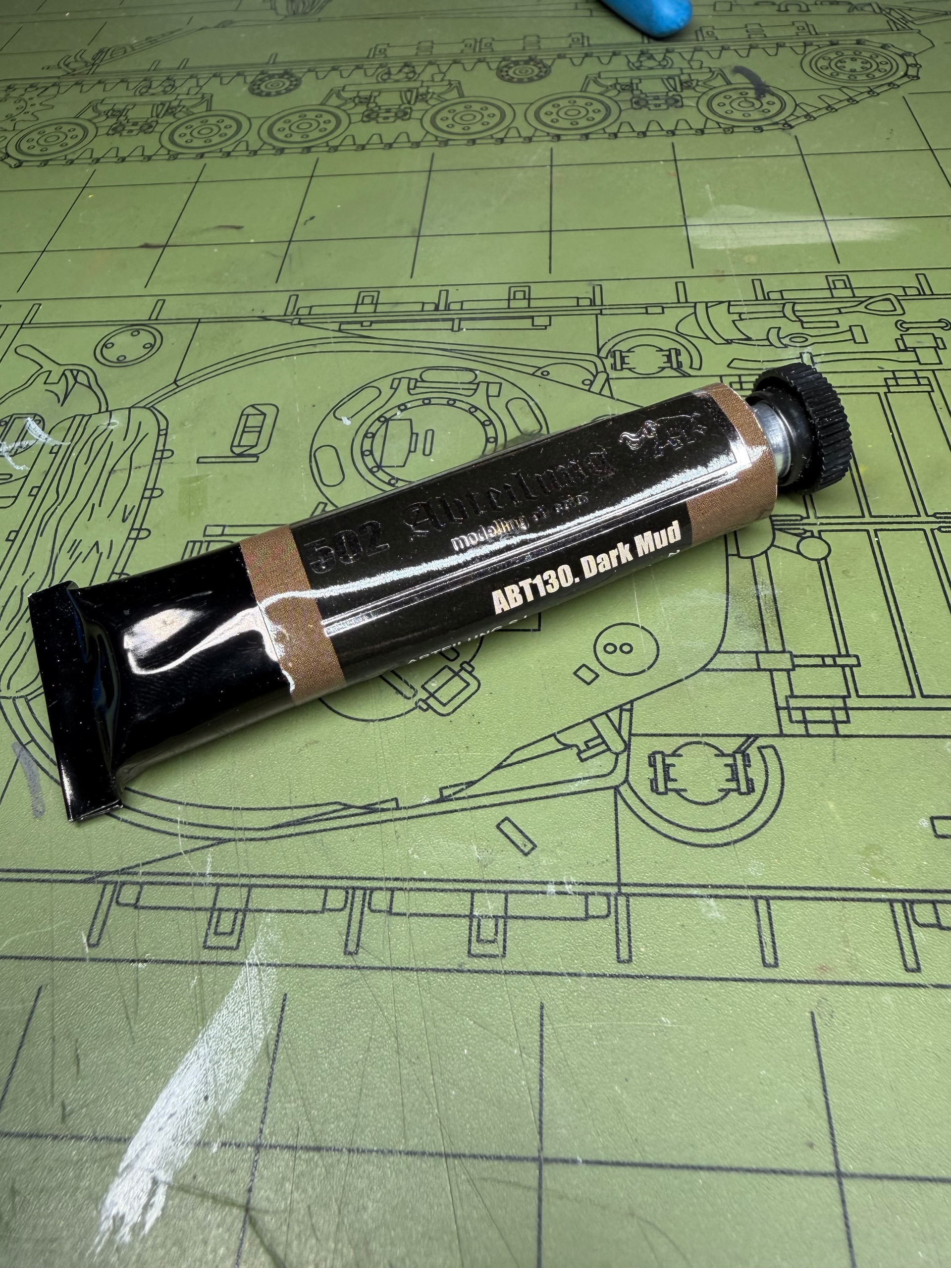

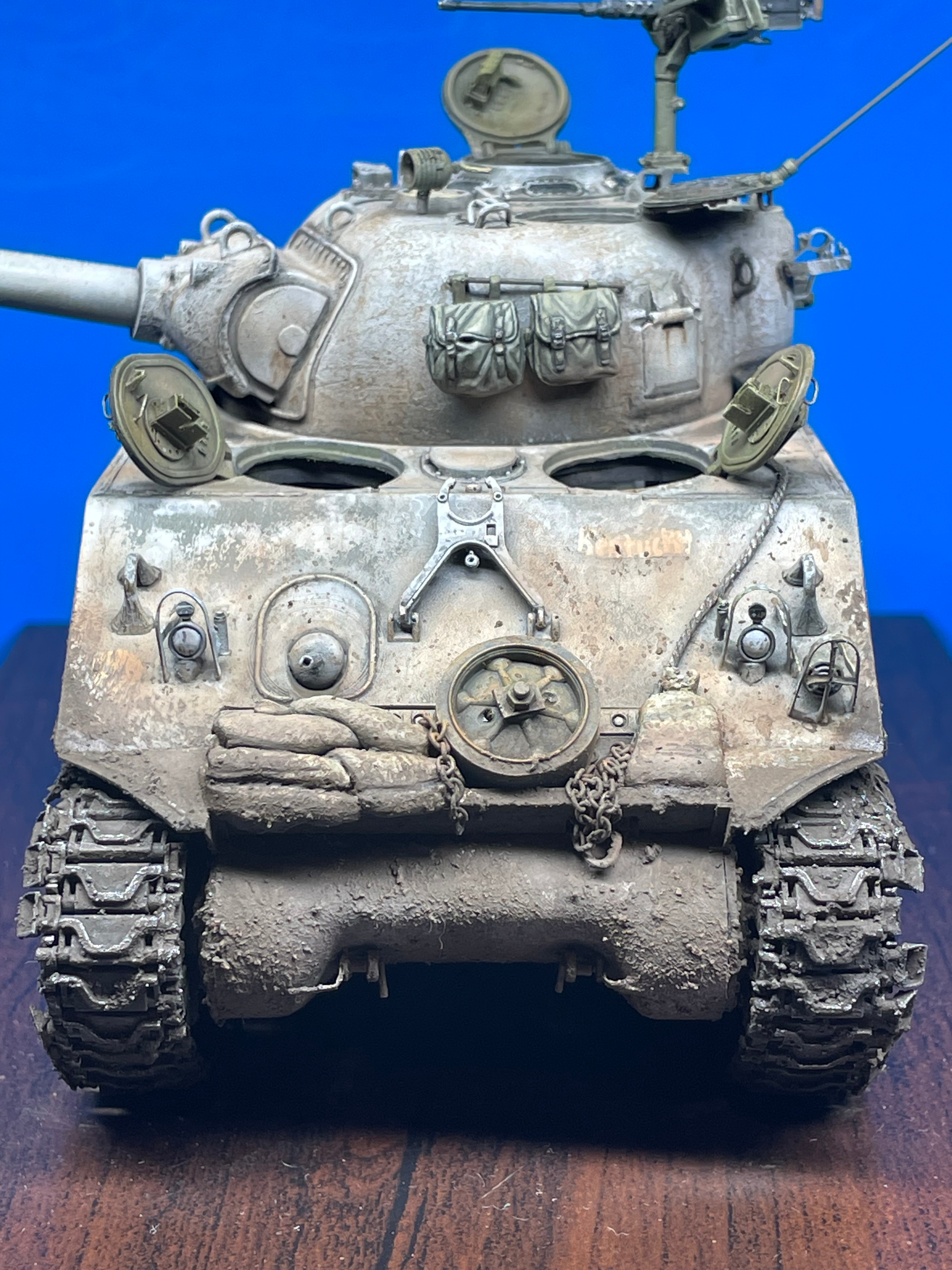

It definitely makes sense to try it out on a test mule of some kind, or even a scrap of plastic card painted in the base coat you plan to use. I used dark mud colored oil paint from 502 Abteilung on my M4 (105).
