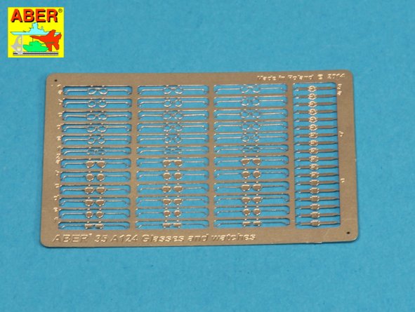

Check out Aber set 35A124 :
Some of the glasses variants may fit your needs (and the price is quite reasonable)…
