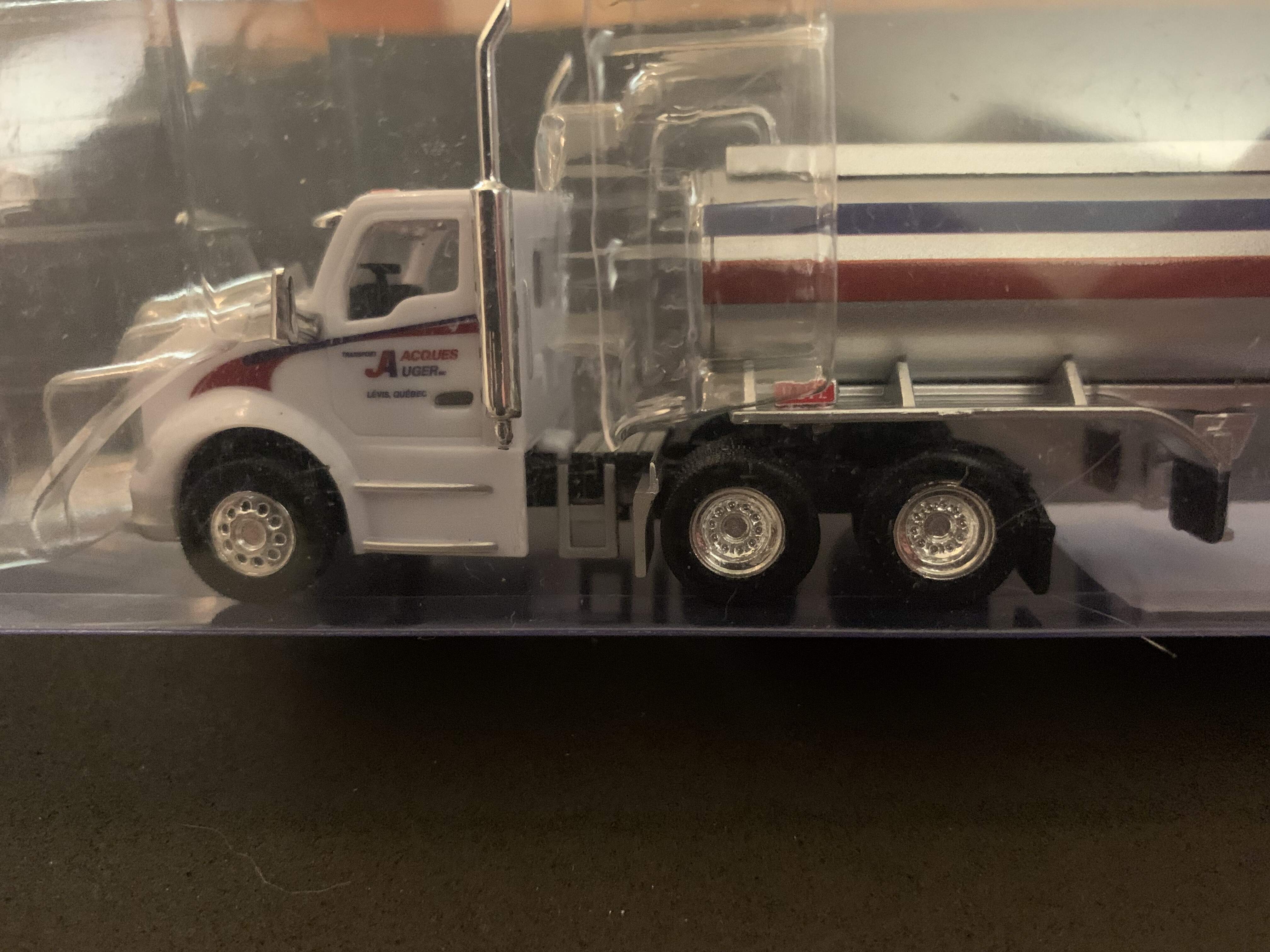

You don’t even need Mattel’s Vacu-Form machine -
Just heat from clear plastic packing over a suitable round object and slice off. You can instantly vary the size of the bubble by choosing different “forms.” The rounded ends of chopsticks or wooden dowels comes to mind.
You know the plastic I mean - usually found on notoriously hard to open packages.

Thank you. Your solution seems to be the most do-able, although a little tedious. I’ve got tons of this kind of clear packaging plastic. I shall try this!
