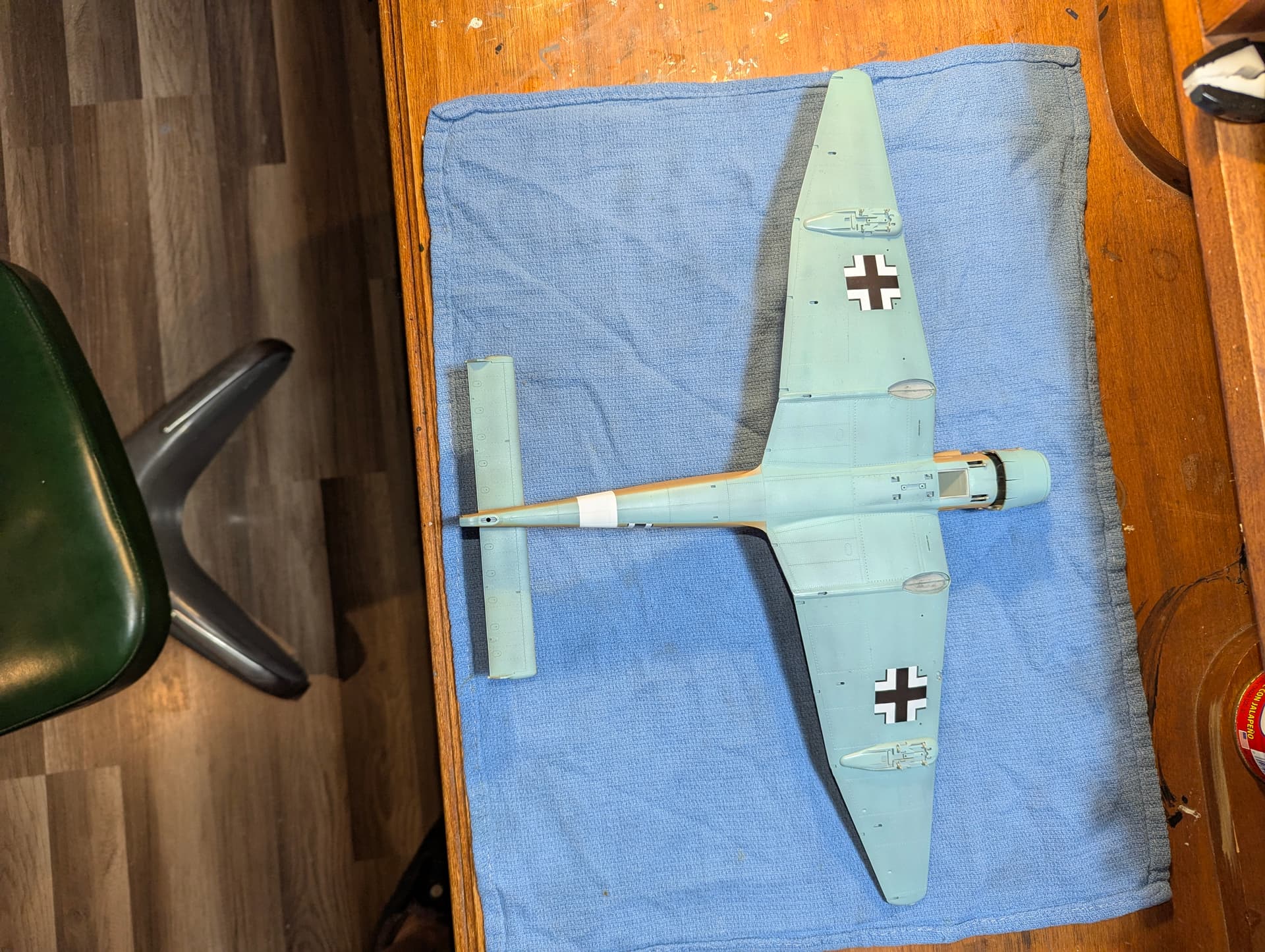

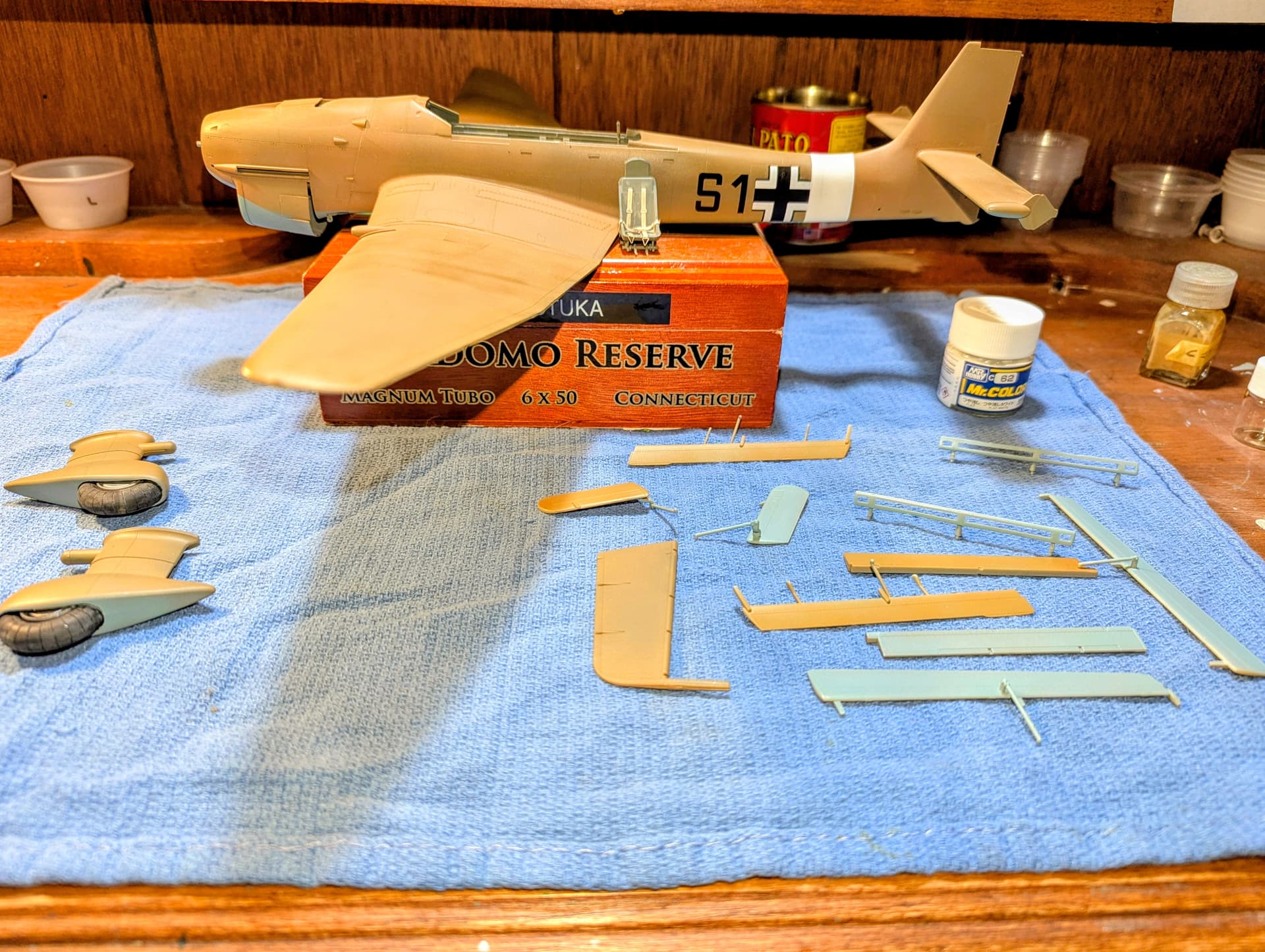

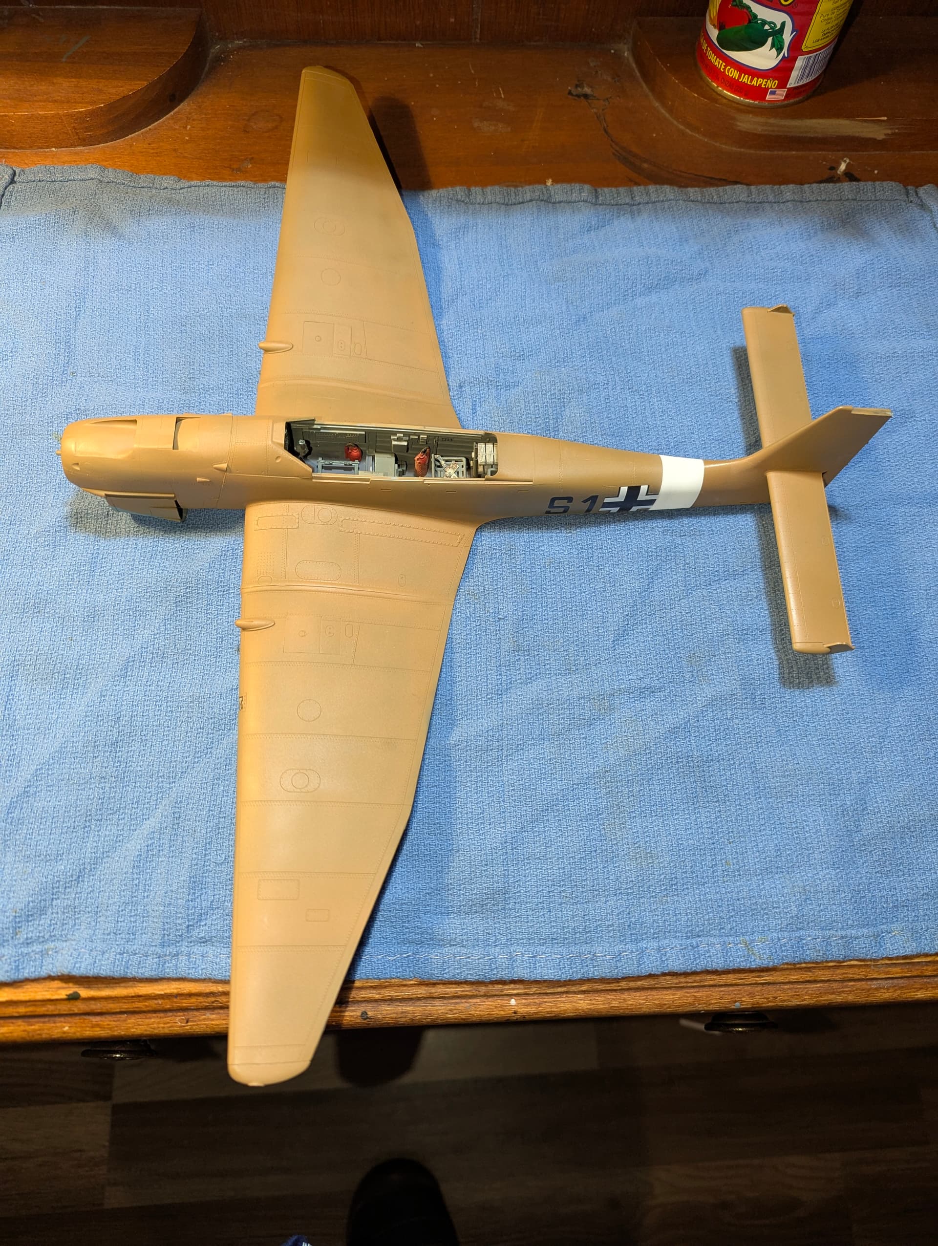

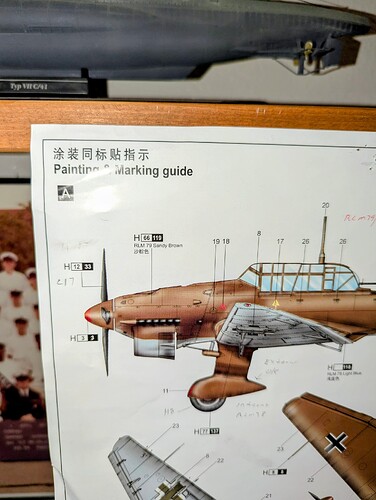

what I have so far , this version calls for a red tipped spinner. I have never had to tape off a spinner , this is scaring me :face_with_spiral_eyes: been on this project since 02-25 this 1/32 scale was to large to fit in my indoor paint booth, had to wait for warmer weather to set up in my garage. I know the Balkan Kreuz decals are too small, I had on hand some properly sized vintage EagleCals that fell apart on application due to their advanced age.Few of the decals will be historically correct for this R version Stuka. Search on forums turns up no advice on my spinner masking. Thanks to all for viewing my project.

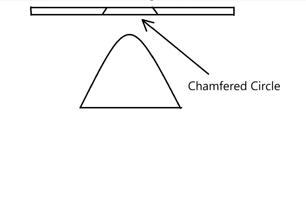

Punch a circle in cellophane - the stretchy kind. The hole should be smaller than it needs to be. Stretch it down over the spinner until it’s where it needs to be, and make adjustments to it until it’s right. The advantage is that the cellophane makes a pretty good seal. The disadvantage is that it depends on your MK I eyeball to get it right.
I’ve had better success with the “sombrero” technique above, except I do it by punching a circle out of styrene. Then I chamfer the edge so that when I place it on the spinner the edge of the mask actually meets the spinner.

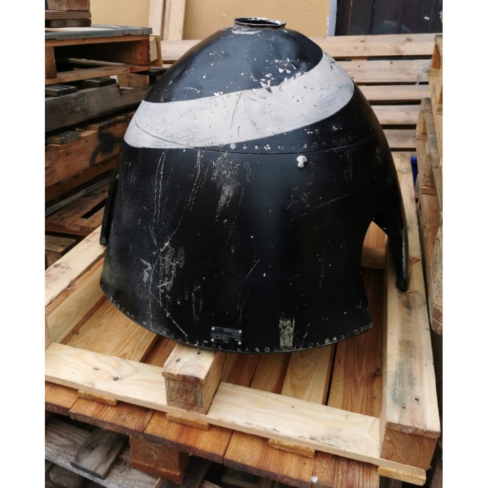

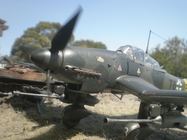

Spinners were probably not all painted perfectly, as this original shows. Nor did they need to be. However, such intentional imperfections are difficult to pull off in 1/32 or smaller without looking amateurish.
The above photo also shows that many spinners were made of more than one part, so that it would be relatively easy to paint “just the tip.”
