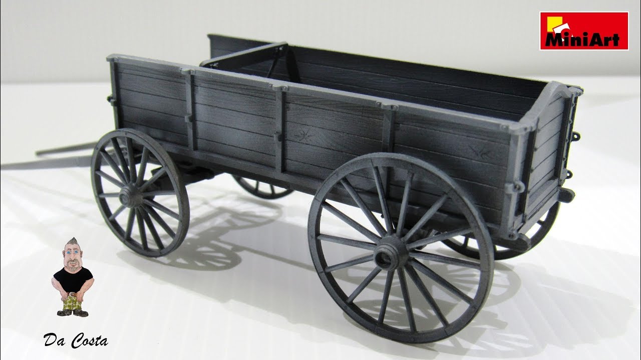

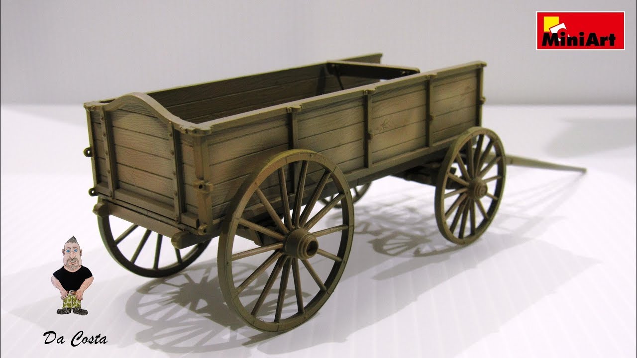

With thin paint you can pre-shade (make corners and areas around fittings, etc, a darker shade) by spraying a thin coat of a dark colour (or light colour) in certain areas first, then spraying your base colour in thin layers over that so the pre-shade colour makes your base colour darker or lighter in some areas.
Pre-shading demonstration:
Painting the base colour over the pre-shade
