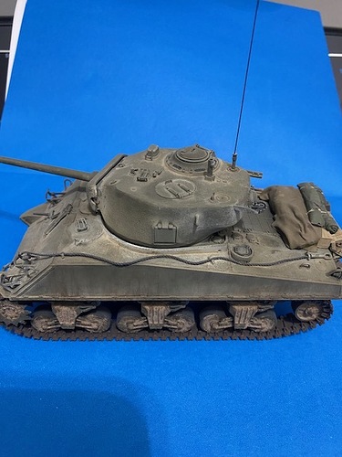

@Signcut
Your photo proves that you can make a really nice looking Emcha 76mm using DML kits. Nowadays I would go a different route even if I had all the bits to correct a DML.

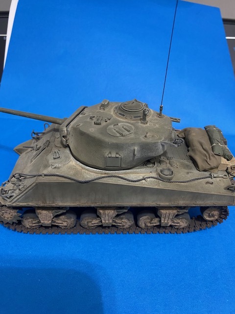

Here is a shot from the other side. My problem became Son of Sherman. It was no longer just building a sherman. One thing that needs adding is an exhaust deflector. Shapeways used to have a good one I used for this. I’m fuzzy, but if I recall, the DML “Red Army” kit has the earlier 47 degree hull and there weren’t many of those as 76mm. I will try and remember just what I did to get to this point.
Jeff
