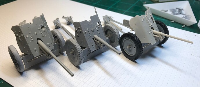

Finished. Not spectacular . Very subtle differences between it and the German Pak 35/36.
Wooden spoked wheels ,36mm to 40mm, and slightly longer barrel.
This home built anti- tank gun allowed the Hungarians to use the same 40mm rounds they were producing for their domestic produced Bofors as found on the Nimrod.
Now have to build a gun crew. In their unique short sleeved shirts, great coats, or in their quilted winter garb ?
Hungarian 40m ( MSD and Dragon kits)…Pak 35/36 (Dragon kit)… Pak 41 4.2cm squeeze bore (Riich kit with Custom Scale conversion.)
