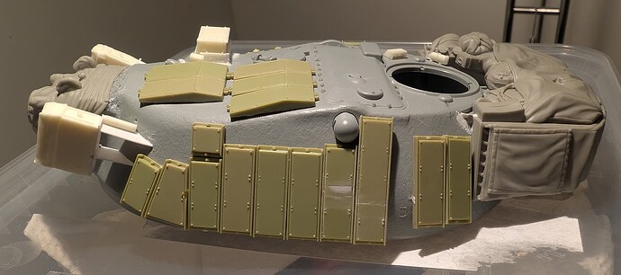

During the past evenings, I have been working on the Blazer ERA bricks. They are just temporarily stuck on, and many of them need to be enlarged. So there is a lot of work ahead of me in this.
Looks nice. The right side looks better to me than the left. A bit better protected with the tile setup.
For the turret roof: Why don’t you go for the Merkava II turret roof armor style? Clad the turret roof with a thick piece of armor?
Have you thought about installing a mortar somewhere? Machine gun mounts?
Thanks for your comments and interest :slight_smile:
Most of the tiles need to be enlarged, to be made longer by adding part of another tile, like I did on the very long tile on the right side, next to the gunners optical sight. It is made from two tiles put together.
Regarding the roof armour, then my initial point of departure was, that my “Magach 8” should look like is was made at the same time as the Magach 6B Gal. So the roof armour should in my mind look like the roof armour tiles seen on the Magach 6B Gal.

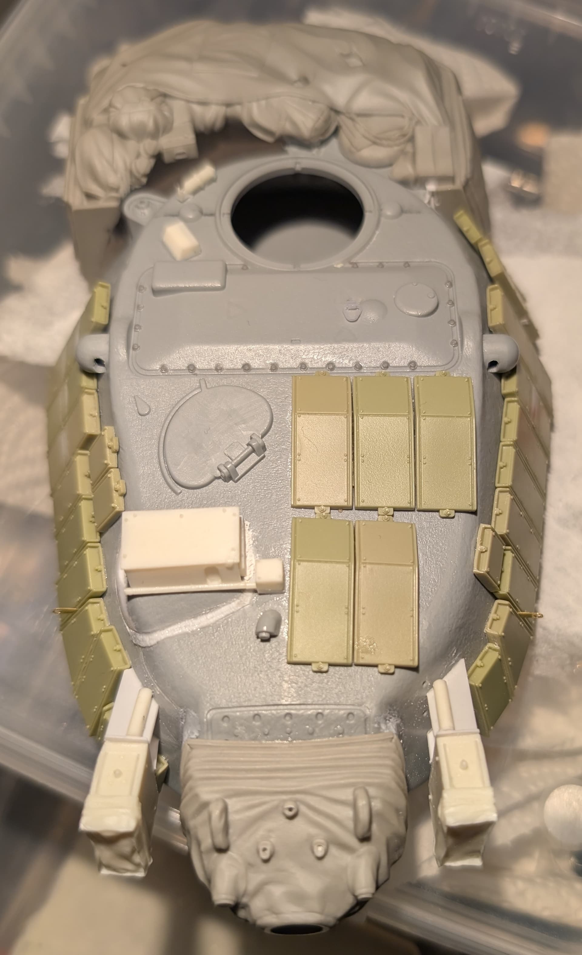

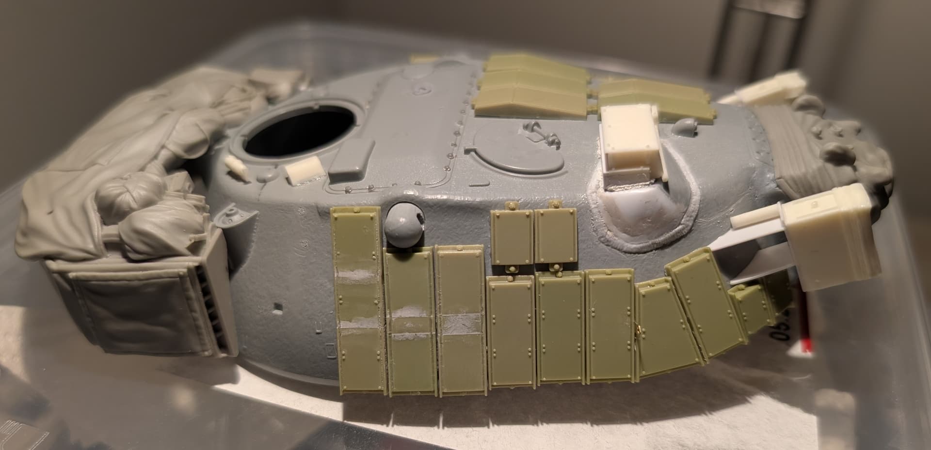

Most of the Blazer ERA tiles on the left side of the turret (looking forward) are now glued. The long tile to the right of the sight unit is the master tile, which dictates the position of the other tiles. At the same time, I can see, that IRL, the tiles are not mounted directly to the hull, there is a short distance between the hull and the tiles.

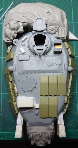

Roof tiles are also glued now, also with a short distance between the tiles and the hull.
The rack for the 7.62mm ammo boxes is just placed on the roof.
The lifting eye on the roof is from “Elefant”. My first experience with 3D-printed parts. Not easy to work with, but the result is worth the effort.

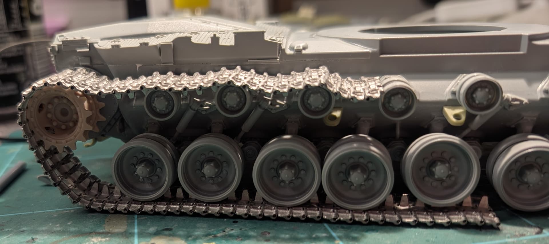

An update on my IDF M103A2 is long overdue, I have been fighting all the wheels of the model, and there are many, which means an abundance of cleaning wheel parts. Not fun at all. But the Friul ATL-49 Merkava Mk. III tracks will look fine, when completed.
Back on the track again … :slight_smile:

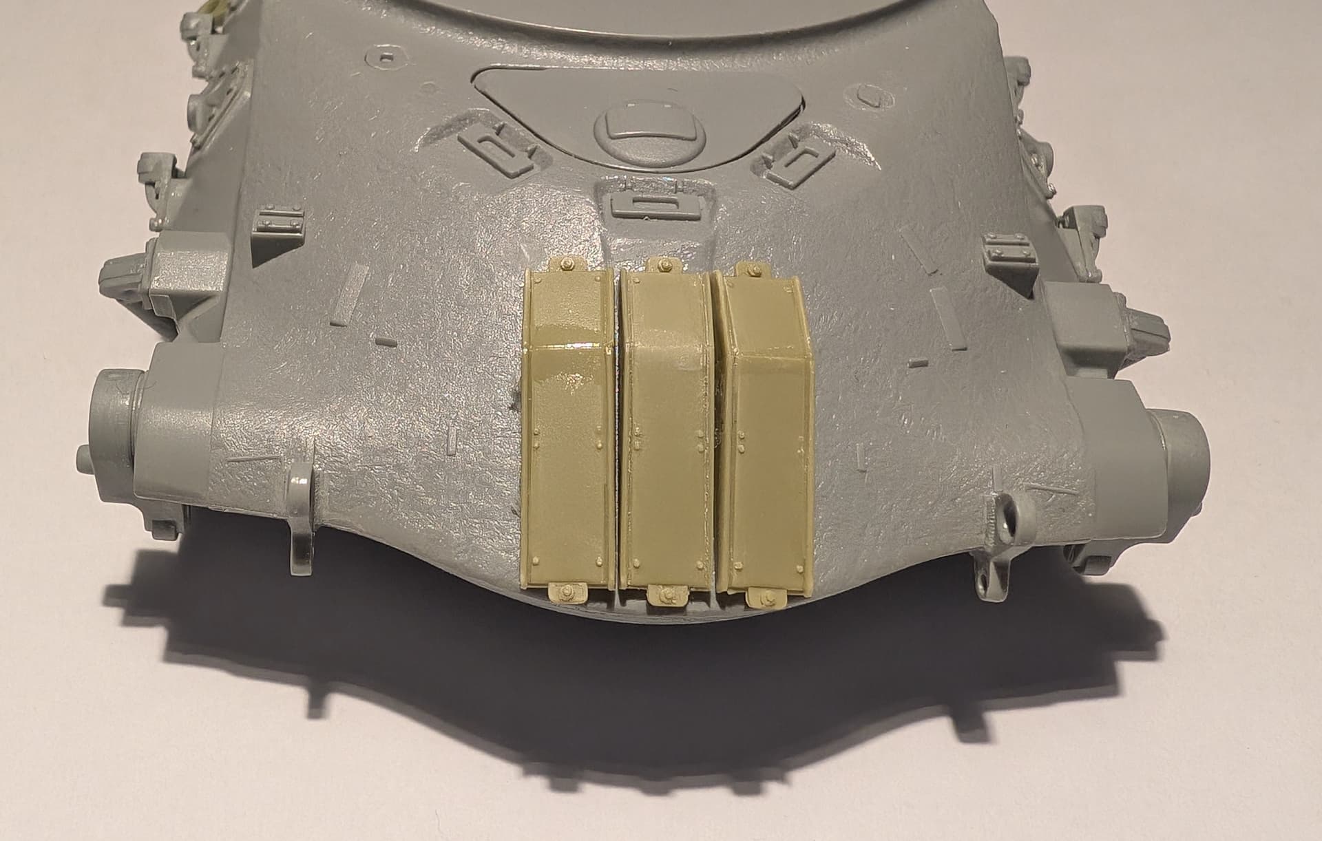

The next subproject is the Blazer ERA tiles on the front of the hull. One of the differences between the M60 and the M103 is the shape of the hull. The M103 has a hull similar to the hull of the M48, meaning the front of the hull is rounded, whereas on the M60 the hull has a straight edge. This means, each Blazer ERA tile has to be manufactured, from the original tiles from the Academy M60 kit. The inspiration for the placement of the ERA tiles is the “Pereh”, M48-based missile carrier.

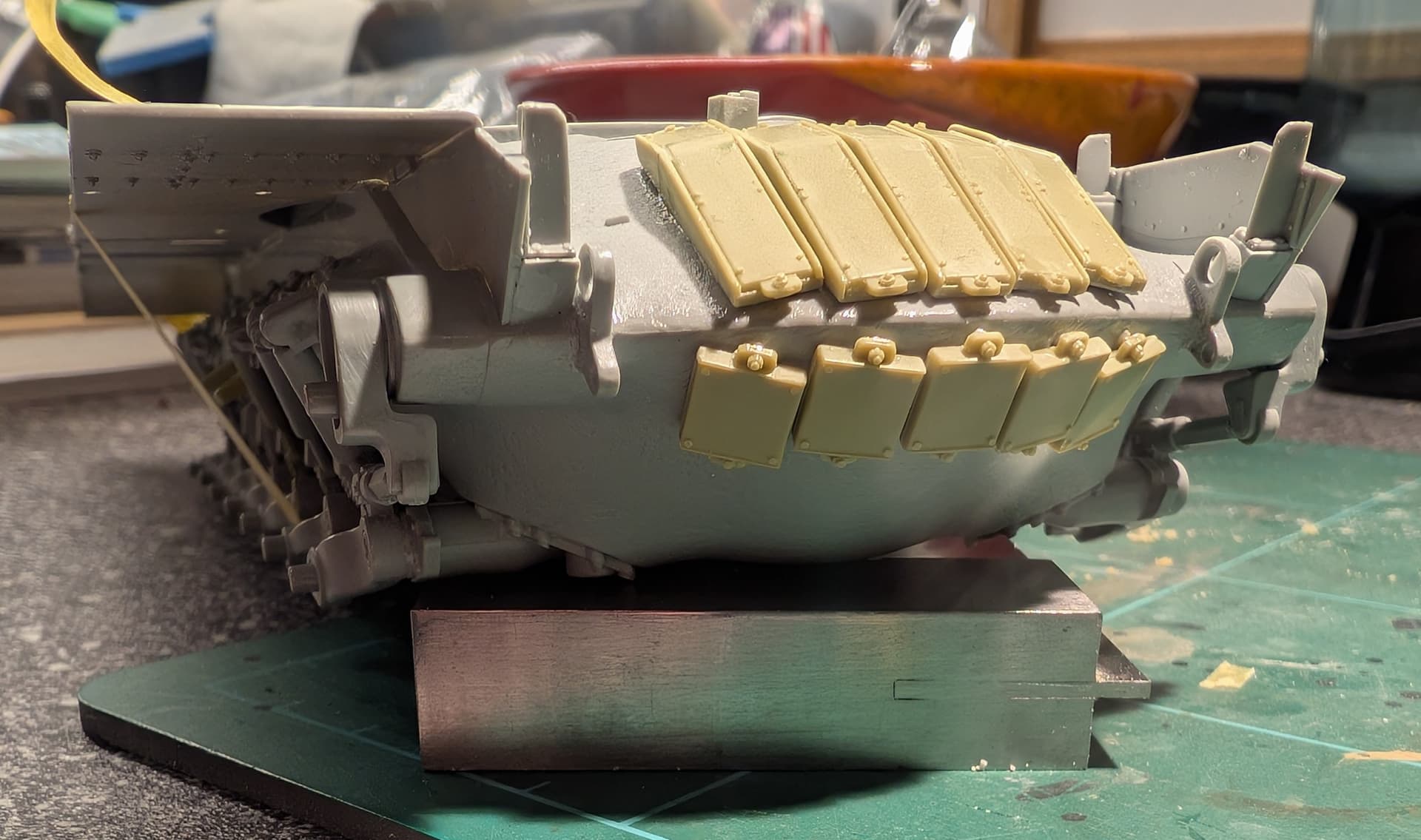

Back again, during the last evenings, I have been working on the Blazer ERA bricks in front of the commanders hatch. All are now glued, which then means, the difficult ones behind the commanders hatch need to be installed. Difficult because of the curvature of the turret. I might have to scratch a few blocks. Oh well

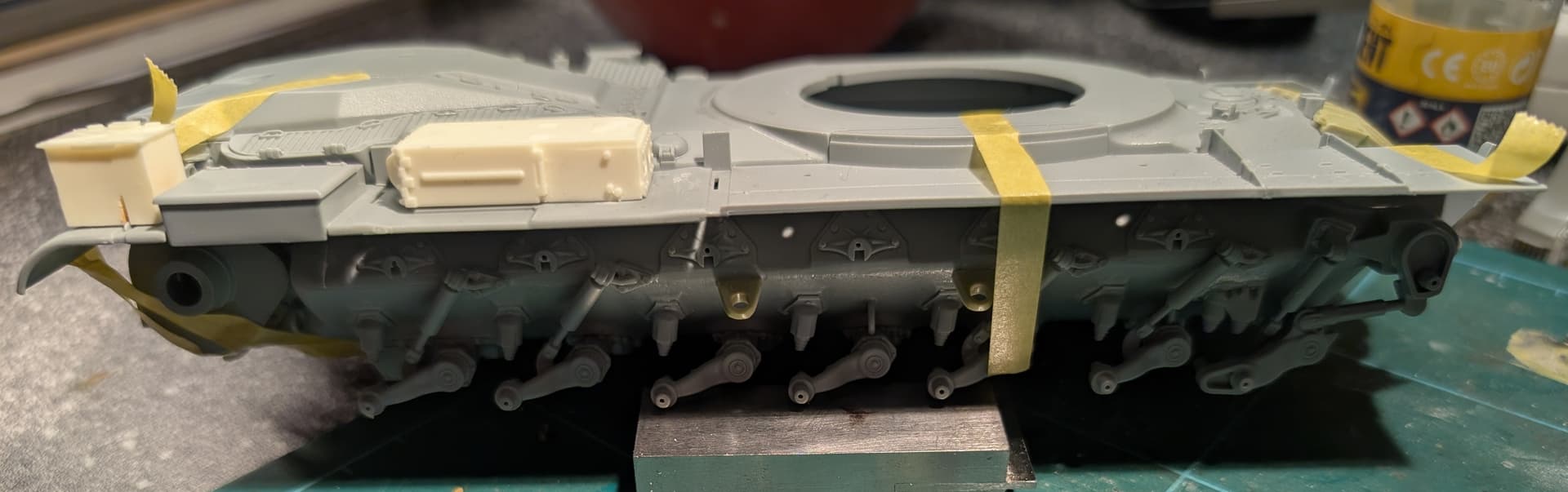

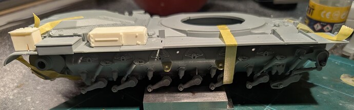

It has been a while, since I updated this article, but it is beginning to look like a tank :slight_smile:
The cream coloured parts are from an ancient Legend conversion kit, see above. The air filter housing will be detailed with Elefant 3D-printed details.
Merkava tracks from Friul with a 3D printed drive wheel from Quickwheels.
