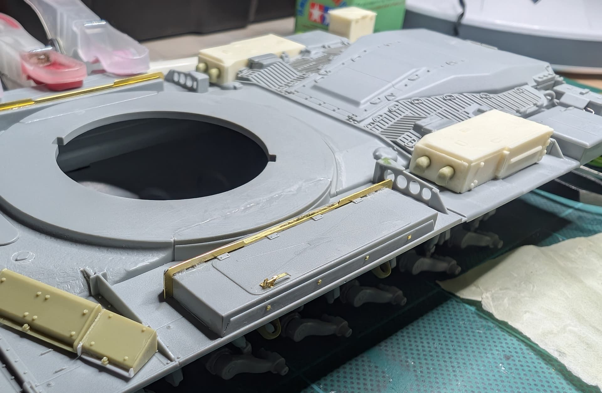

It’s been too long since my last update. This kit stays with a friend of mine, so I only build on it, when I am at his place. Yesterday I worked on the fenders, left side was attached, and the right side got more parts attached. Turret is just on for show. It is slowly beginning to look like a tank :slight_smile:

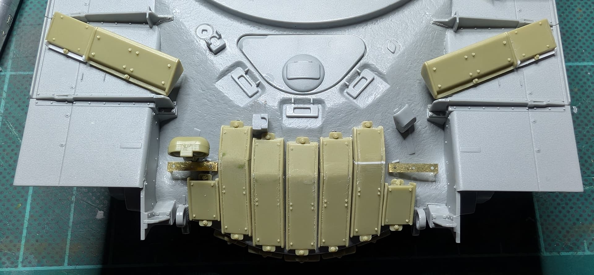

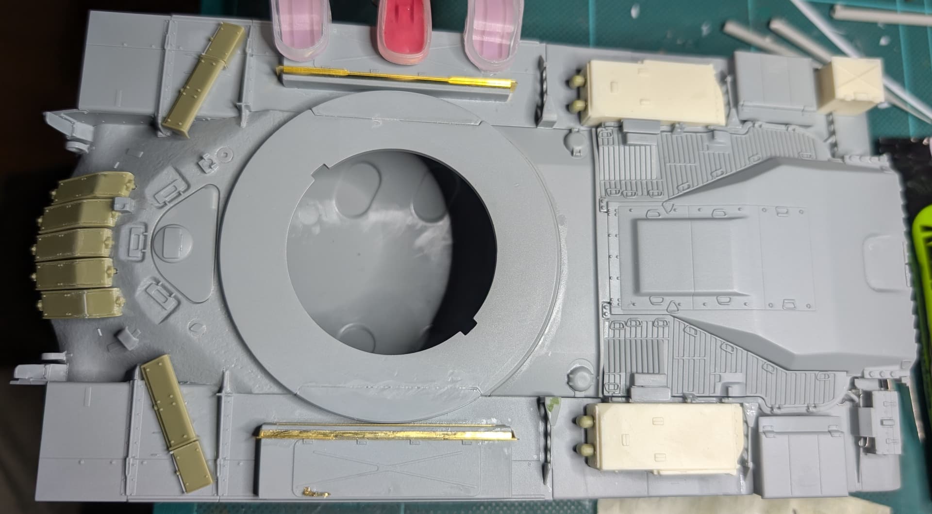

Time for another update. During the past month, I have been focusing on the hull. The etched parts are from the Yoyager M103A1 set. I had to remind myself several times, etched parts are fun. There are all in all 8 handles for the four fender boxes. Oh well… :slight_smile: :roll_eyes:

Thank you for your interest. It is a very rewarding though also demanding project. I really like these mixed media builds, where every part is assessed in relation to its ability to provide that extra detail.
And on a side note. Just because an etched part is provided, doesn’t mean it makes sense to use it :roll_eyes:

One of the things, which I had not considered before I began this project is how long time it takes to adapt parts for use on my model. An example, the two Balzer ERA blocks on the fender. I can see in pictures of the real thing, that the blocks are not flush with the fender, there is a short (1 cm is my guess) distance between the block and the fender. So I have to compare the distance, cut a piece of plastic card in the right size (it must not be visisible) and then glue the block to the fender. The small block next to the large one was right for the size, but not similar to the large one. So I have to make it look like the large one. The same goes for the blocks on the front hull, and of course the turret.
Also, since the Dragon M103A2 kit is such a POS, I also have to consider every part from that kit. How faulty is it, can I find a substitute, will the faults be seen, when the model is finished, and are there alternatives?
The Legend resin parts are the easy ones in this equation. They just have to be cleaned up and attached. Oh well, we do this for fun :wink:

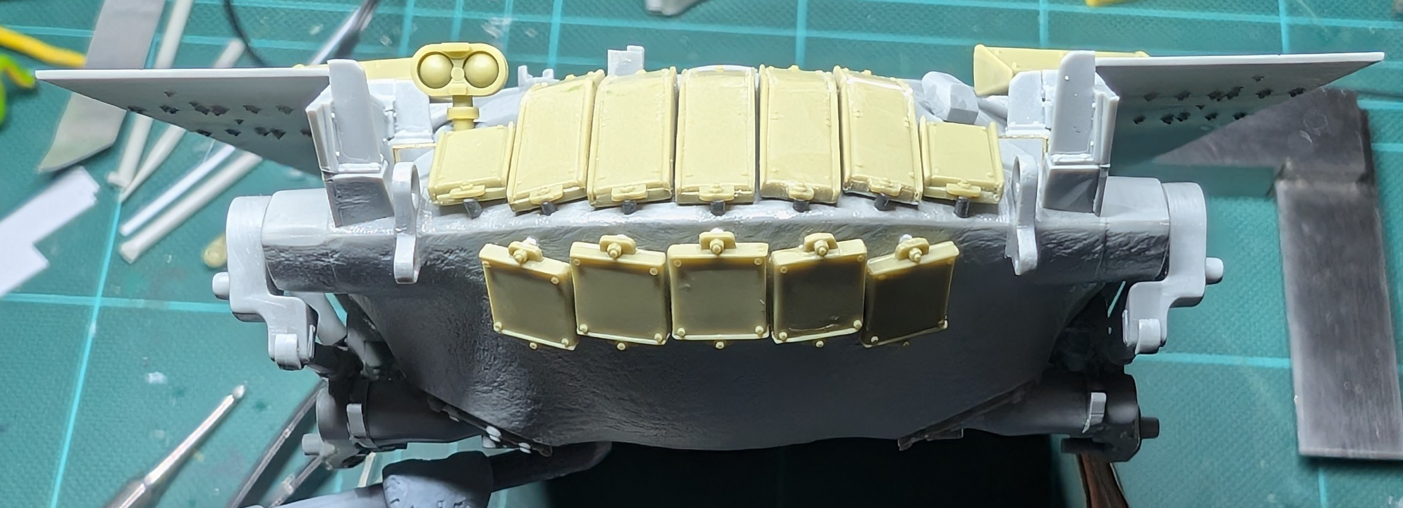

The two rows of Blazer ERA bricks are now complete, and the base brackets for the front lights are in place. So far, so good. The front light you can see, is just blue tacked on, its final destination is of course the bracket.
Next step is the rear of the hull, more etched brackets and handles. Etched parts are so much fun :wink:
