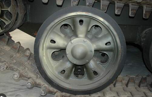

Worn smooth

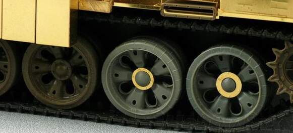

How much would be possible to see on a 1/35th scale model?
This is WAY too much
Barely noticeable on the nearest road wheel
More visible

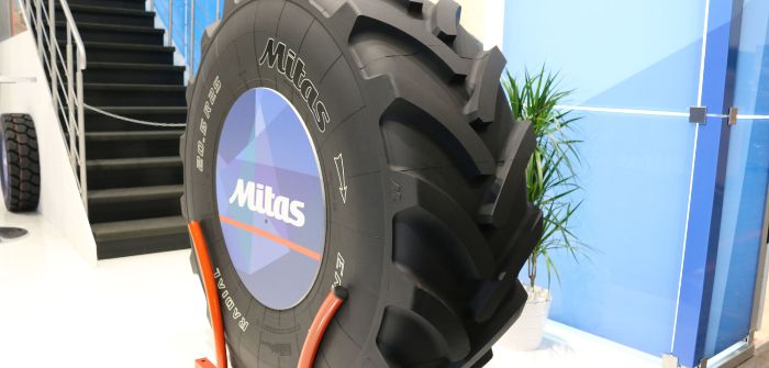

Tire for a loader/tractor
https://www.tiretechnologyinternational.com/news/new-tires-news/new-mitas-wheel-loader-tire-increases-efficiency-for-farmers.html
Trelleborg 23.5R25

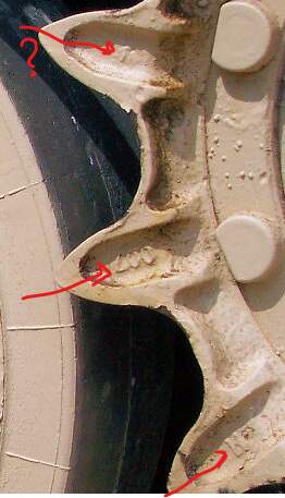

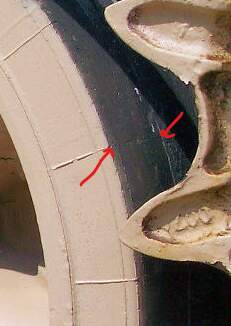

This photo is from the first page of the Enigma collection.
Note the very faint traces of the ridges on the running area of the nearest road wheel.
Should be invisible in 1/35

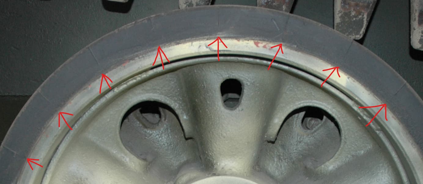

This is also a recurring area where people think they are outsmarting everyone else by leaving the kit’s mold seams on the tires because “real tires had seams!!” Kit seams taken up to full size would look like the flanges on railroad wheels.
I have measured these tire seams. In full scale they stand above the surface less than the thickness of a US dime. In 1/35, they would be equal to the thickness of a coat of paint.
