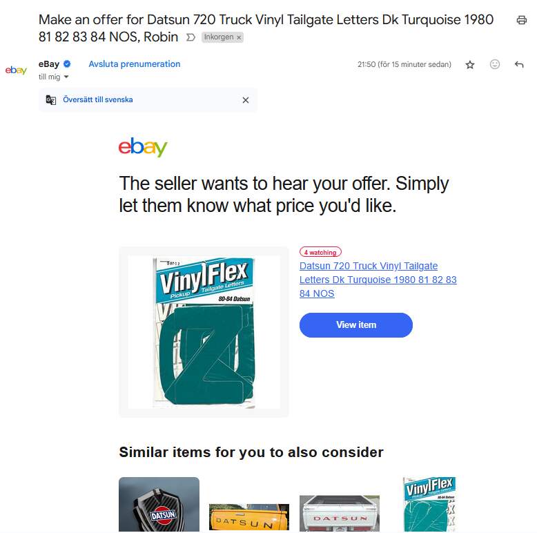

Anyhow, one of the answers was a link to some kind of vinyl letters, I clicked the link
and came to an ebay-page informing me that it was sold out. OK , whatever, onwards
on my quest. This was a few minutes before I posted that white tailgate, later edited to
include the red toy truck.
Lo and behold, 25 minutes ago I got an email from ebay asking me to ‘make an offer’
for those vinyl letters. The almighty algorithm at work again, never ever let a customer
slip away without making an effort to lure him in.
Link to letters, in case someone feels prompted to ‘make an offer’:
I suspect that these letters may not be from the correct years, hard to tell when they are jumbled up like that.
According to what’s written on the package, they’re for a 80-84 model…( the “N” is different on a 1976 model )

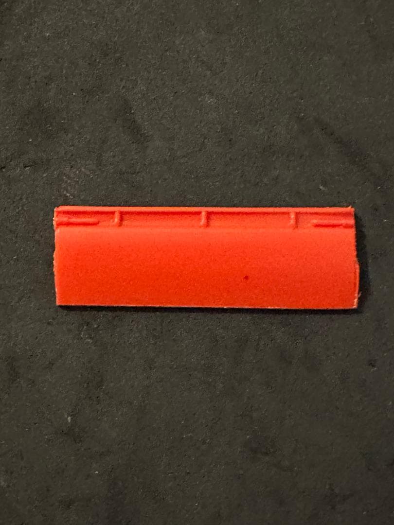

You can replicate the embossed or raised areas using TinkerCAD. Embossed areas are done by turning the embossed area details into “negative” space which will subtract that volume and shape from the base, “positive” shape.
My approach might be to make both areas, inside and outside, as simple rectangles (about the same thickness as the kit part (or maybe a tad thicker). The inside rectangle with the embossed ribs would start out as a “positive” rectangle onto which a series of “negative” smaller vertical rectangles would be added. The result would be a rectangle with “embossed” areas that are rectangular shaped.
The outside area would be done the same, start with a rectangle and “scab” on the Datsun logo script after importing it as a .svg (converted from a .jpg or .png - there are free converter apps that will give you a number of conversions without having to pay or download). Turn the script into “negative” space will again “subtract” its volume from the base rectangle.
Make the base rectangles sized so that the corresponding areas of the molded tailgate can be cut out - retaining the surrounding tailgate structure. Fill the cut out areas with the 3D printed inner and outer rectangles, fill the surrounding as needed.
With careful measuring, it might even be possible to print the inner and outer rectangles (with the embossed areas subtracted as described above) vertically, back-to-back with the correct amount of thickness to insert through the cutouts and fill the inside open space to make it easier to glue in the new pieces.
However, I think that it would be quicker to make the new pieces separately and use wedges inside the tailgate between them to help hold them in place even with the molded kit part surface.
With regard to creating the initial .jpg, I’d import an image from the interweb and then open it in Photoshop. Skew and resize as need to create a regular rectangle out of the script area, then crop. Convert the image to B&W and then use the eraser tool to eliminate everything but the letters. Save as a .png.
Browse the interweb to find a convenient free files converter app that will let you convert the .png into a .svg. TinkerCAD will let you import that .svg into a project so that it can be manipulated like any other shape.

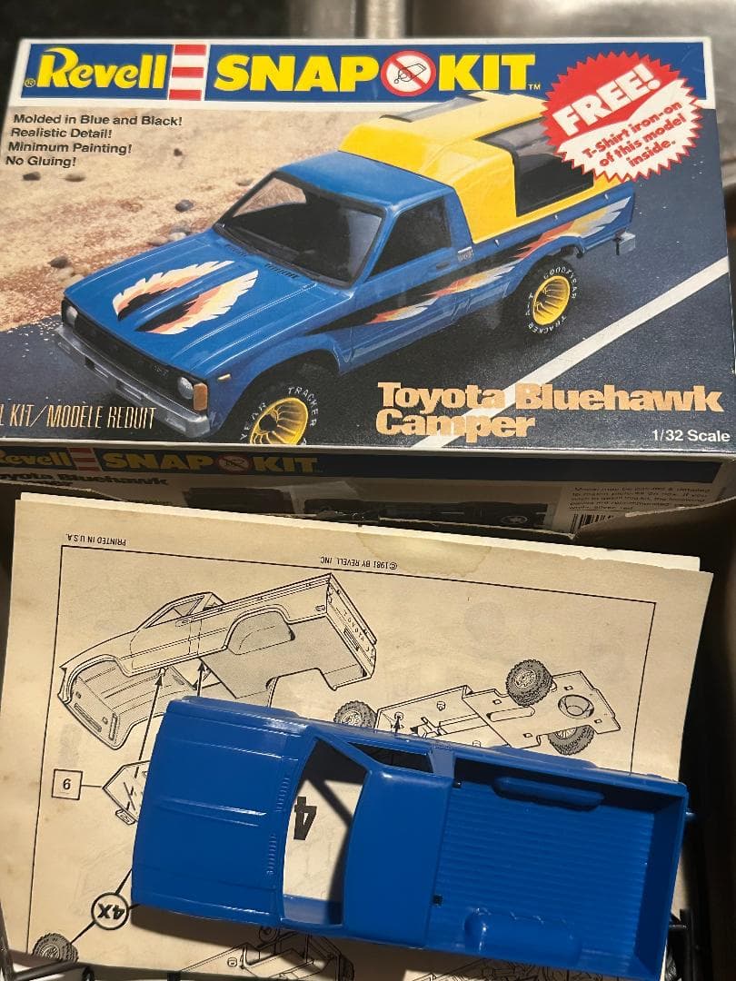

I’d just build a Toyota instead and be done with it.
The Datsun kit represents the Datsun in the photo above in this thread.
When I want to build a Toyota -
I’ll use a Toyota kit:
And when I want to build a Stepside Chevy -
I’ll use a Stepside Chevy kit:
I know, I’m a little funny that way. :sweat_smile:
