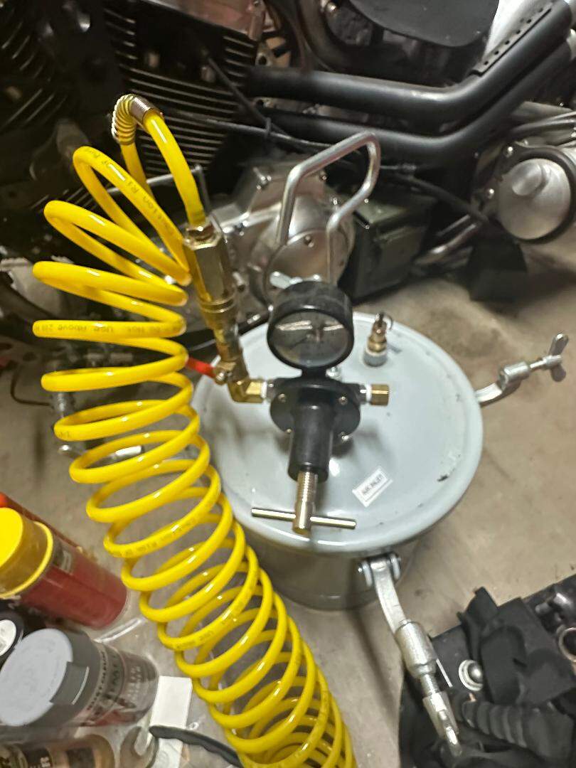

Yes Michael. The castings can best be formed in a pressure pot like a paint sprayer bucket. After forming the Alumilite resin can be cut with a saw, filed and painted. Here is something I tried using a LEGO box to form the silicone mold.

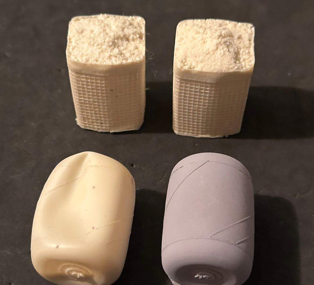

You can see here some of the things I’ve cast dozens (fuel bladders) and hundreds (HESCOs)
of times with the RTV and they’re still holding up very well.
The squashed bladder is not a mistake - I hollow cast them so I can heat them with a dry and show them being used. Works for HESCOs as well if you want to show a divot from a vehicle strike. The photo also illustrates why it’s crucial to build a pressure pot - there are absolutely no pinholes in these castings.

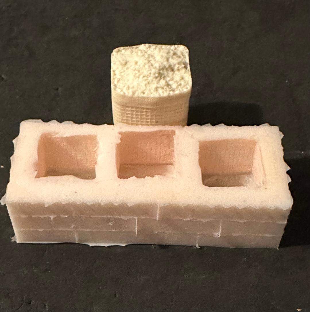

I also do the smaller ones - here’s the mold for comparison to the larger HESCOs. Way better than the ones at model models n the dark brown resin.
