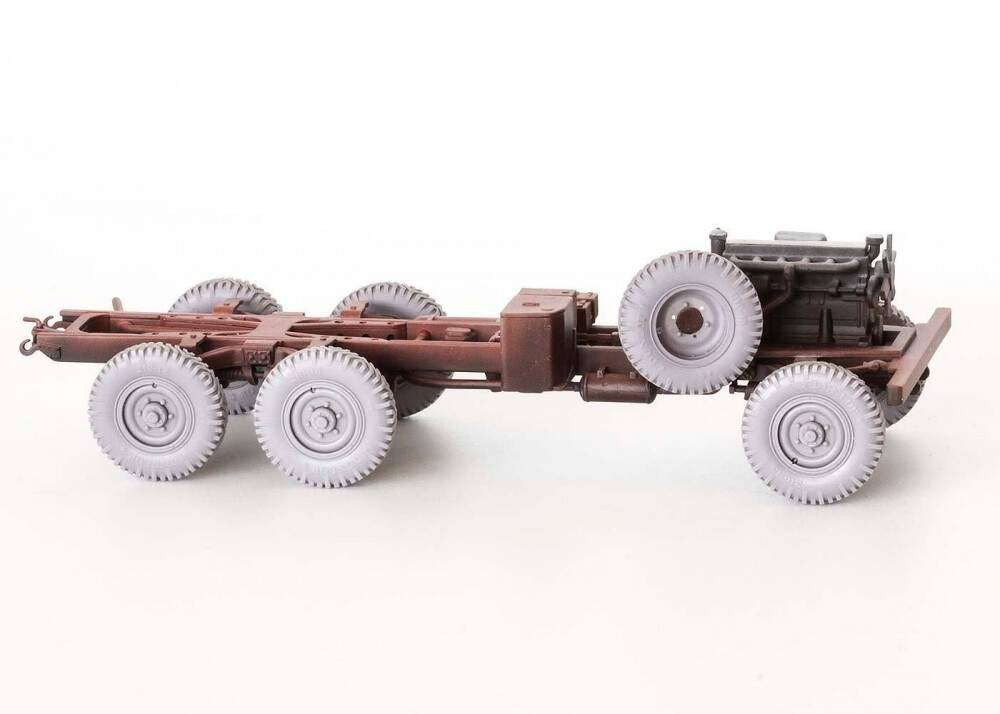

Hi Chris:
This might be a start to working out the chassis:
A build Blog:
A significant amount of work ahead. It may be better to use what you have as a disassembled vehicle dio.

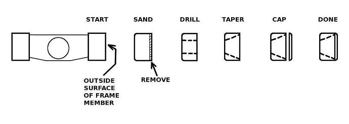

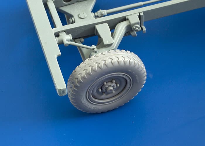

If I can interject something here that might help: The frame on your vehicle is a box girder construct rather than the more typical “C” channel designed frame.
I encountered a similar problem with the Tamiya Steyr frame and I wanted to make it more correct.
Here is my solution:
(It was a bit of work but I was very satisfied with the result.)
