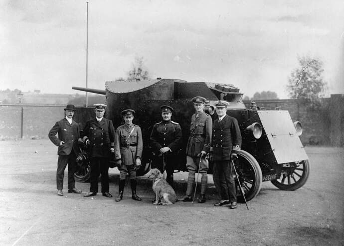

While looking I also found this photo of the Pierce Arrow Armoured Car, also built by WG Allen, with Royal Navy and Russian officers stood in front. Seems to be the same works yard as the Ford was photographed in.
Link to the photo and description THE RNAS ARMOURED CAR DIVISION ON THE EASTERN FRONT 1915-1918 | Imperial War Museums
Now this would make a very cool model! Hoping CSM will do it if they continue with their armoured car range.
