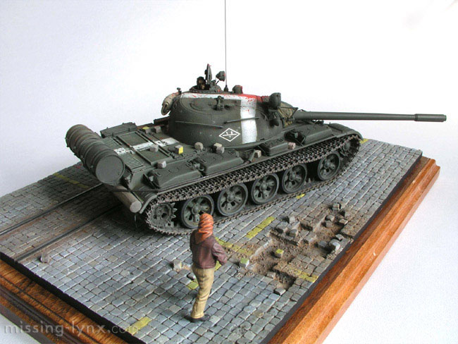

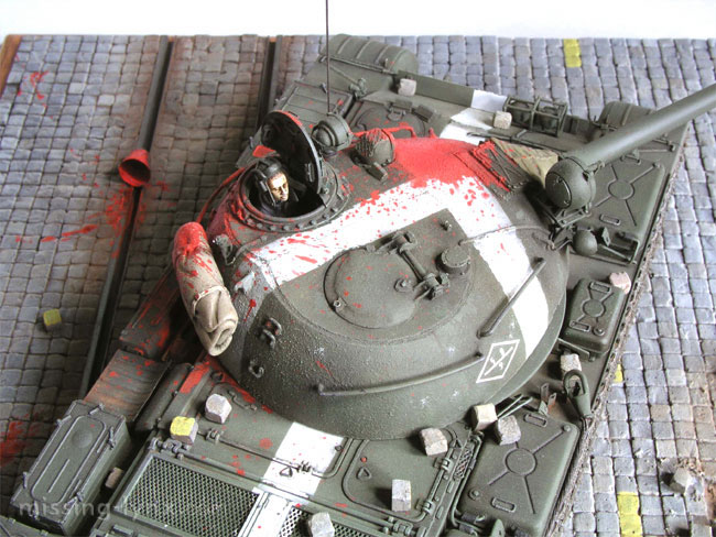

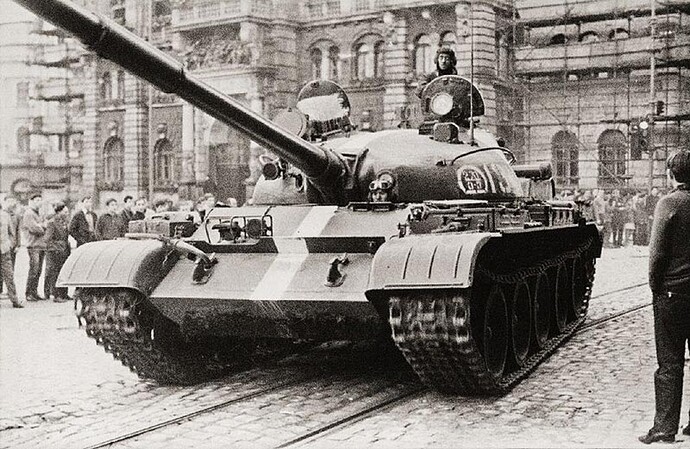

John Tapsell, very good pictures and an outstanding model that you have built. Perhaps more attention should be paid to this political event in model making. One cannot find many built models or dioramas on this topic in model building forums. Many model builders have no connection to this topic either, as they did not experience this period due to their young age. But here too, soldiers and civilians sacrificed their lives. Hermann, in response to your question about which T-62 tanks they were. They were the first generation T-62A tanks, which had only just been introduced in 1968. You can tell by the old tracks, the old rear plate, the mudguards over the drive wheels like on the T-55 and T-54, and no anti-aircraft machine on the loader hatch. Here are some more pictures.

Joachim, you make a good point, but I suspect that most modellers just build for fun, as opposed to education.
However, as the Cold War was my War, I do tackle the political side, or try to. My fairly recent rendition of the Berlin Wall 1961 is one such effort, others, admittedly are in the pipeline but I hope to encompass the 1953 East German Uprising, as well as several vignettes depicting the Inner German Border. The trouble is, other projects keep getting in the way!

At the time the original 1961 model was about the only one fielded. These would have some of the small changes that were incorporated in 1962, 1963, and 1965 but are hard to discern in photos. I looked through a lot of photos when building my T-62 a few years ago and I don’t recall seeing many, if any, 1967 models with the revised engine deck. So, as mentioned, the first Zvezda kit, I think 3622, would be a good choice.
