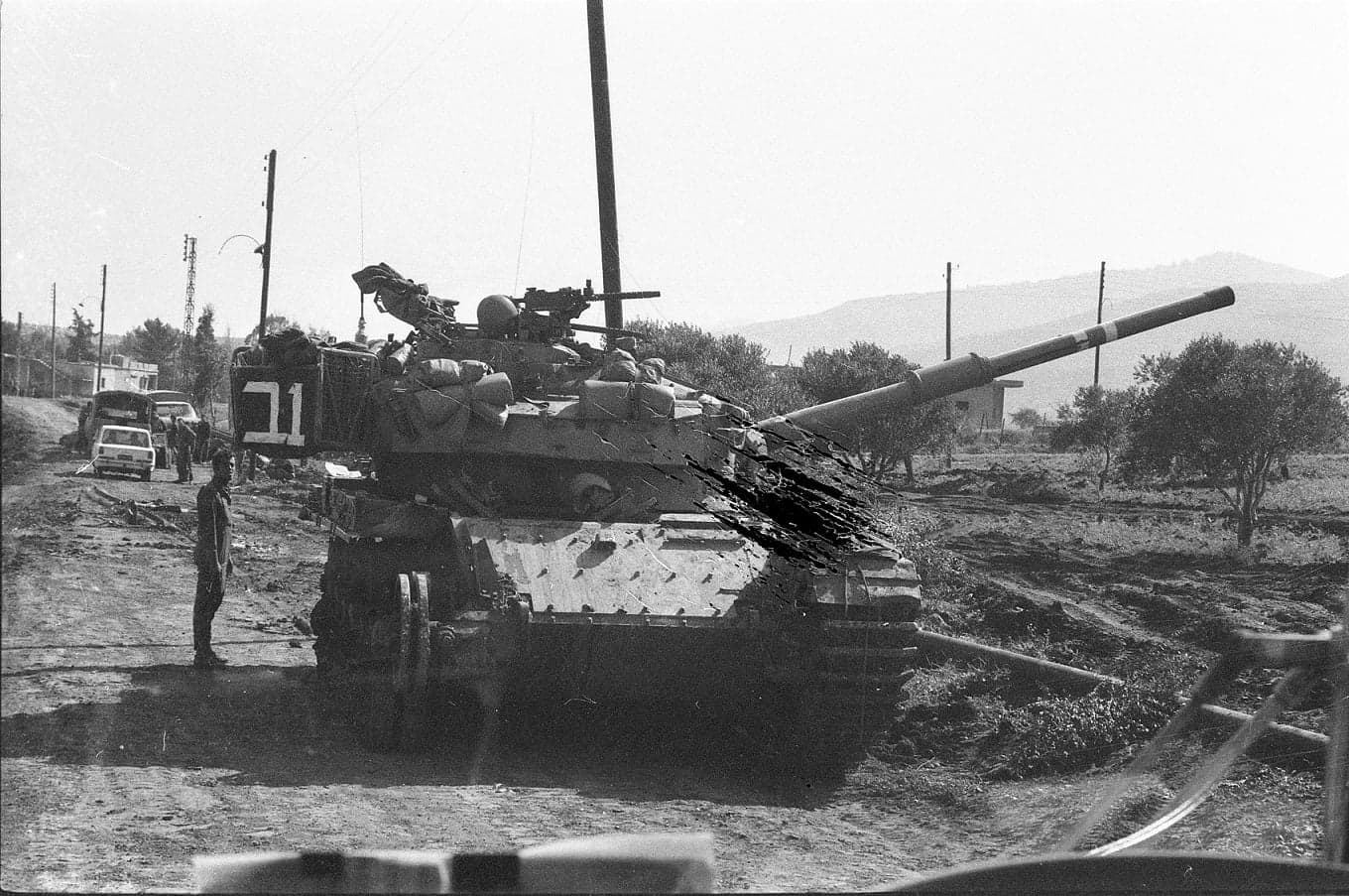

early 1975
This is supposed to be one of the first Magach 6 with ERA, M48 would receive the upgrade during the same period
Check Tamiya TS-46, I have seen people post photos saying that they used it but have never used it myself so I can not confirm it is 100% accurate.
1975? Interesting. Less than two years after Yom Kippur War a countermeasure is developed.
Were any of the IDF tanks involved with the 1978 Lebanon Incursion equipped with the Blazer ERA?
