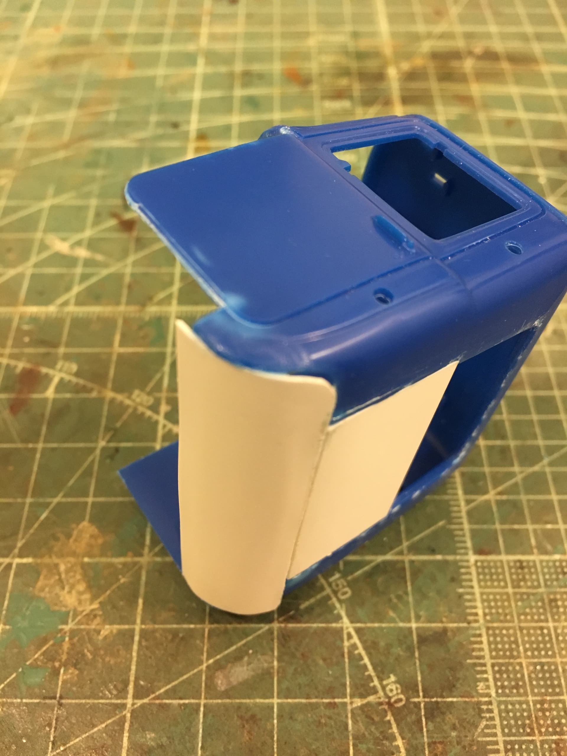

the idea is to create a model that represents the trucks as used during the 1982 operations in lebanon
the aef kit is an entire mess in terms of quality and measurements
the solution was to correct and salvage as many parts as possible
and to scratch build all the other parts and components that can not be used nor salvaged
the project started by converting the blue cabin from the monogram kit
separating the engine cover and rear sleeper unit by use of hand-saw
then closing the large opening at the rear end with a styrene sheet
next is re-creating a correct engine cover that represents a DM800 series based on actual measurements and drawings and references (thank you Paolo)
the chassis was badly wrapped and twisted and bent, a quick fix was dipping it in boiling water for a few seconds and aligning it to a satisfactory result
next is scratch making the front and rear leaf springs
more updates will follow shorty
enjoy and happy modelling

current project update
chassis extended to have a total of 26.5 cm
cabin completed and painted and sealed
the reason the cabin was done first is due the DM conversion parts that require to be fitted in place after the interior has been fitted
next is sanding the parts and engine bay construction along with the top engine cover sheets
