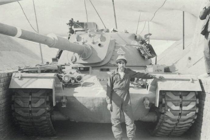

Did they have the 105mm gun in '67?
Ken
Before the Six-day War (1967)
Israel made an application to the US in 1955 to purchase 60 M47 tanks and after the US refused, Israel applied again in 1958, this time to purchase 100 M47 tanks but the answer was the same.
In the early 1960’s, Israel signed a deal with West Germany, for the purchasing of 150 M48A2. However, due to strong Arab nations opposition, out of the 150 tanks planned to be delivered, only 40 did Israel finally receive. Since West Germany didn’t fully fulfill its obligations, the US had decided to supply the remaining 110 M48A2 tanks and to add another 100 M48 tanks. In 1965, Israel received 90 M48 tanks from the US and another 120 M48 tanks in 1966. At this time Israel had 250 M48 tanks, 150 of them M48A1 and 100 of them M48A2, all of these armed with a 90mm main gun.
Israel upgraded those tanks to M48A3’s by replacing their engines and transmissions with newer models. These tanks were also fitted with a new 105mm L7 gun (same as on the Centurion MBT) and with the Israeli Urdan cupola. (All Israeli M48 tanks were upgraded to M48A3 by the beginning of Yom Kippur War).

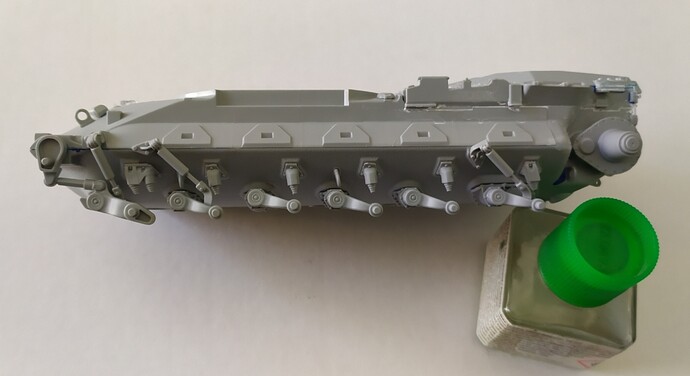

Working on the top hull details and suspension.

Yes they did have a few tanks already upgraded to Magach 3 standard. The issue is that most of the photos have been modified for censorship reasons. You can notice photos where the gun is blurred or the air cleaners are hidden with sandbags by the crews.

I worked on the suspension today, both sides are done.

This is a Magach 3 built on a M48A2. Notice the return rollers, the light guards, the front fender and the fender brackets setup.
Also here notice that the rear engine doors do not have the extra ribs you have on your model
This is a Magach 3 built on M48A1. Notice the differences with the above photos
Again notice the rear doors

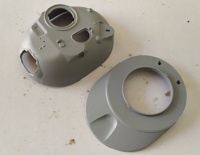

Painting the wheels and working on the turret today.
Worked on the turret today
