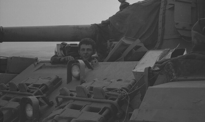

Front headlights of upgraded vehicles are like this:
the original headlights are like this:
The upgraded hulls have a square box on the left and on the rear left of the turret you can see the searchlight mount. These details do not exist on the original vehicles.
