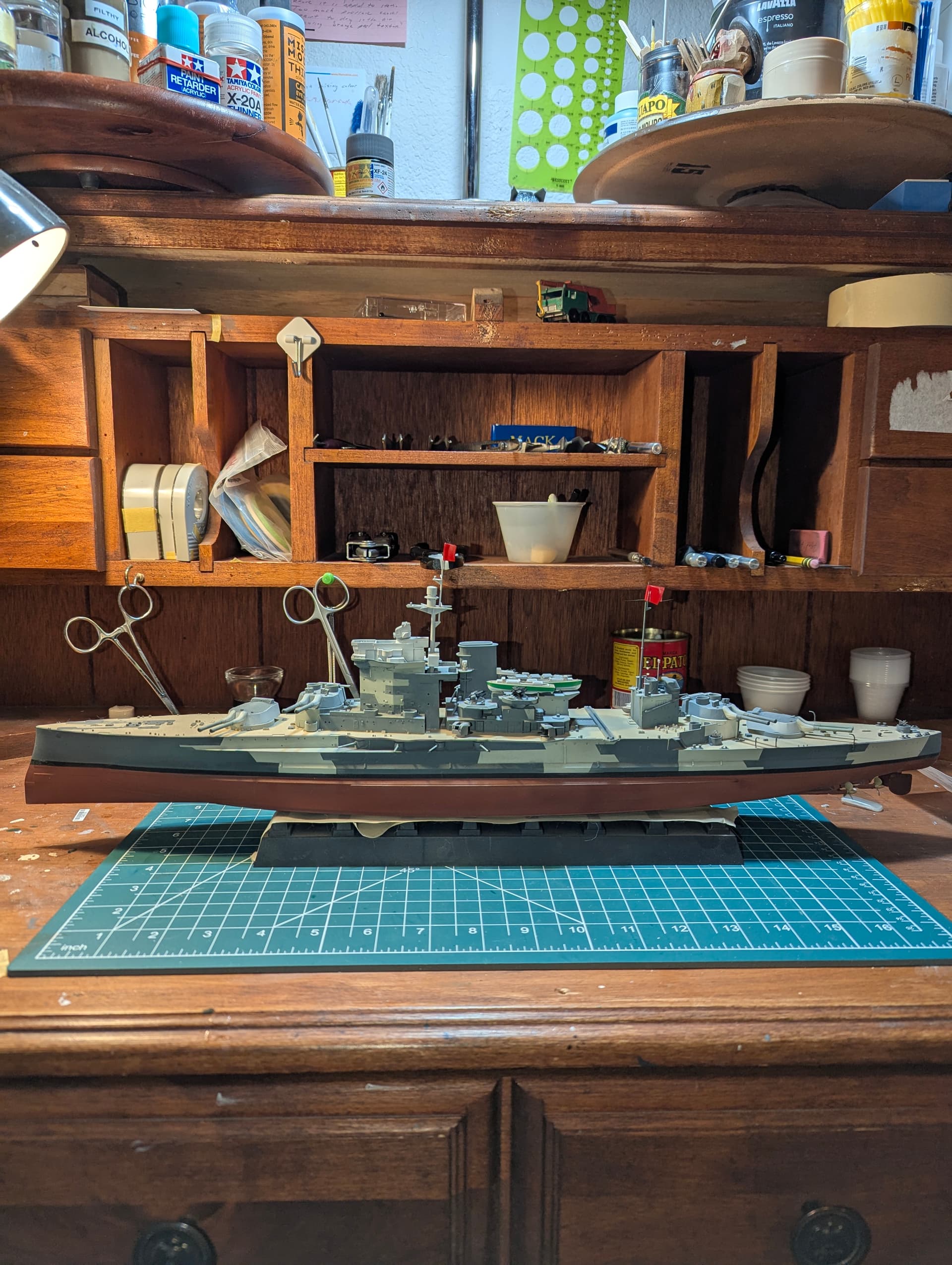

as an old man of 66 years I am amazed by what 3D printing has to offer, I was stalled out on my 1st battleship build for 3 years, I ordered Oerlikon 20mm cannons from HS models they are some much better than the stock parts of my 1:350 HMS Warspite model. This has rekindled my interest in modeling since I was not interested in PE nor do I have the skill or patience for PE. Excellent work you have accomplished.
How is the Kagero build going? your work is very impressive and the build info is appreciated. I have a 1:350 IJN Mogami on my shelf that gives me anxiety issues just looking at it. There is hope for me…I think ![]()

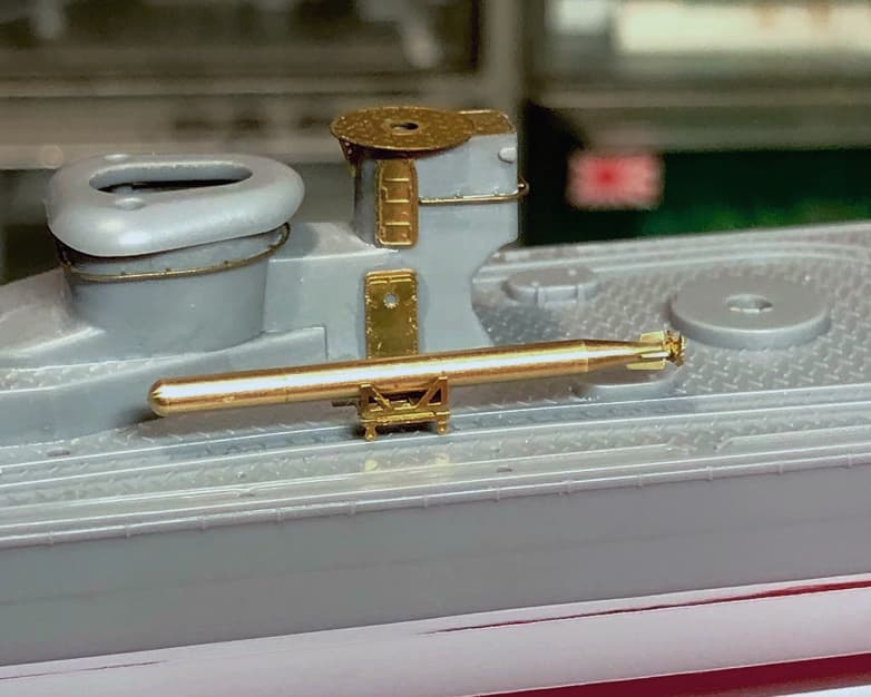

Well into the project I came across Infini’s beautiful torpedo upgrade set with its turned brass fish including etched fins, props, and trolley.
So far so good, but the set also came with delicate trolley rails to replace the clunky parallel rails molded on the plastic deck (you can see them here between the deck edge and the winch). The etched brass rails are stunning, but using them will require removal of all that molded-in track without damaging the surrounding non-slip detail. I am up for this, but facing this tedious task just sapped my enthusiasm.

I have been on a temporary 3 year standstill on a 1:350 Warspite build
problem is I chose the Trumpeter version of this model and not the Academy. Purchased the expensive PE set and found that it is not comparable with the trump kit
standstill meaning the rails scare me as I would have to find a generic product? your work is excellent and I enjoy following your builds, thank you.
Thanks David, I feel a little better with my less than one year break! I’ll get back to Kagero, and I’m confident that, when you are ready, you’ll get back on your Warspite too! ![]()

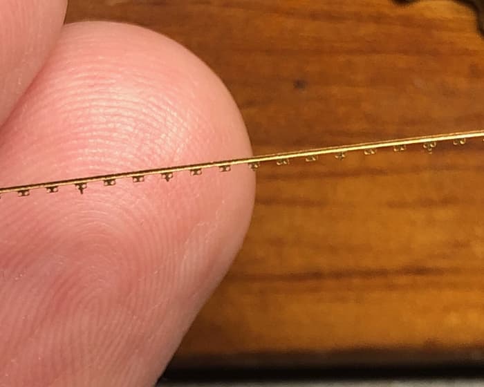

I had previously reached the point of assembling the awesome Infini brass torpedo with its trolley but got bogged down when it came to the torpedo reload trolley rails. The etched brass rails are definitely MUCH better than those molded to the plastic kit deck, but removing the molded track without damaging the surrounding non-slip detail would be a challenge.
I began by carefully trimming the rails with a new X-acto blade.
Then they were gradually scraped and sanded down as far as the level of the raised nonslip surfaces. Though fairly straightforward, reducing the rails without damaging the adjacent molded detail required care – and the rails extend over quite a bit of the deck!
Infini had thoughtfully provided a brass template to mark the locations of the etched rail attachment points.
The template was super helpful in establishing the etched rail attachment points on the tracks; these points were initially marked out with light pricks from an awl.
Once I was satisfied that the awl marks were properly centered on the rails, I used a No. 80 (.34mm) bit chucked into my X-acto handle to drill out the 132 locator holes.
This prep work wasn’t the most exciting of tasks, but the new etched brass torpedo trolley rails are incredibly fine and detailed – I can’t wait to get them aboard!

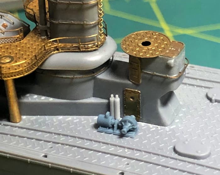

Before fitting those delicate rails this seems like a good time to address a discrepancy that I hadn’t noticed before with the reload torpedo stowage boxes mounted on each side of the forward funnel.
Tamiya represented the long boxes as mounted over semi-enclosed support structures. They were also depicted this way on Nichimo’s excellent 1/200 scale Kagero kit, the beautiful large scale Yukikaze build in Gakken’s Pacific War Series Vol.19 Kagero-class Destroyers, as well as in the Profile Morskie monograph on the Yukikaze… so I had assembled the kit parts without questioning further.
However, the Infini brass upgrade parts represent these structures as more open.

There don’t appear to be any photos of Kagero showing this area, but the available evidence strongly suggests that she too must have had the more open arrangement. It looks like I’ll have to remove the already completed kit assemblies and do them again! ![]()
Thank-you for spotting that Tim and sorry that you’re going a bit backwards. I checked the LionRoar Kagero set and it is also enclosed but, if you have it in your stash, the White Ensign Models Kagero/Yukikaze PE part is a closer match to your references.
Colin
Colin
Thanks Colin, good intel! I haven’t seen the White Ensign set, but having spent waaay too much $ on this build already, I’ll just see what I can do with those Infini parts. ![]()
