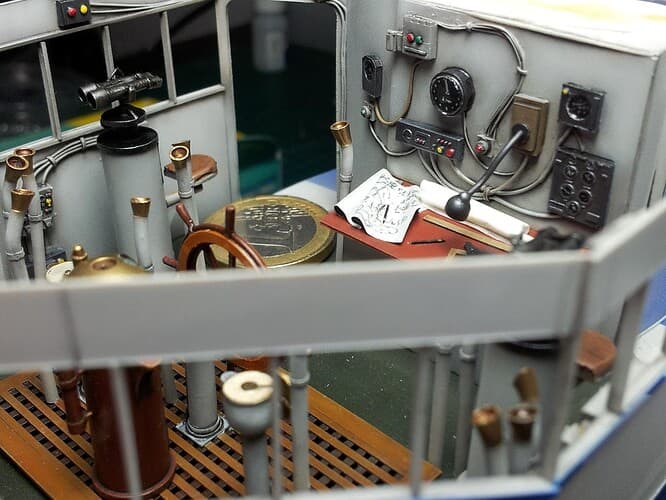

This is a scratchbuilt Akagi bridge in 1/48 scale, l helped with some of the research but I cannot find the reference folder at the moment. I recall spending a lot of time discussing every color detail.
EDIT: The interior was done in light grey as a safe choice.

strong textThank you all for all the help.RTD what little I’ve found confirms your thought that is a range finder. Tim thanks for the help with the paint work. This will be a great help.
I would love to find source material more accurate and comprehensive than Google. I would love to see the “bibliography” used by the builder of that beautiful scratch built 1/48 Akagi. Again thanks guys

It isn’t hard to imagine how difficult it must have been for Admiral Nagumo and his staff working around the chart table at the aft end of this tiny space (also crowded forward with the helmsman and various bridge crew), making critical decisions at Midway…
