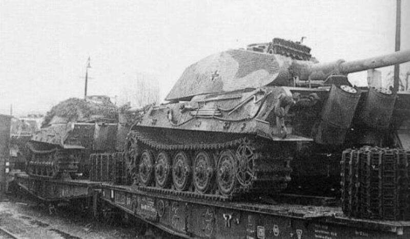

The image Biggles50 posted is of the 506th. The units that received the 50 pre-production turreted Tigers are as follows; 5 to sPzAbt 316(Fkl), 12 to 1./sPzAbt. 503, 12 to 3/ 503, 15 to Heeres Waffenamt and 6 to Pz Ers Abt 500. The 45 Tigers the 506 received were shipped from the “Heeres Zeugamt”, (I assume that means from the Waffenamt?) in August-Sept. and loaded onto trains on Sept.22, bound for Arnhem. -Panzer Truppen, vol 2, page 171. Waffennamt photos anyone? :face_with_raised_eyebrow:
The 3/503 was withdrawn from the fighting in Normandy to be re-equipped with Tiger II (P), but did not rejoin the battle. The 506th did not operate in Normandy. So far, the only photo I have seen of this Tiger variant is the one on the flatcar of the 506th.
