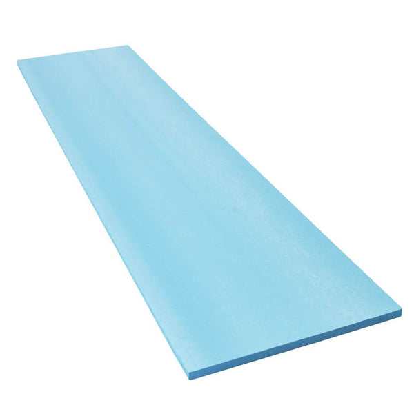

I’m needing some help/advice, i hear you csn make your own walls using insulation foam board and that you can buy it here in the UK.
i alreadu have some but it’s the wrong type as it seems to have like thin layer of ‘hair’ on it which wouldn’t look right when i try to crarve a stone or brick design into it.
can anyone pount me in the right direction for the good stuff, or at least a link to it on ebay, as i want to have a crack at making my own for a change.
kind regards
Klaus
I don’t know what brands you may have in UK, but what you should be looking for is expanded (or extruded) polystyrene panels, usually pink, or blue. They come in various thickness, but most commonly from 1" - 2" - and 4", and 2’ x 8’ in size. I would suggest looking in DIY, and large hardware chains as ordering large sheets online come with hefty shipping charges. Over here, Dow Chemical is a common brand. On U-Tube there are numerous tutorials on how to construct with foam board. Most involve a “hot wire” cutter by Proxxon, or you can make your own (also on U-Tube). Thin foam board (1/4" - 5mm) is also available in 2’ x 2’ sheets as notice boards, but you have to strip off a paper layer (sometimes it’s a shiny plasticized layer).

That is a significant statement. You need the higher density stuff. Also not the ‘High Density Foam’ used for upholstery - I think that is what you may have purchased sounding by the ‘Hairy’ nature.
This is the type made here in Oz:
Google “high density hobby foam board UK” and you will get hits like these:
https://www.amazon.com.au/Fityle-Density-Building-Architecture-Diorama/dp/B08MKT2RC2
that blue foam board looks like the stuff i have already, i will check the rest of the sheets, maybe i have a bad batch?
