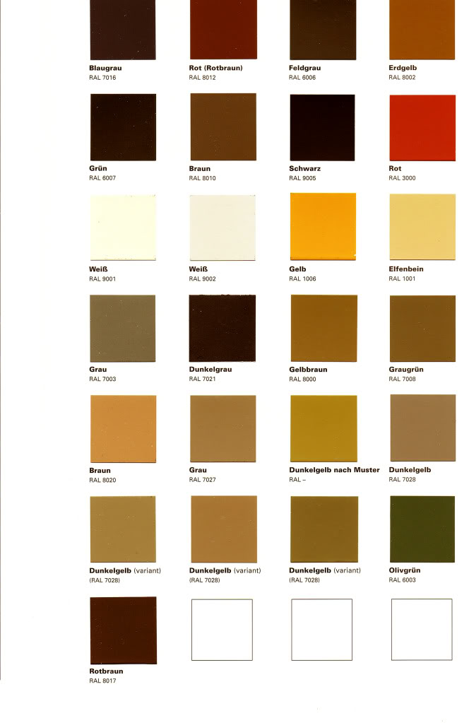

Is this actually the modern RAL system? Sorry, don’t have my color charts up at the moment.
Here is what I have, although not complete.
It is a primer but I have never seen it mentioned in conjunction with military equipment. It could be more common to civilian equipment.
RAL 8013 (Schiffsboden Farbe Rot #5) replaced RAL 8012, and was listed in the Genormte Anstriche and added to RAL Register 840 R, sometime in the Spring of 1942/3.

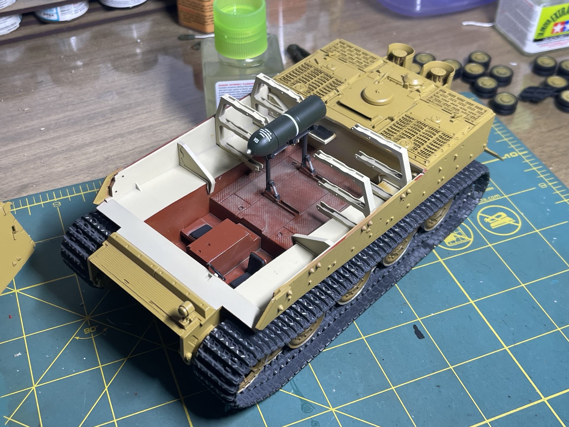

That’s how i painted the interior of my Tamiya Sturmtiger (except mine didn’t come with a radio set).
