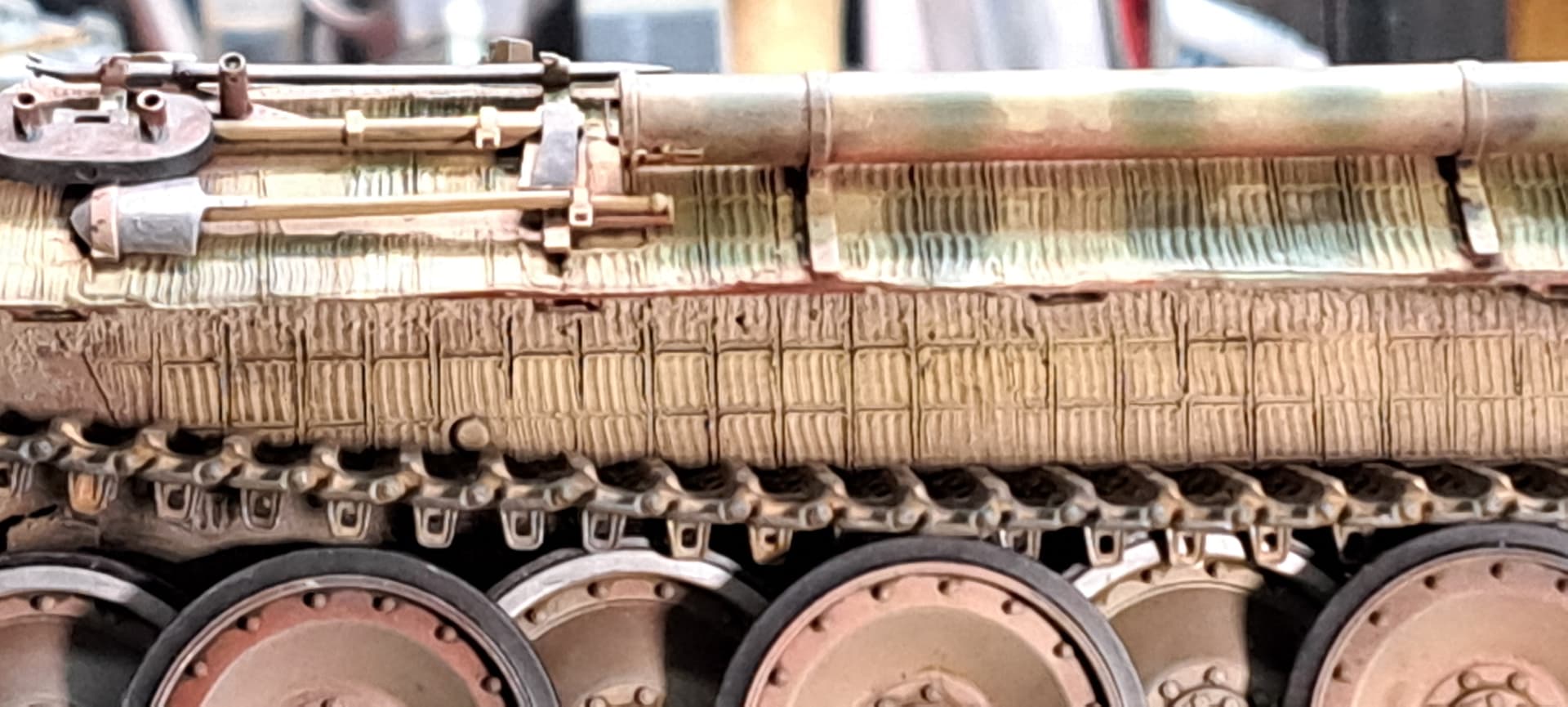

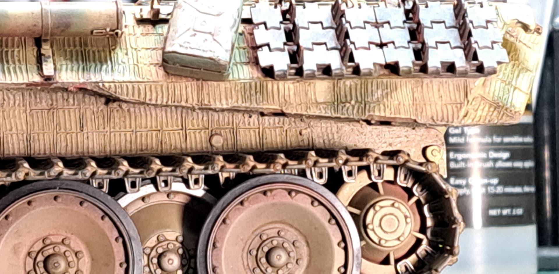

The tracks were test fitted to my satisfaction before painting early in the build but quickly ran into problems.
  1. Discovered a fit issue due too few paint & marker burrs on one sprocket.
  2. All of the airbrushing and multiple washes caused the articulation of the track links to be very stiff.
Easy to fix, removed burrs and articulated tracks until they moved freely.
Italeri sprockets, Ryefield idlers, Model-Kasten Wheels & Sector35 tracks.
Obviously, still needs some tweaks etc but at least m at last the tracks are on!

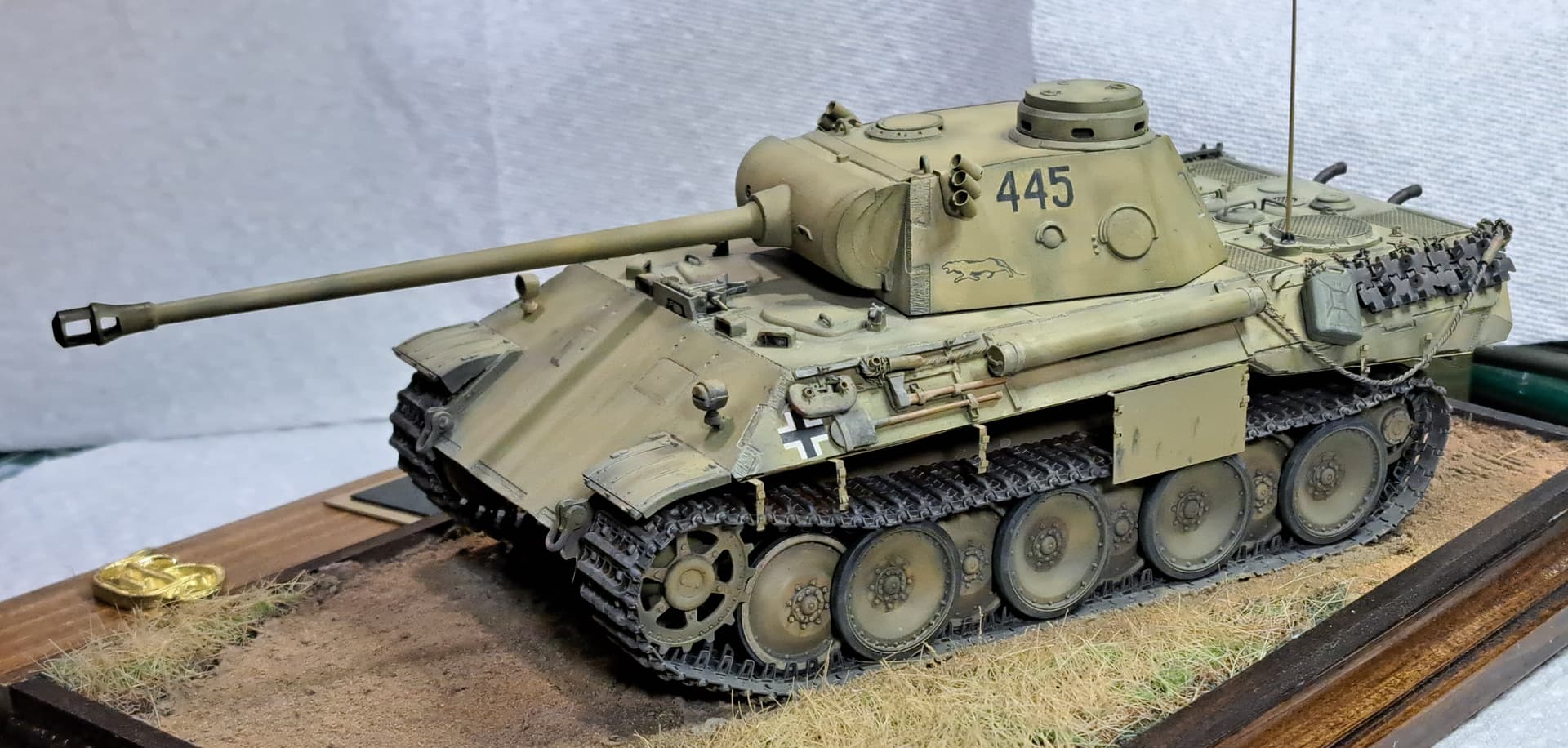

Of all the new (2015 forward) bells and whistles Panther kits, the Meng Panther D & A are the kits that I want to build the most. Meng’s Early Panther A wins by hair due to the box art…
…swap on a steel drump cupola, add command antennas make the most awesome looking 267 befehl Panther A
Like this one at the MAN factory…
Ok maybe not the most awesome ^ but darn close…

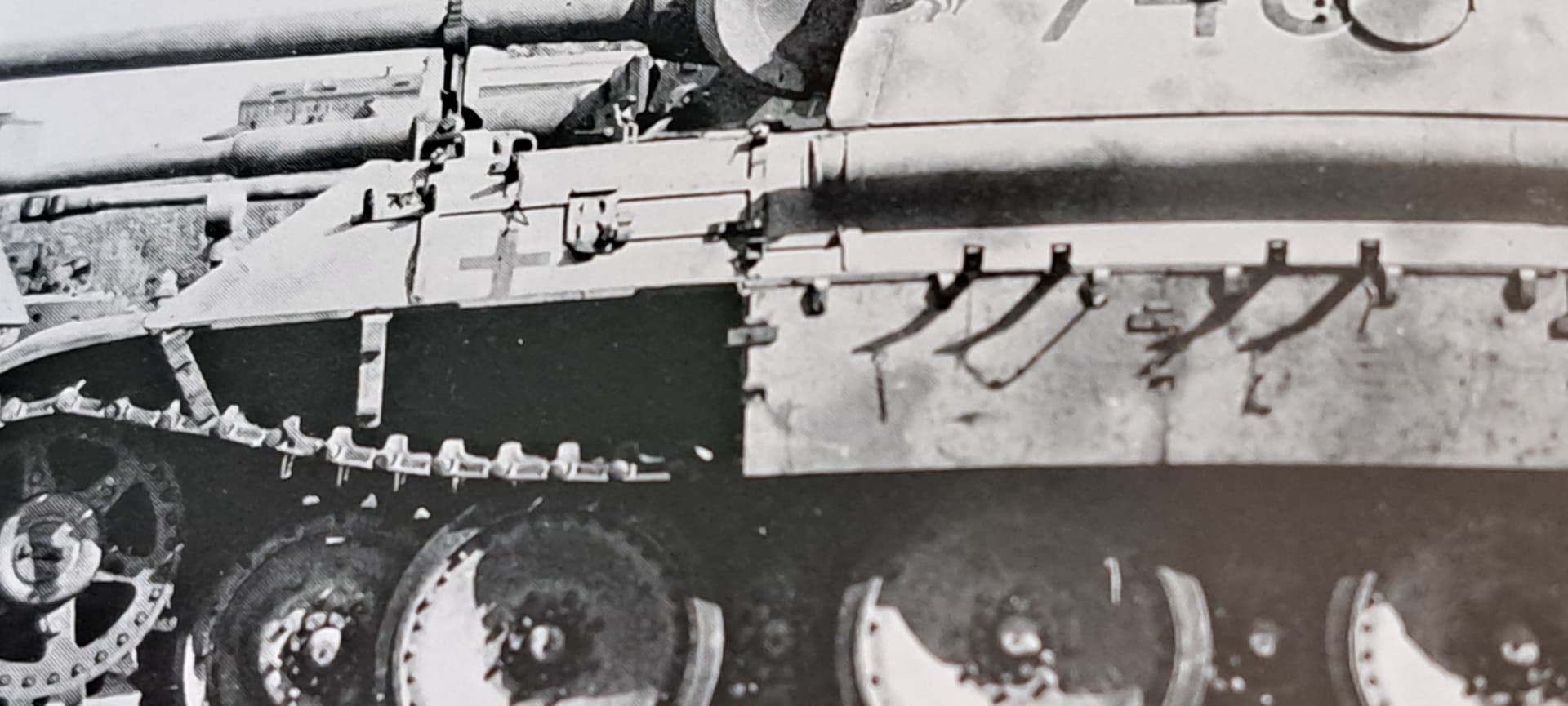

Dreaded the Day of the Sideskirts but it’s arrived.
First idea, use the leftover parts from the Dragon Panther D build since I have 11 surplus skirts. However, the Dragon skirt hangers do not match the Eduard PE skirts. The hangers can be modified to work, as I did one but the plastic hanger is too thick and looks stupid with the PE.
Second idea, use another Eduard PE Panther D/A skirt set w/PE hangers. I failed to find another one in the stash. I’m a little too impatient at this point to search and order one.
Third idea, bite the bullet and use those On The Mark PE parts for D/A skirt hangers.
Pitty I can’t solder well enough to make the hanger. Each little C has to be soldered into place consistently. I doubt CA for just bonding on the edge.
This stuff is supposed to become skirt brackets like this plus cotter pins and a rear guide?
Seems very unlikely with my skill set.

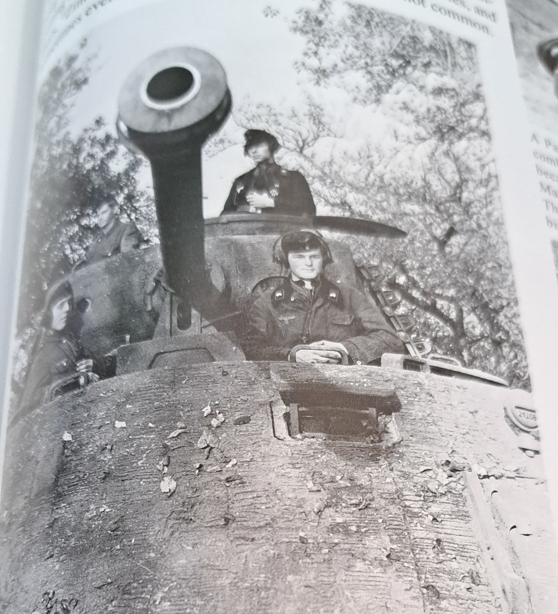

Worse of the worst, time to hit the reference books:face_with_head_bandage: :nauseated_face: :face_vomiting:…I’m not sure if in total it was 4 hours or 8 hours but it was way too much time in any case. It was approaching a Black :hole: Hole in space, one might not escape.
For discussion only etc
Maybe I don’t need all of the clutter on the model.

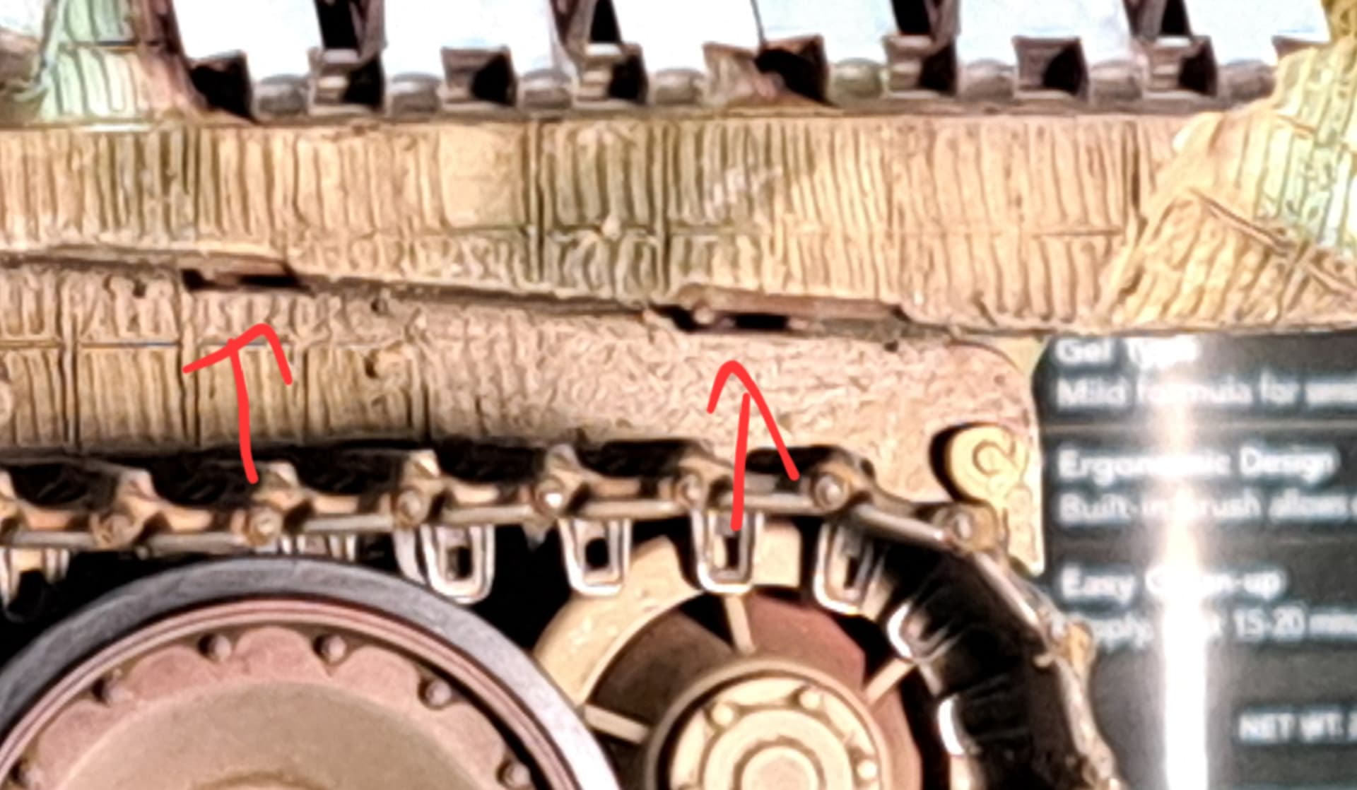

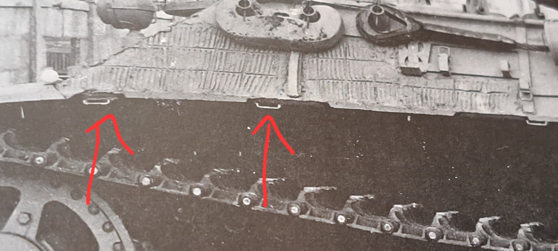

What have here?!
Screw the side skirts and hangers. I’ll use the OTM hanger brackets only. Open and empty will be a nice detail.

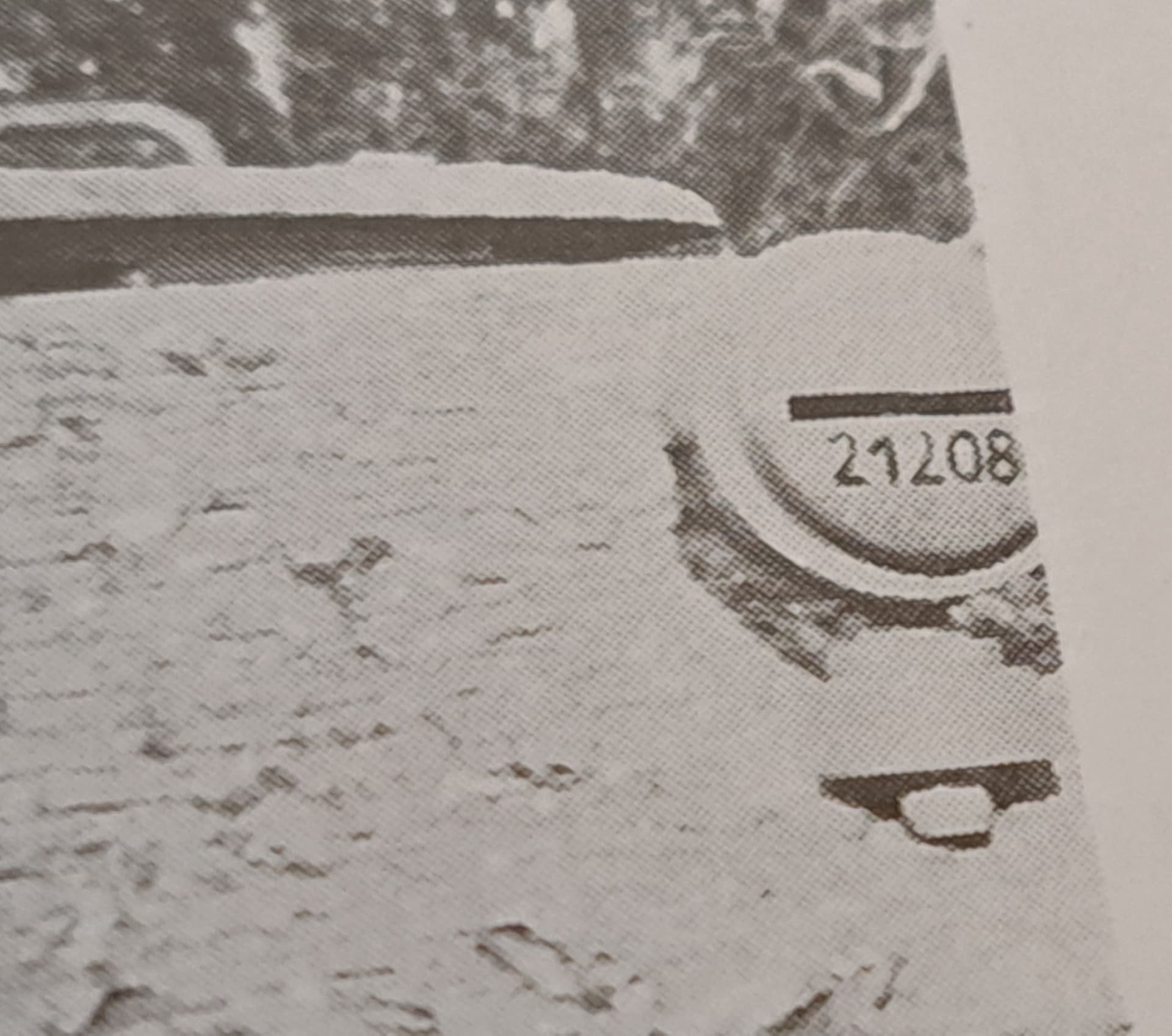

So why do you hate references so much Wade? Because I get “lost” chasing details I find interesting. Example this early Panther D is well-known and was in France etc as a training tank. I have other pictures of it and one day when my skills are maybe adequate maybe I’ll try building it.
Hmmm is there something here to learn…
My that looks like a chassis number or manufacturer serial number (partial) on the headlight! I need to check…other references…
…and eight hours disappeared :sleepy: that’s about 20% to 25% of the time required to build and detail this model excluding paint…
…to chase one detail and find a suitable solution. That’s why I personally hate looking at reference books :books:

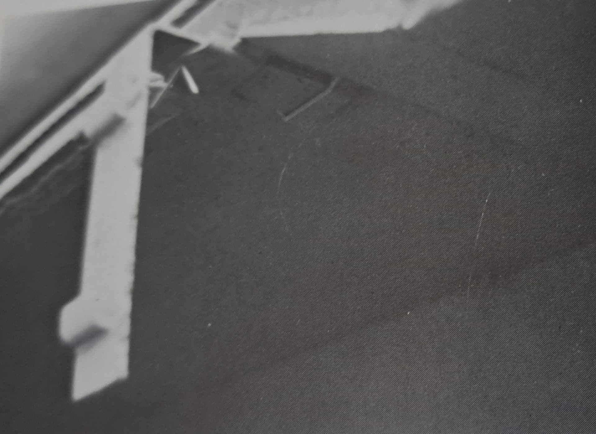

The side skirt bracket cotter pin picture.

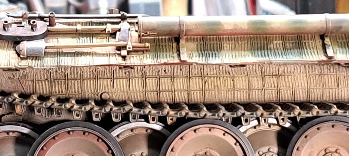

The brackets for the skirt hangers.
That detail probably wasn’t worth the hours it cost…nature of the game sometimes.

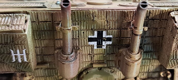

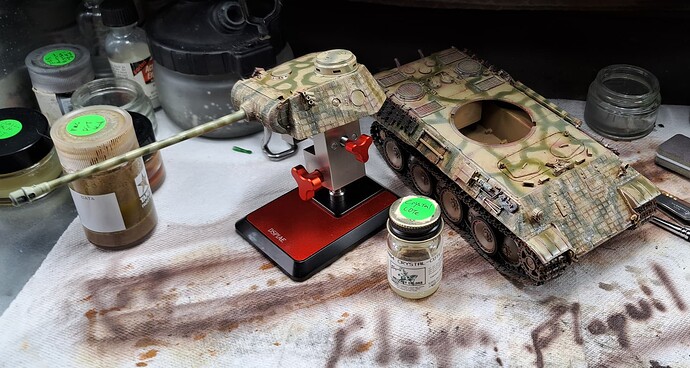

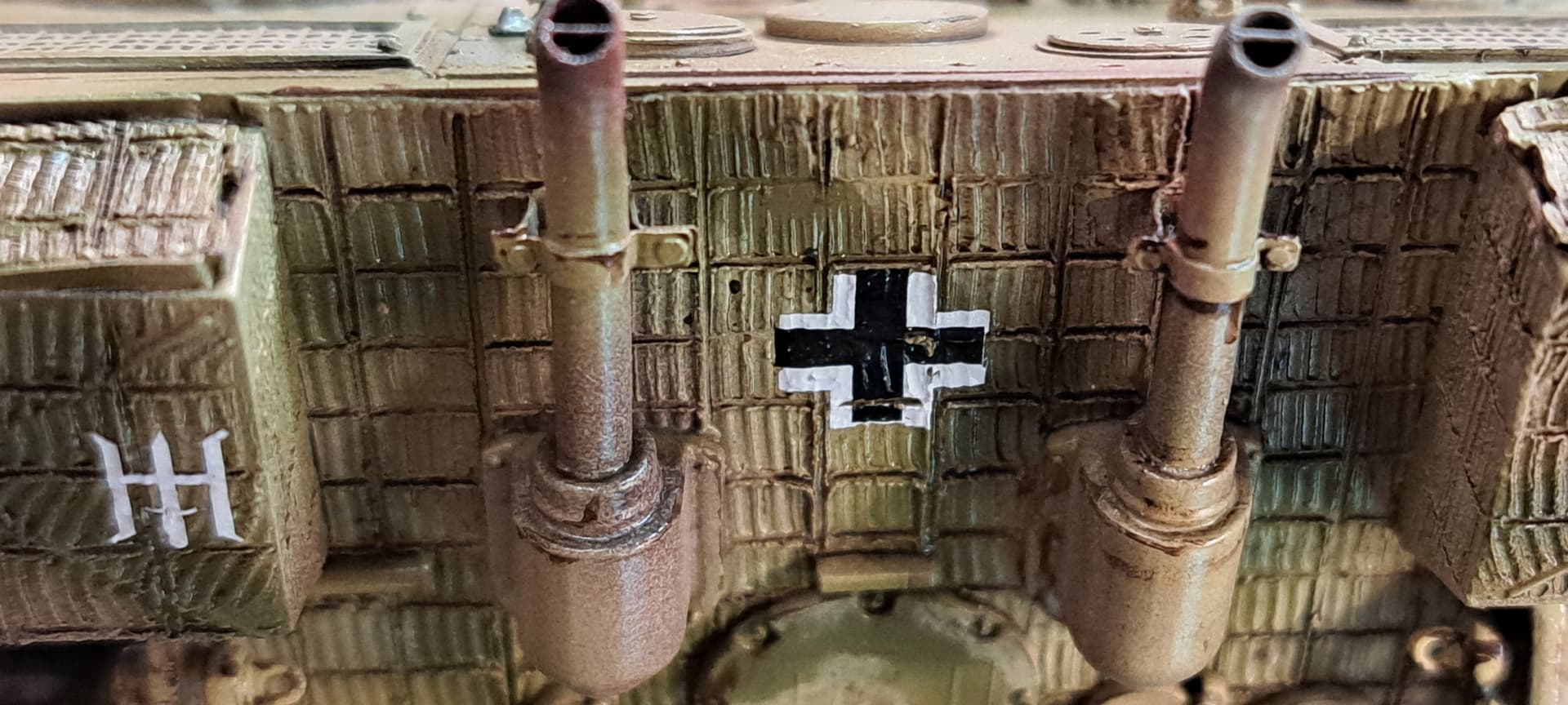

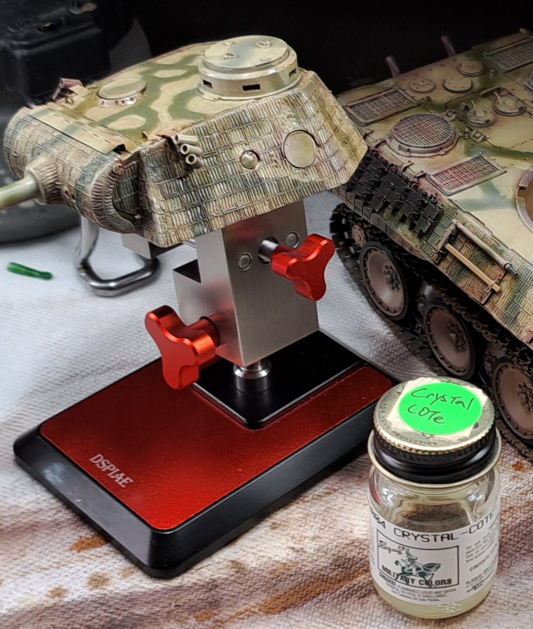

Gloss coat day! Building a base for decaling Zimmerit is always fun!
Two thin coats of Floquil Crystal Cote w/MCLT applied with Paasche VL and tomorrow I’ll decide two more are needed.
Slight color shift after gloss but not excessive.
Not jazzed about using Floquil Crystal Cote again, I’ve tried to wean away and use more modern products due to dwindling supply. However, decaling this Cavalier Zimmerit will be more challenging for me than Pz IV J with paint thin Zimmerit. The Cavalier is great but it rougher in texture.
The Floquil Crystal Cote, Micro-Set, Micro-Sol approach with good quality decal film should yeild decals on Zimmerit results similar to the ones from ~30 years ago below unless I screw this up.

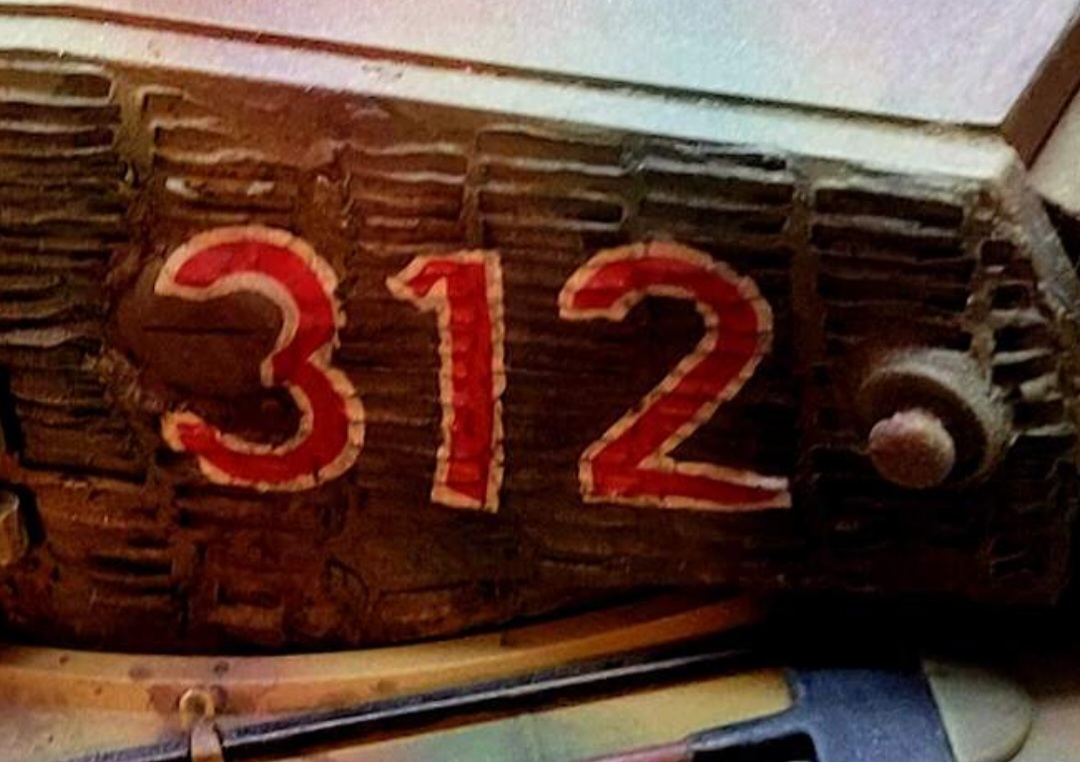

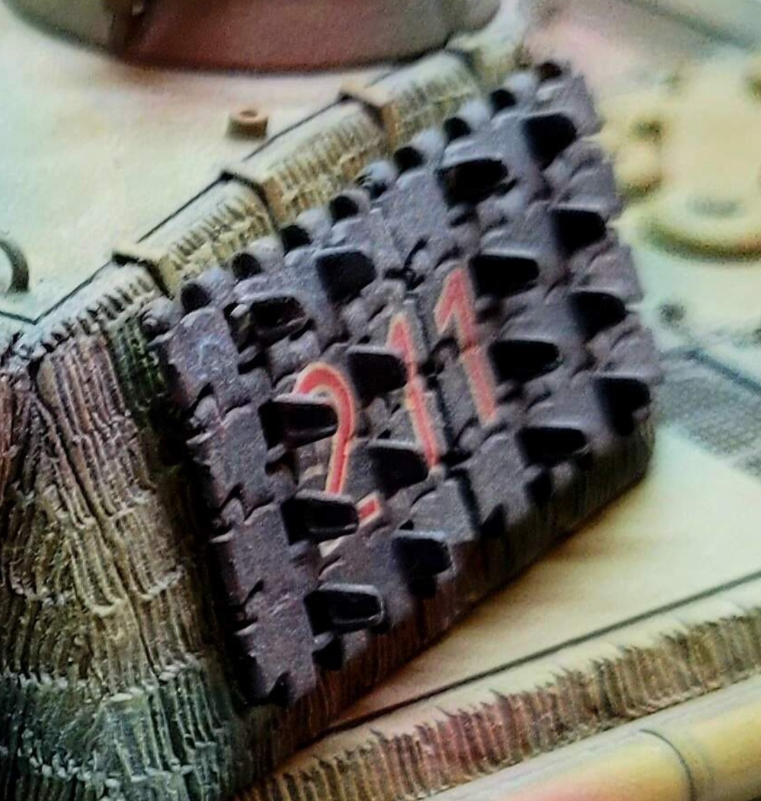

Now the challenge is what markings. I haven’t really thought about that. Gross Deutschland is a logical choice but I’ve already done a GD Panther D this year. I don’t like Gross Deutschland these days after learning how they started committing warcrimes almost immediately in WW2.
The other canidate is 5th SS Panzer Division Wiking as I believethey also used Panther D’s. Haven’t done a Wiking vehicle since ~1993 IIRC.
Probably have to hit the references again and see if a suitable alternative comes up.
Edit - No shake, just bake after out gassing for two hours, into the dehydrator, 10 hours, 104 degrees.
Edit - after checking books and decal sheets etc, I’ve decided to do the Italeri Panther D as my interpretation of 9th SS Panzer Division Hohenstaufen’s Panther D “219”. There’s a fair amout of artistic license in that choice but 219 was kicking Zimmerit with 16 bolt wheels except for one per sources.

Battle of the Decals…began today…
