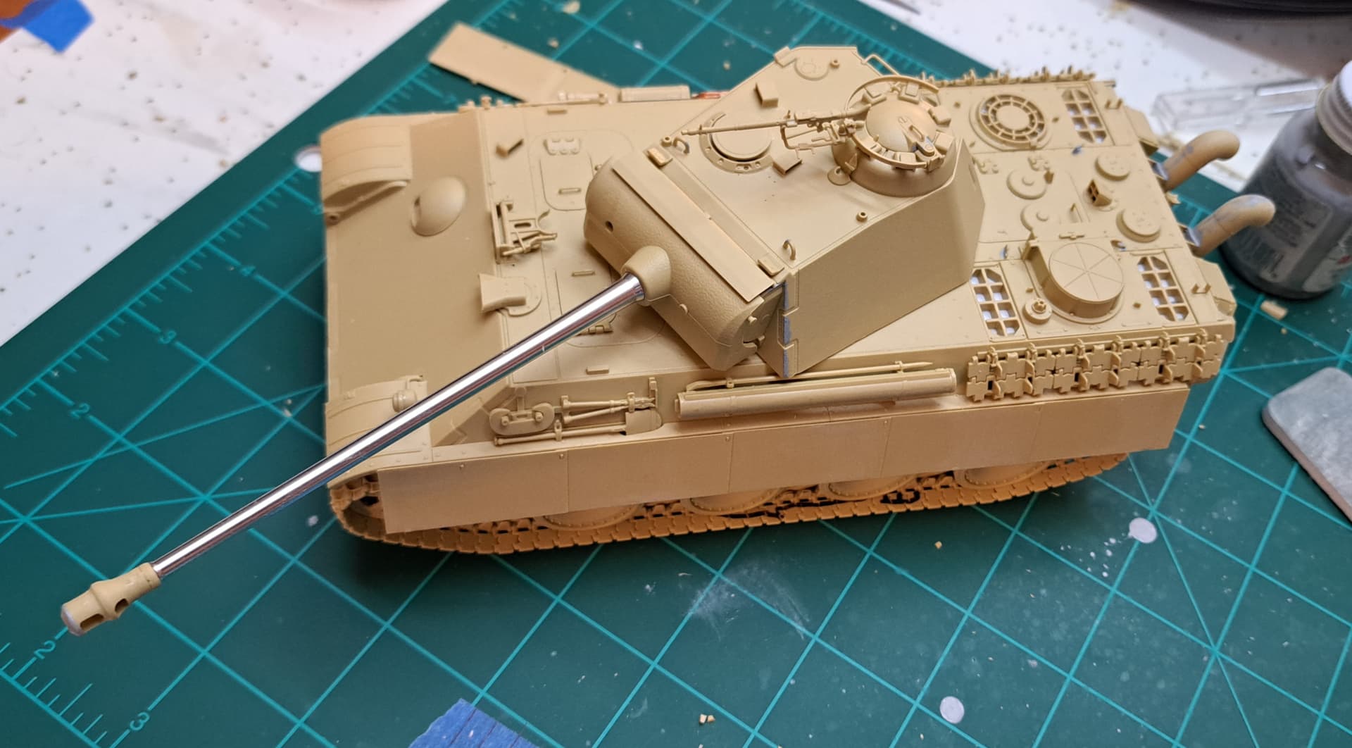

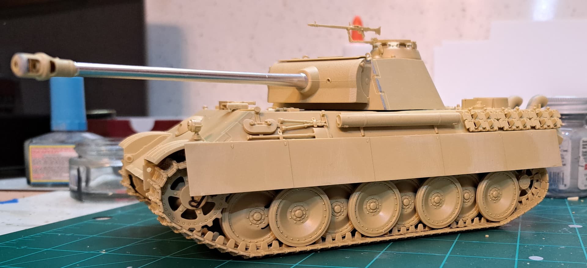

Matt, thank you check this out, 12 hours 47 minutes…it took almost 15 hours to build a set of Model-Kasten working Tiger 1 tracks!
Builders that have youth on their side ie no glasses and optivisors to see etc will be able to slam this kit out to the same standards in ~ half the time, I’d think.

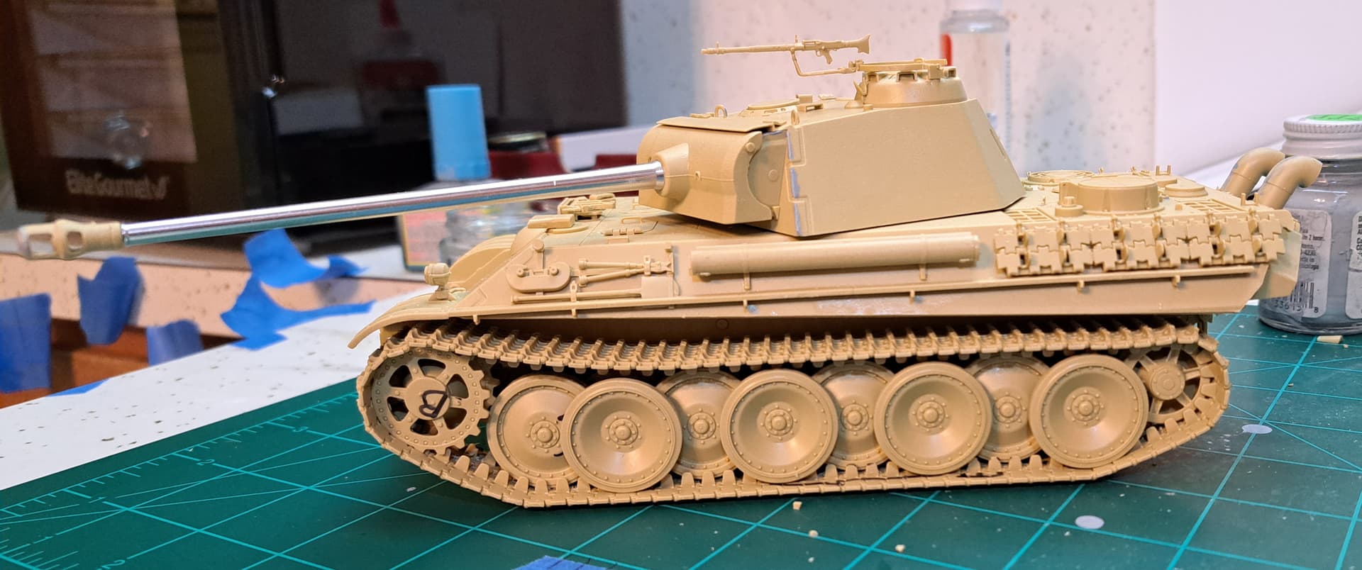

Tracks, wheels, skirts etc are loose. Still needs brass MG’s & antenna. PE screens aren’t on yet etc. I need a good day outside to paint.
Wade’s World Review
Das ā€œTakomā€ Werks SuperBlitz Late Panther G, DW35041
5 Price ~$24.99 via Pre-order at Andy’s HHQ, incredible :astonished: :open_mouth: :hushed: price
4 Instructions - The instructions are excellent, however I believe all of the paint schemes are suspect and accuracy should be verified. Basically the kit is a MHN production tank and all of the artwork depicted is paint and camo patterns for Damiler Benz or some other manufacturers. I don’t have the appropriate references with me on the road to verify. Folks interested in such hair splitting should enjoy this missinglynx: takom-s-new-super-blitz-is-a-panther-g-late discussion.
I also feel that building the upper hull as shown in the instructions then fitting to the lower hull adds unnecessary risk to breaking detail parts. I skipped around in the instructions far more than typical due to that. Likewise with the the turret assembly.
5 Molding Quality - B tree has a little fuzz on some parts. It’s too fine to call flash.
5 Plastic Quality - The soft plastic is excellent and easy to work with.
5 Parts Clean Up - No sinkmarks or short shots. Some punch marks to clean up etc. Lot of attachment points to remove, fair amount of mold seams. However, it’s all very easy clean up as the plastic is soft, sand or scrapes well with the back of a hobby blade.
4 Ease of Build - goes together without problems but care and attention to details in instructions are important
5 Accuracy - How hair splitting do we want to get? I don’t like the bolts on the wheels they look like rivets to me. I think the color schemes have an inaccuracy. Yet the kit hits the majority of specific details for a late panther. The Missing Lynx thread addresses most specific accuracy concerns for which weeks of 1945 production at MHN the kit best matches etc.
4 Fit - The fit is outstanding. However, I did have to hold parts in place with tape to keep good alignment until cement set. I almost never have to do this so this kit gets a 4 despite everything fitting near perfect.
4 Doesn’t Require Aftermarket - the kit needs an antenna, the MG’s aren’t slide molded, so Aber MG barrels are a nice addition likewise Aber brass antenna.
5 Details built Out of the Box - this kit is a Natural Born Killer for the out of the box category at IPMS/USA style model contest’s.
There’s two sets of mufflers and mantlets etc in the box so a hard core contest modeler’s could build two different looking builds quickly. One for OOTB and one for Axis.
** 46 points out of 50 **
46/50
Highly Recommended Kit. I found the model a joy to build almost on par with the Ryefield Model’s KV-1 1942 which is the most enjoyable model kit I’ve ever assembled.

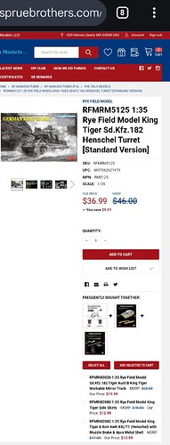

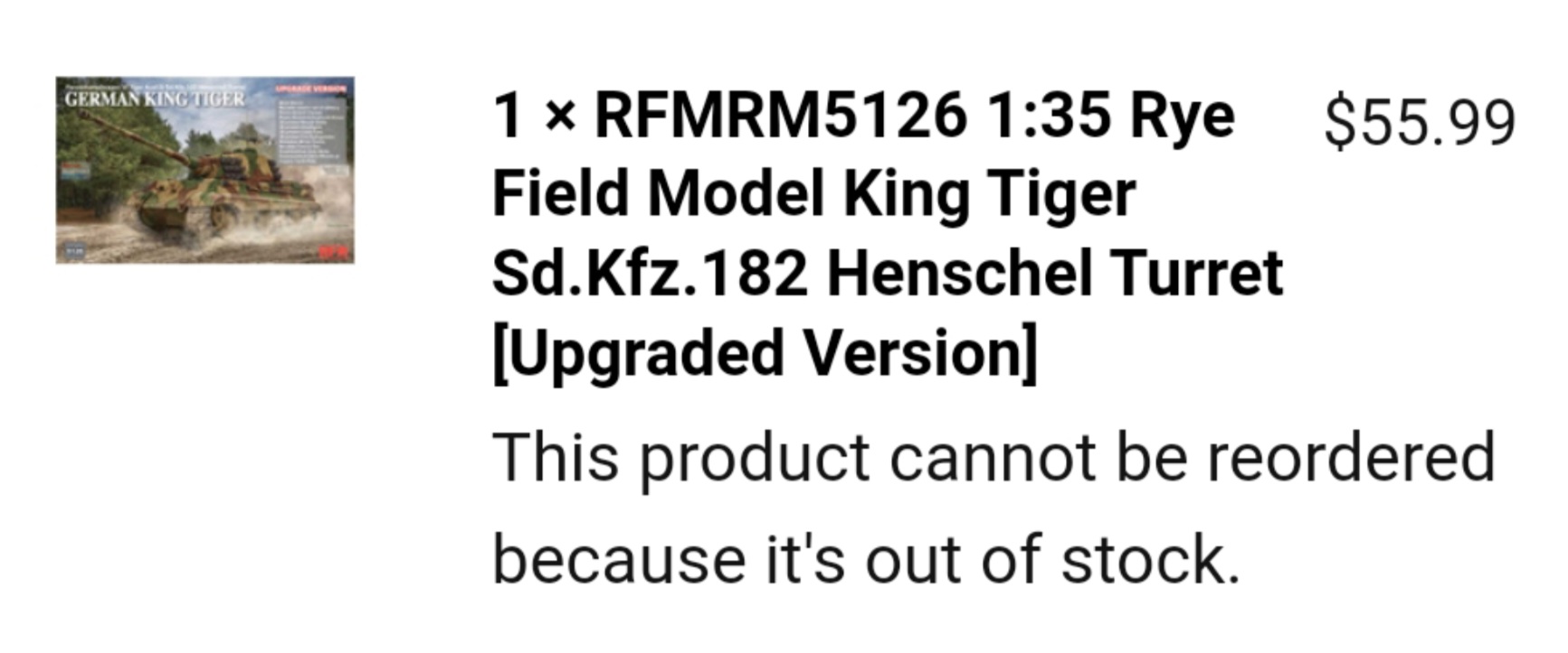

There’s two versions standard and upgraded. The standard has link and length tracks and the upgrade individual link plus other options. The Upgrade kit has mirrored track links which technically aren’t correct as left links were used on both sides.

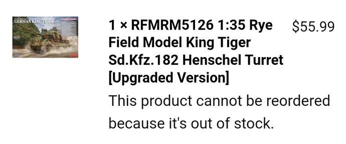

The upgrade kit is out of stock at Spruebrothers.com, Andyshhq.com & Squdron Hobby from what I can see but available via ebay etc.
The standard kit is available at Spruebrothers: rfmrm5125-rye-field-king-tiger-sd-kfz-182-standard-version
Randy, if finding an upgrade version proves sketchy, let me know. I’ll drop my copy in the mail to you when back home. You saved my 1970 Tamiya Tiger 1 build with the Model-Kasten parts and I’m happy to return a good deed.

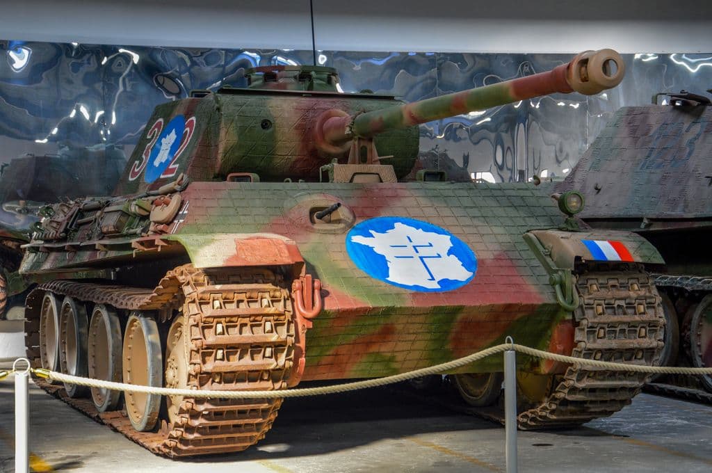

Now, I am debating to build it like one of the two the Panther G on display at the Musee Du Blindes in Saumur.
Either the French Captured Panther…

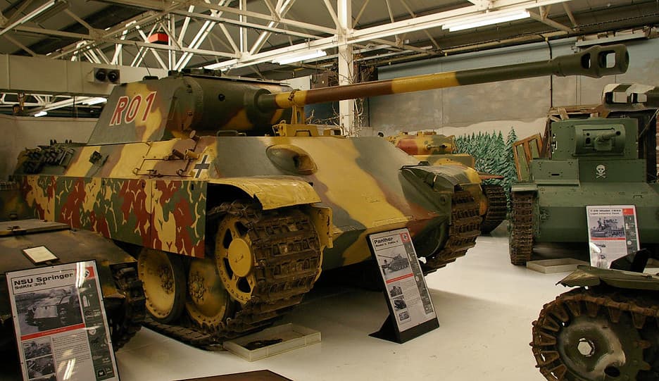

Or this example at Bovington with the two separate camo patterns.
