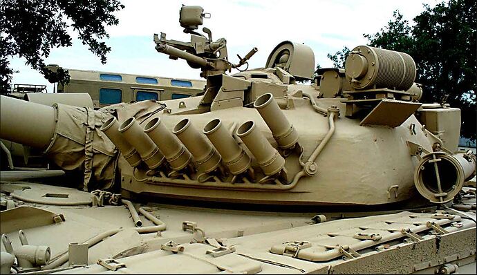

Does anyone offer the turret add-ons specific to Iraqi T-72 M/M1 tanks in 1990-91? Specifically, the protective housing for the commander’s searchlight, and the “Dazzler” system mounted on the left upper turret side to interfere with missile guidance. Haven’t found any resin items, but I was wondering if anybody had created them as 3D printed items?
Here’s a view of the cylinder-shaped Dazzler, on the right (for those who wonder what it looks )

Thanks, everybody. your info is very helpful, and those photos are among the best I’ve seen! I was aware of the Airwaves set, and the searchlight parts it includes, though it would mean ordering it from Hannants in the UK. It’s basic, but a start, at least. The Dazzler is the only part that would be difficult to scratch build, due to the large number of perfectly spaced, circular grooves on the surface. Blast’s update offers the Dazzler and its mount, but not the searchlight housing. However, I don’t really need a complete turret, as I’ll be using the Amusing Hobby kit (this could start to get expensive). Maybe I’ll rummage around my Desert Storm books and see if any of the Iraqi tanks were fielded without the Dazzler.
If i am not mistaken, Tamiya provides dazzler in their T72 kit?

In some period pics, the Dazzler itself is missing but not the support :
in other examples, it looks like it wasn’t fitted at all…
