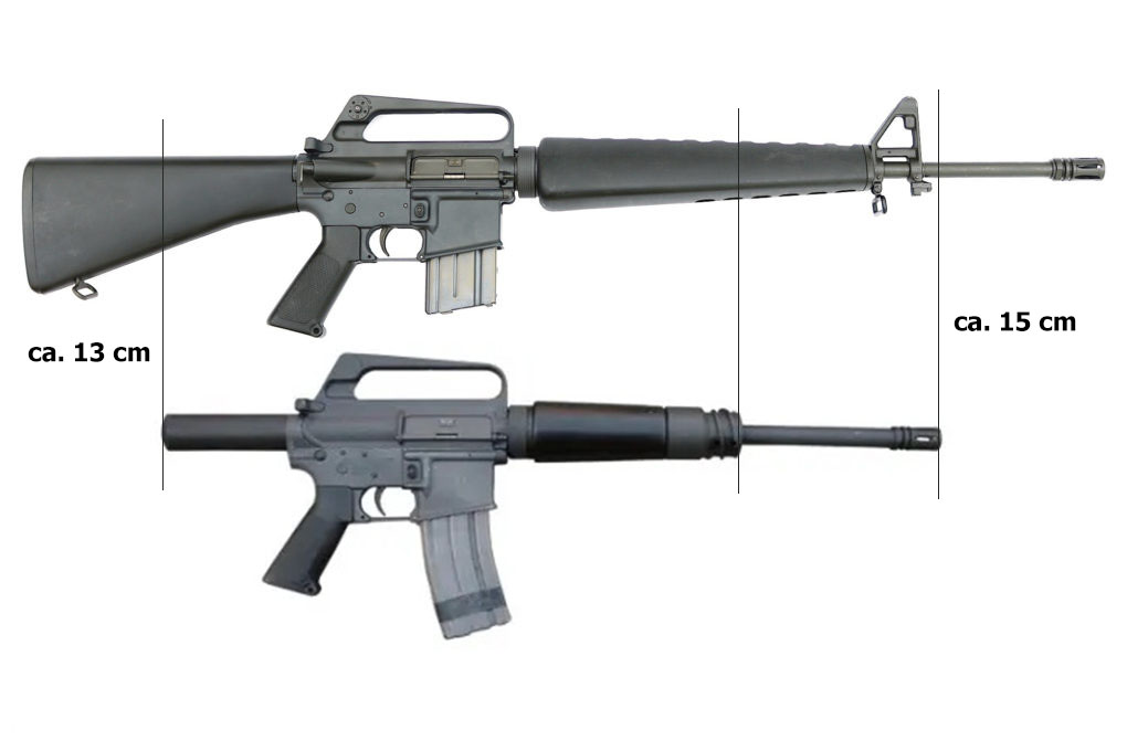

My thoughts were more that a firing port for an M16 would be likely to mount the weapon with more of it outboard than that. Clamping around the middle or even the rear end of the handguard somewhere instead of at the front, kind of thing. That would still leave the buttstock much longer than on the M231, true, but only by about 13 cm while the muzzle would stick out 15 cm or so more:

Yeah, that leads to those problematic technical details that often derail good ideas.
- The hole would need to clear the sight block and sling loop, which is much larger than the handguard
- The rifle is almost always fitted with a sling, so how would that be handled?
- The handguard wasnāt really designed to be clamped on. It might crush.
- The more of the weapon that sticks outside the port the more of it gets contaminated by NBC, which will be brought into the vehicle when dismounting.
- The more of the weapon that sticks out the more likely it will be damaged or knock off zero by brush and obstructions.
- The hand guard is open to the environment, so if the NBC boundary is at the rear of the handguard there is essentially a free path between the clean and the dirty sides. The overpressure system should keep the air flowing out, but yāknow how things work.
