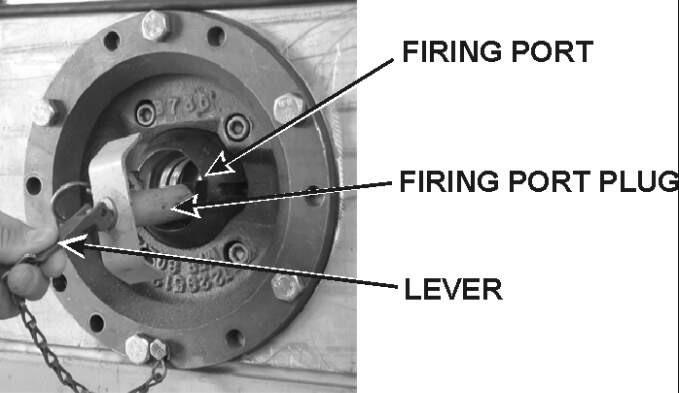

Is the M231 Port Firing Weapon still in use?
Just watched a video on M231. With the firing port blacket over on M2 A2/A3 Bradley, I wonder
if the weapon is still in use, e.g. with the rear ramp firing ports.

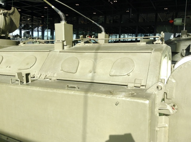

No, haven’t been in a long time. They were pretty useless. The ports in the ramp are there, but in the A2’s at least it was used to toss butts out when the ramp was up.
At 1200 rds/min, it would only be a waste of ammo. and I guess with the vision port off the line-of-sight, it would be hard to aim. Spray-and-pray?
It was to be loaded with 100% tracer rounds and aimed through the periscope, more or less how the ball mounted and fixed hull MGs were used up until the M47.
KL
I love that the United States Army had to field a special weapon just to fire out of a pistol port, that they manufactured over 100,000 of them, that it did not really work, that no one seriously trained on the thing, and that it was probably never used. That is the good idea fairy at her very best.
I am kinda kidding. My knowledge of this weapon amounts to three articles I just read. They were definitely not written by subject matter experts. It does bring up something I wondered about for a long time. Were pistol loopholes and pistol ports effective? I know American M4 mediums had them, then did not have them, then had them again because soldiers complained. If I recall correctly, German troops also complained when pistol ports disappeared. It must be very difficult to aim a shot out of the small ones.
The M231 design in the original M2 Bradley was in response to the BMP-1 having port guns. The port guns on the BMP are just as ineffective and no longer used either.
At the time (early '60s), the BMP was a game changer and a totally new idea; an Infantry Combat Vehicle that a squad could fight from within and have some protection from small arms. It drove the development of the Bradley to become what it was. The port guns were a good idea that didn’t really pan out.

It was more about protecting the troops inside and them not having to exit the vehicle to fight, esp. in an NBC environment. A future war with the Soviet Union was seen as one where chemical weapons would be widely used. It was reasoned that the troops would be more effective if they were protected within than if they were on the battlefield wearing MOPP protective gear.
The purpose was to fire from inside a vehicle in a nuclear contaminated battle field. Edit-I should say NBC battlefield.
Same firing ports used in EM113A2.
I’ve never understood why they felt the need for a special weapon for this. Why not make a port that a regular M16 would fit into/through?

That was the original idea, as on the BMP. The M16A1 was quite a bit longer than an AKMS though, and with the front sight well back from the muzzle, so it couldn’t engage with the port in the same way. To get past that they started changing things . . . and after a long process they ended up with M231 that stayed with the vehicle instead of going with the soldier..
KL
What I guess I should have said is: “I’ve never understood why, during development of the M231, nobody came to the conclusion that adapting the firing ports to the M16 would be easier and cheaper” :slight_smile: I mean, it’s not like the M231 is just an M16 with a new fore-end and a sliding wire buttstock — pretty much all of the internals are different too, which seems like an odd path to find yourself going down if you take a step back and wonder why you’re doing all of this again.

I don’t think the M16A1 was ever going to work as a FPW because it was just too long to install and operate inside of an IFV, especially out both sides at once. I think the original idea was to use M3A1 SMGs. I would not doubt that someone realized that there weren’t enough to go around so production would need to be restarted, and maybe the caliber changed to 9x19mm, and then maybe just use a commercial 9mm SMG, then maybe “Why are we introducing a new weapon when the soldiers are already armed?”, and so on.
