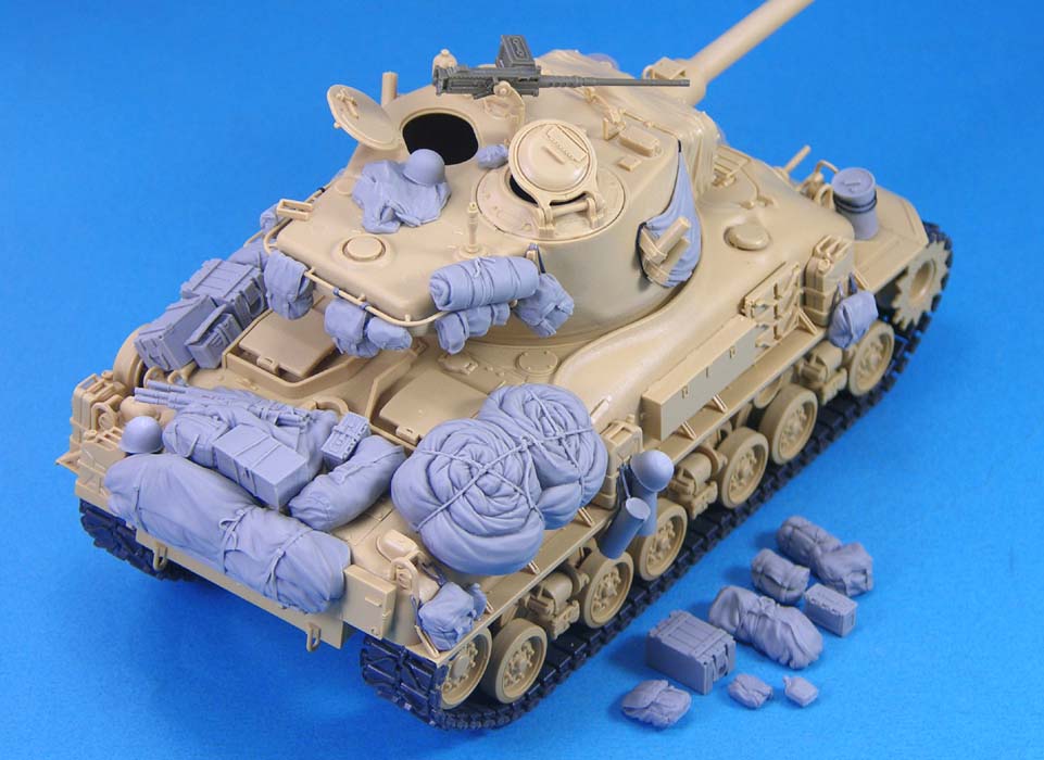

Here’s the Legend set:

The Legend set looks great, may have to get it. I believe the initial Dragon issue had a problem with the muzzle brake and gun being too short, or was it the second release that had the barrel problem? Can’t remember. Supposedly the tracks on the later issue were much nicer as well.
